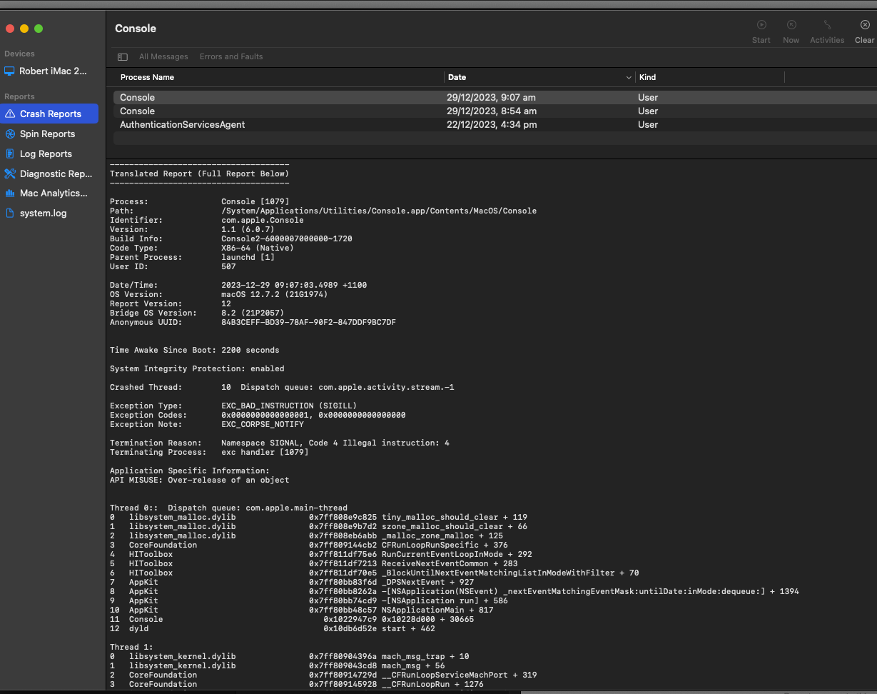

Attached is a console log from the Safari browser, PayPalError.txt
I tried the issue with both Safari and Chrome and got the same result of "Please Select a payment method"
I tried also the Mac Console. The big thing was that the Mac OS console crashed on both occasions as soon as I hit the Finish button.
The Exception Type was EXC_BAD_INSTRUCTION (SIGILL) see attached
