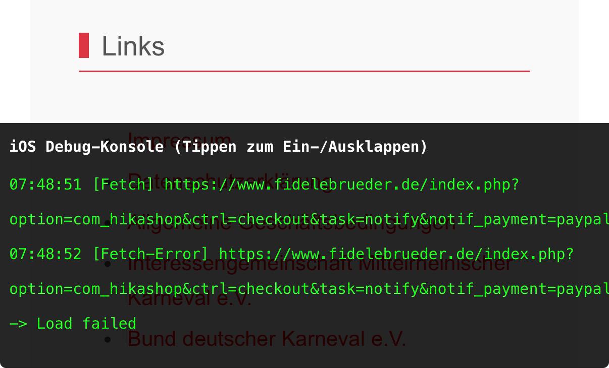

During debugging on iOS (Safari and Chrome), I monitored all outgoing JavaScript fetch() calls.
Right after returning from the PayPal popup, the PayPal Checkout plugin attempts to call the following notify URL:
https://www.fidelebrueder.de/index.php?option=com_hikashop&ctrl=checkout&task=notify&notif_payment=paypalcheckout&order_id=236&tmpl=component&lang=de&order_token=99HHF2iq&Itemid=101&createorder=1[/code
On iPhone (iOS) the browser reports:
[code]Fetch-Error -> Load failed
Important update:
The problem now appears only on iOS/Chrome.
Safari on iOS no longer shows the error.
This means the request is not blocked by the server and not returning an HTTP error —
iOS simply refuses to load the URL at all (network-level failure).
On desktop browsers, the same URL loads correctly and returns:
{"errorTitle":"An error has occurred","errorMessage":"","error":false,"id":"7G661998VS570111E"}
So:
  • Desktop → notify URL loads
  • iOS/Chrome → notify URL cannot be loaded via fetch (“Load failed”)
  • iOS/Safari → now working
  • This happens before HikaShop can process anything
Because the PayPal Checkout plugin relies on this fetch request to finalize the order, the whole payment flow stops on iOS/Chrome.

  • Posts: 18
9 months 3 weeks ago #369421
For anyone who might encounter similar problems with PayPal Checkout or other AJAX-based payment plugins on iOS devices, I would like to share a small debugging script that helped me identify what was happening in my case.
Since iOS Safari/Chrome does not offer a visible browser console, I added a JavaScript overlay that logs:
  • all JavaScript errors
  • unhandled promise rejections
  • all fetch() calls (URL + errors)
  • XHR requests (including HTTP errors)
  • navigation events (optional)
This made it possible to confirm that a specific fetch request triggered by the PayPal Checkout plugin was failing only on iPhone, while working normally on desktop.
Here is the script (can be added inside the Astroid “Custom JavaScript” field in Joomla):

What this helped me discover
On iOS, the PayPal Checkout plugin attempted a fetch() call to:
...?task=notify&notif_payment=paypalcheckout&order_id=...
This request failed with:
On desktop, the same URL loaded normally and returned JSON.
This confirmed that the issue was iOS-specific and happened before HikaShop processed anything.
Maybe this script can help others facing similar mobile-only issues in Joomla/HikaShop.

  1. Testing GET instead of POST
    As suggested, I modified
    plugins/hikashoppayment/paypalcheckout/paypalcheckout_end.php
    and replaced all instances of
    {method: "POST"}
    with
    {method: "GET"}.
    Unfortunately this did not change the behavior. On iOS/Chrome, the fetch request still fails instantly with “The payment request was refused by PayPal”, and the request never reaches the server.

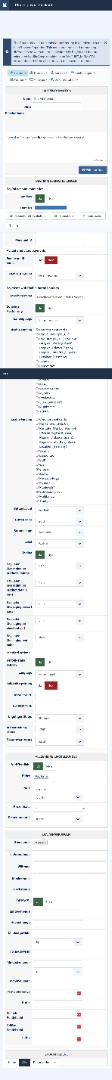

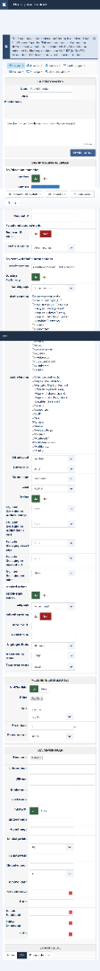

  2. Debug mode of the payment method
    You recommended enabling the debug mode of the payment method and checking the payment log file in the HikaShop configuration.
    However, in my installation (HikaShop 6.1.1), I cannot find a “Debug mode” option:
    • not inside the PayPal Checkout payment method
    • and not in the HikaShop System → Configuration panel
    There is also no “Logs” tab available.
    Could you please clarify where the debug mode is located in HikaShop 6.x?

In the payment method's setting page, you have a "debug" setting near the end of the specific settings area:
www.hikashop.com/support/documentation/4...form.html#additional
In the HikaShop configuration page, you have the "payment log file" setting where you can look at the log:
www.hikashop.com/support/documentation/5...nfig.html#main_files
You said "the request never reaches the server.". How do you know this is the case ? Did you check the access log of the web server for that ?
