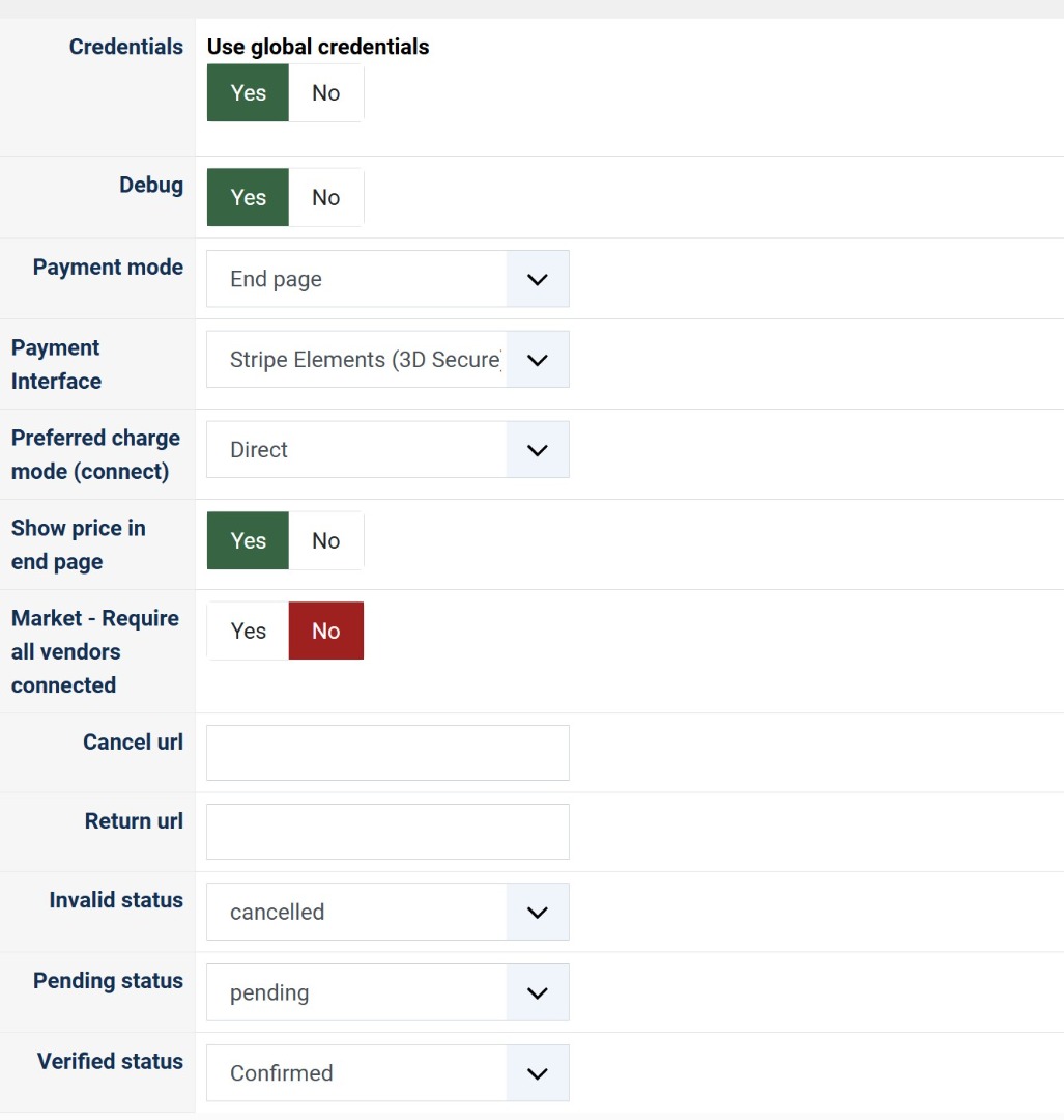

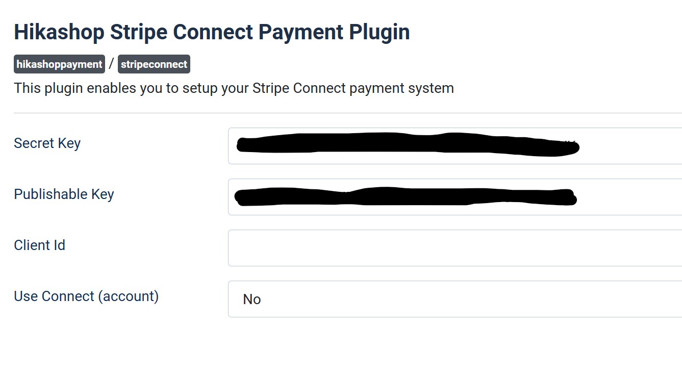

4 months 1 day ago #371792
Please provide more details about your Stripe Connect configuration (you can hide the credentials).
In "End" mode, it is not possible for Stripe Connect to display a "thank you for your purchase" automatically.
The view contains that HTML code but it's with a "display: none" style so that block is only displayed when the Stripe JS confirm the order processing. It means that the customer need to fill the payment form to activate that script.
The only way to go directly to the "thank you" page is with the "checkout" mode.
  • Posts: 431
  • Thank you received: 22
4 months 1 day ago #371797

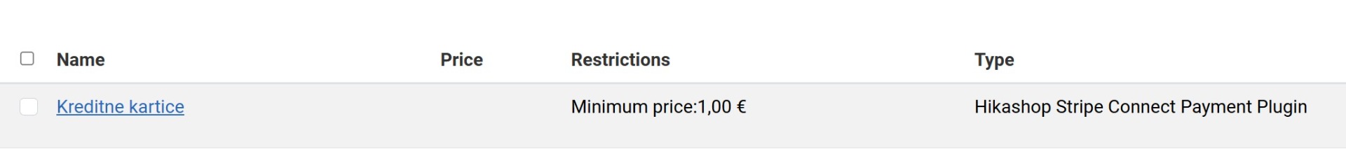

3 months 4 weeks ago #371838
Thank you for the screenshots and sorry for the delay.
You wrote :
Among the orders, the status of such an order is Created.
So, we are sure that the customer finished the checkout workflow since the order is created in your backend.
Can you please confirm that the payment method is stripe connect?
What do you have in the order history at the bottom of the order details in your backend?

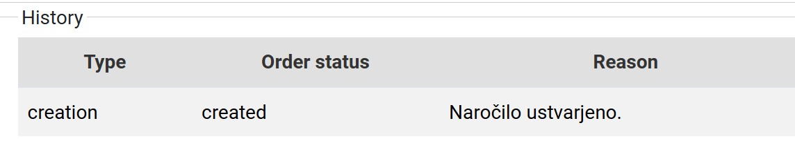

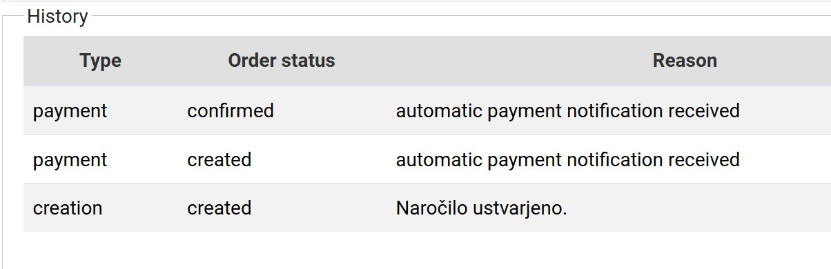

Yes, as mentioned, the customer gets to the end but doesn't even offer him the option to enter his card details. It simply shows him the thank you page and that the order is being processed. The problem occurs in some random key that we can't decipher.
Yes, it's Stripe connect 1.2.5 (obsydev).
I'm attaching a screenshot of the history in case of a successful purchase and in case of a fail.
3 months 3 weeks ago #371874
Thank you for the screenshots but unfortunately, just a part of the order history does not allow me to understand the situation.
Like I wrote, I also need the payment method attached to the order.
By design, it should not be possible for the plugin to just let the order be created ; so I need to understand the source of the issue, which could be related to restrictions, plugins, etc.

For these orders, the payment method Stripe credit card is selected as mentioned at the beginning.
I don't know how else I could look or confirm. The payment method of the order is visible in the order list, in emails, invoices ...
If you need any other information, please define exactly where I should look.
