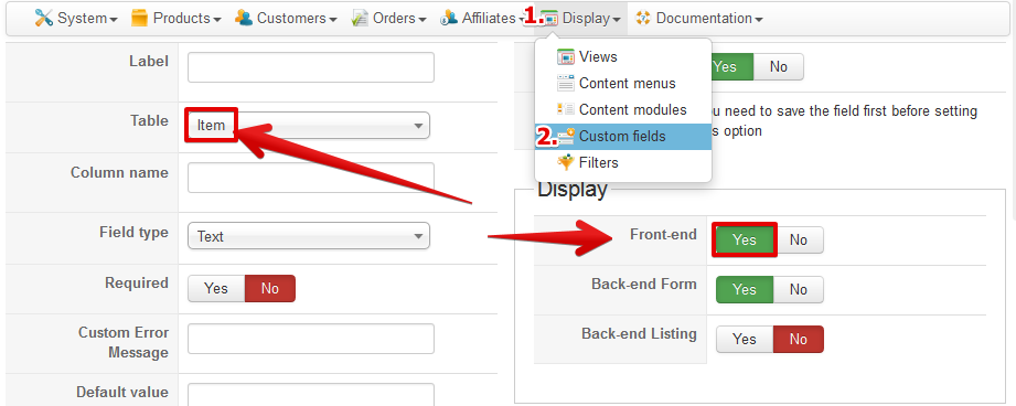

12 years 10 months ago #128165
Do you have enabled the option "Front-end" ?

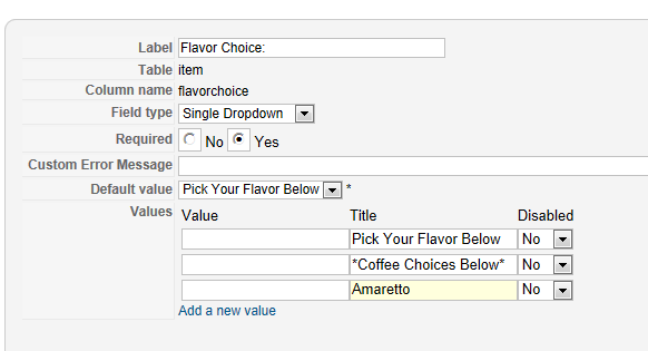

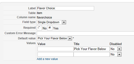

Thank you now it's show but having an issue with field type "signle dropdown"
it will only allow me 1 entry
Before editing it.
My Changes:

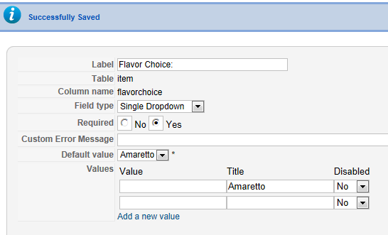

After saving my changes:
As you can see it drops all my changes
I need multiple items in a dropdown
12 years 10 months ago #128182
You should put a "value" (like 1/2/3/....) for your single dropdown values, and then save.
The following user(s) said Thank You: cboyd213
