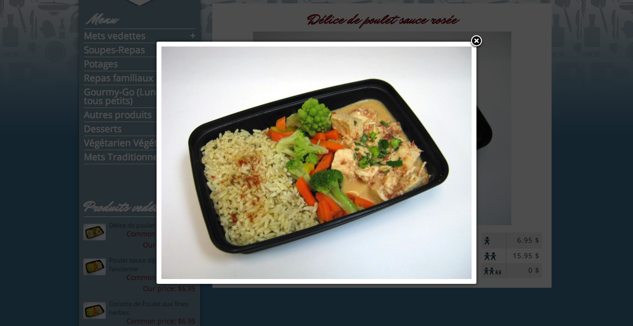

I'd like to know how to make product images not clickable. Right now when in a product, when I click on a product image it opens a boxshadow with a bigger image, as you can see in the attached image. I'd like to remove the possibility to the image to be clickable and open the image in a boxsahdow.
