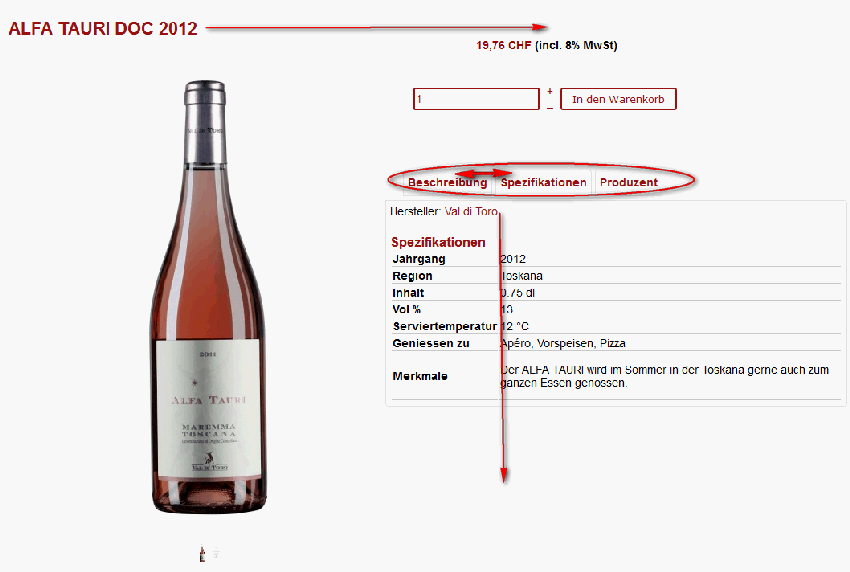

12 years 6 months ago #145571
Hi Mohamed Thelji
The appendix is ​​a screenshot.
1. The tabs should be the right of the image. The title should be centered above.
2. The tab "specifications" on the left. The tab "Description" in the middle. The tab "manufacturer" on the right. While I can move the tabs. However, it always opens the tab "Description" as standard.
3. In the tab "specifications" it has a link Manufacturer: Val di Toro.
The should down outside the tabs. Always visible.
12 years 6 months ago #145703
1. You can set a margin left on the class: hikashop_tabs_ul to move the tabs to the right like:
.hikashop_tabs_ul{ margin-left: 250px !important;}
2. You have to change the value of the following hidden input in the product / show_tabular view:
<input type="hidden" name="selected_tab" id="selected_tab" value="hikashop_show_tabular_description"/>
3. You have to edit the code in the view product / show_tabular to put that part out of the tabs.
