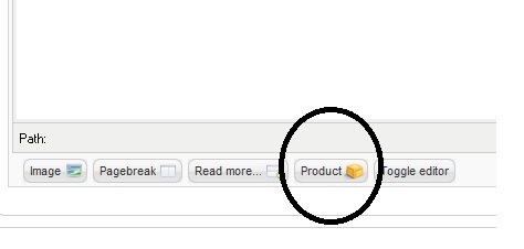

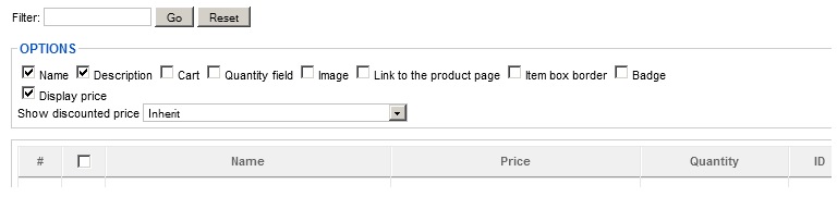

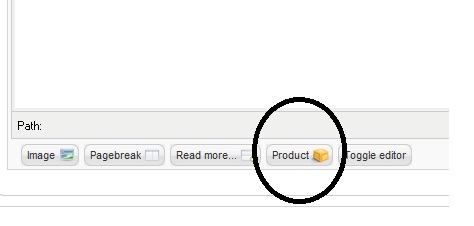

  • Posts: 8
12 years 6 months ago #144700
The column i wanted to display is on the joomla FrontPage. Created under joomla front page manager. it is an article. i cannot set any number of column under article.
under front page manager, i can click "product" and select what product to display on first page (refer below).
thanks.
