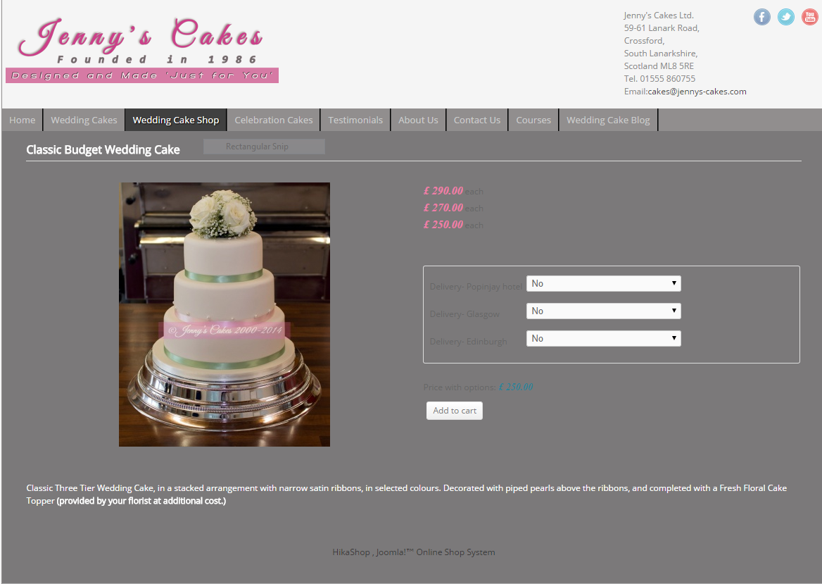

Thanks, am trying to follow your method.
First problem is that the options are listed as shown in attached screenshot- really would like a dropdown list so that only one option can be selected, also if I end up with 20 delivery locations, the list would fill up the screen.
Secondly all the possible priced options are listed on the page, do not want to display this.
Hope this is possible and look forward to your help.

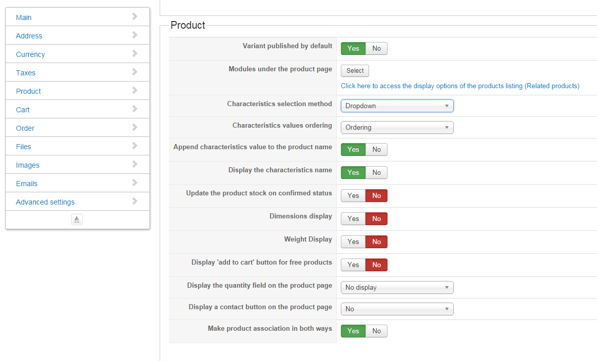

11 years 11 months ago #172896
Would it be possible to have a screenshot of your product configuration (in the HikaShop backend) ?
  • Posts: 30
11 years 11 months ago #173044
thanks, screenshot of product config attached...
11 years 11 months ago #173054
1. In your case I think that you have to use an option with characteristics.
The option product will have all the delivery location, then when adding this option product to the main product, the values will all be displayed in only one dropdown.
2. I don't really understand what you need. Isn't this request similar to the first one ?
