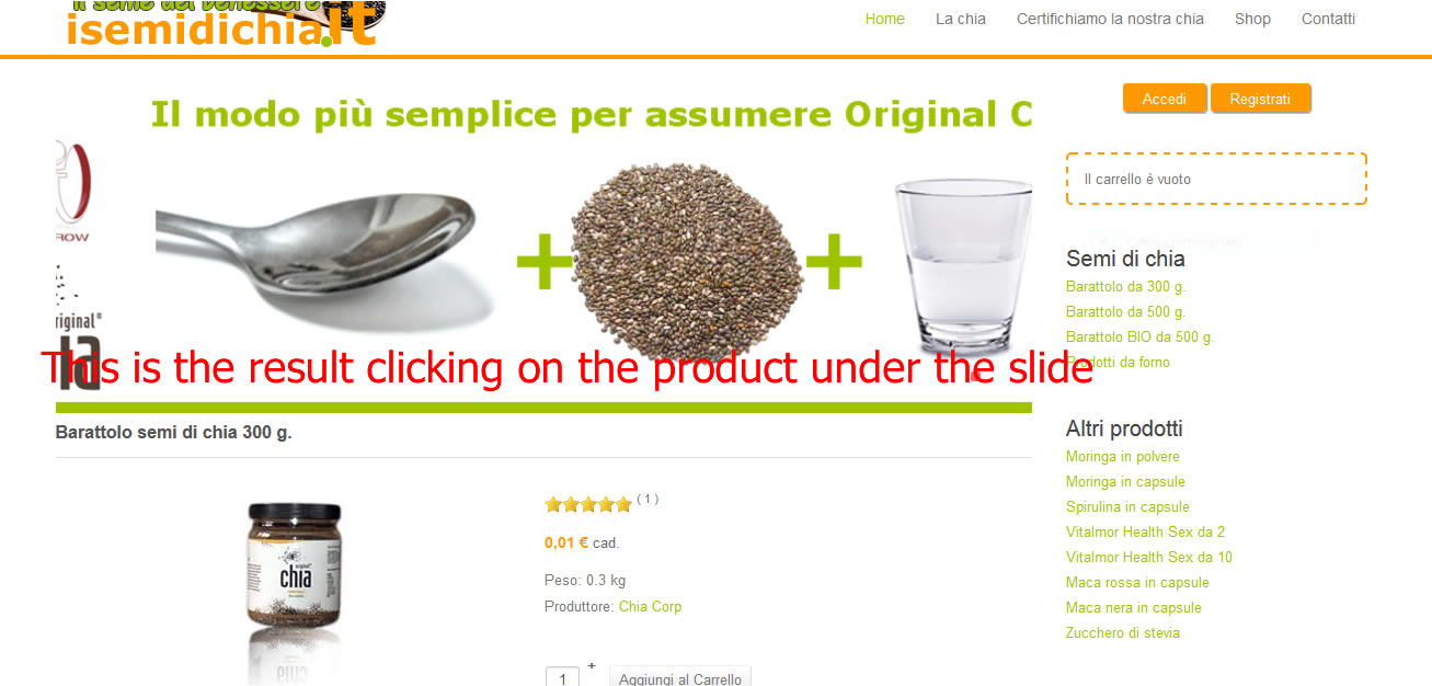

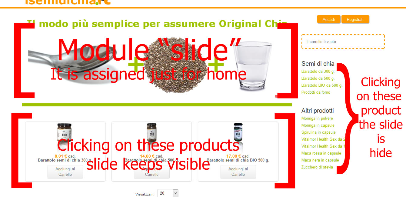

Thanks soo much Nicolas, I try to explain better by the help of some screenshot.
You can see in the first screenshot, I have a slide and under that 3 products. I want that slide is visible just in Home page, infact in property of module I selected the item of main menu "HOME".
Now if I click on products under the slide, example the first one "Barattolo semi di chia 300 g. " with link:
mytest2015.altervista.org/index.php/hika...o-semi-di-chia-300-g
The slide stay visible second screenshot ( NO GOOD)

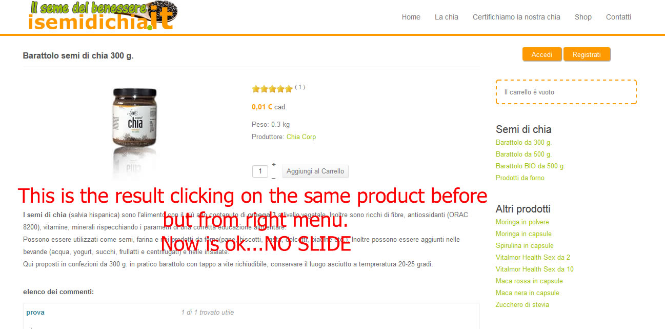

While if I click on the same product from right menu "Barattolo da 300g." with the link:
mytest2015.altervista.org/barattolo-da-300-g.html
The slide is hide, third screenshot (GOOD), no problem with all products on right menu.

10 years 11 months ago #209393
So in the settings of the module displaying the 3 products under the slide you have to select another entry for the "menu" option ;)
This way you can select a menu not having the slide module associated to it, and this will do the job.

10 years 11 months ago #209782
Thank you for the explanations, that's way better.
Enter the URL of the product from the left menu in the "canonical URL" setting of the product when you edit it and make sure that the "force canonical URL" setting is turned on in the HikaShop configuration.
That should fix the issue.
  • Posts: 281
10 years 10 months ago #210014
Thanks Nicolas
Your solution works 100%
