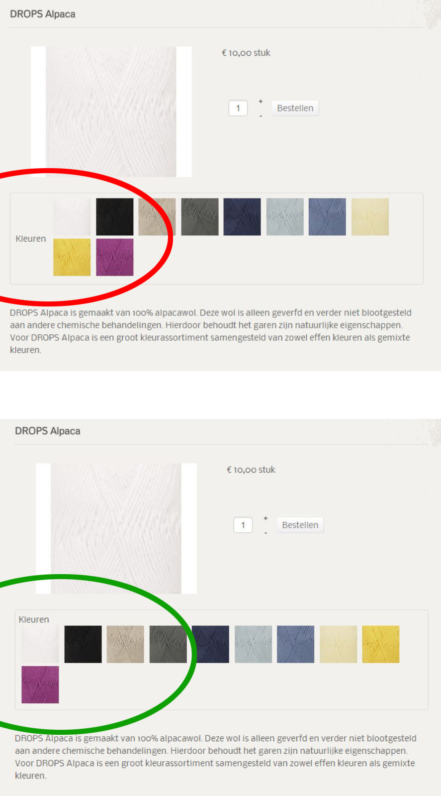

Hi Hikashop,
I have followed the documentation for display by color.
www.hikashop.com/support/documentation/2...isplay-by-color.html
See result:
Part of the message is hidden for the guests. Please log in or register to see it.
And I moved the characteristics images to the top op the description so they have more space because I have more then 60 colors. But I don't know which file I have to edit to make a tr from the td in the table.
Because I like to have the name of the characteristics above the images, so the images have the full width..
See attachment how I like to have the view.
I played a lot with the prodcut view show_block_characteristic but I think it's not the one.
Hope you can give me a hint.

There is no need to change any HTML. You can just add some CSS code on your website to do it:
.hikashop_product_characteristics_table td {
    display: block;

10 years 2 months ago #241922
Thank you very much!!!!
