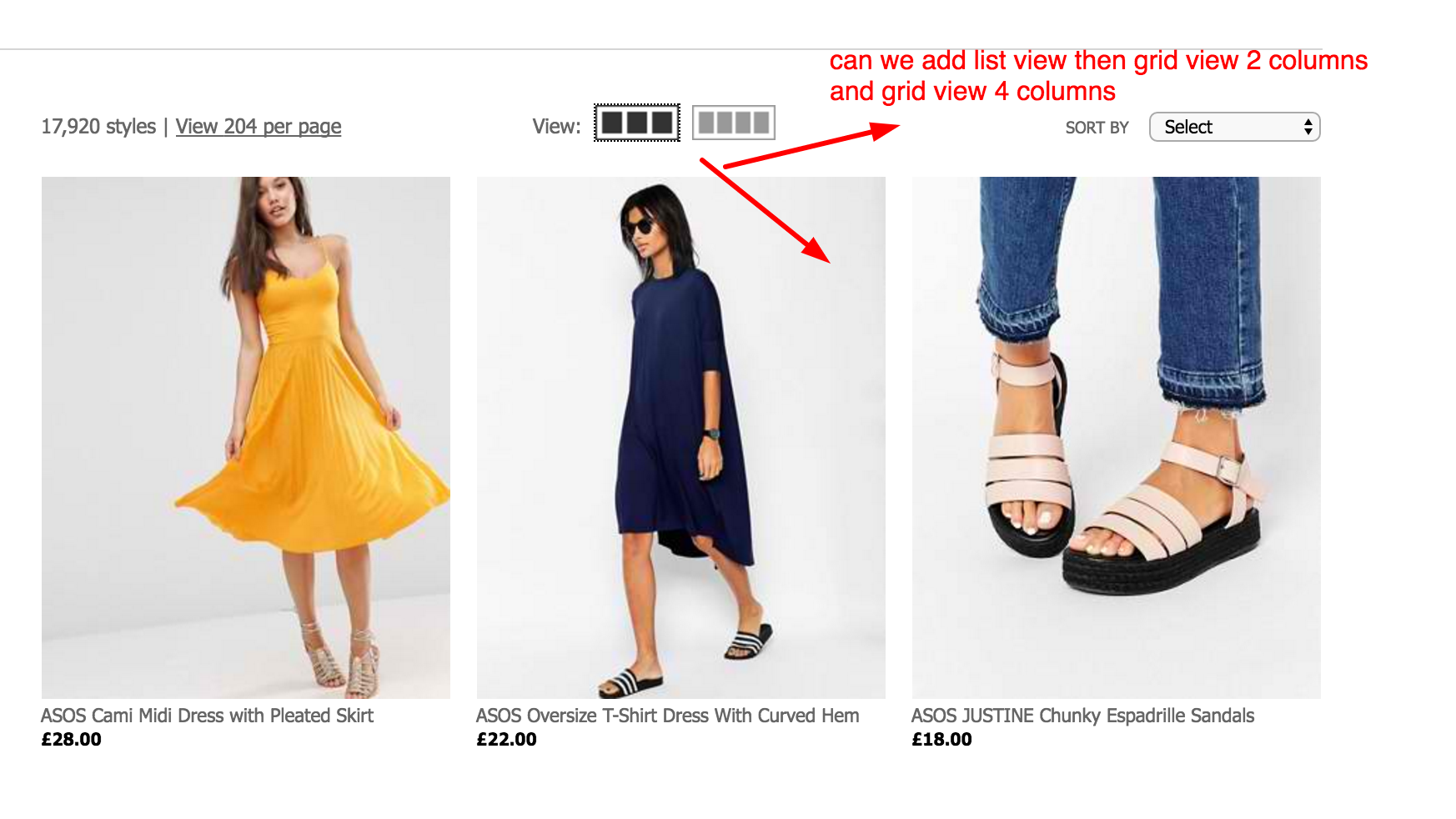

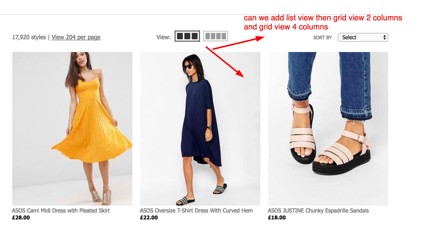

let me explain. As seen on the thread i want to implement list view to grid view 2 columns and grid view 3 columns that can be selected by the user on the front end. I am currently using product list div single column title and description layout. How can i achieve this?
I tried the solution included in the other thread but cant get it to work. Any solutions? The thread i tried to follow is in my initial inquiry.
here is the example i want to achieve

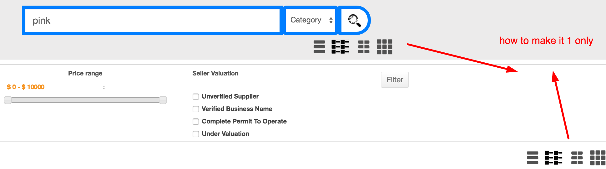

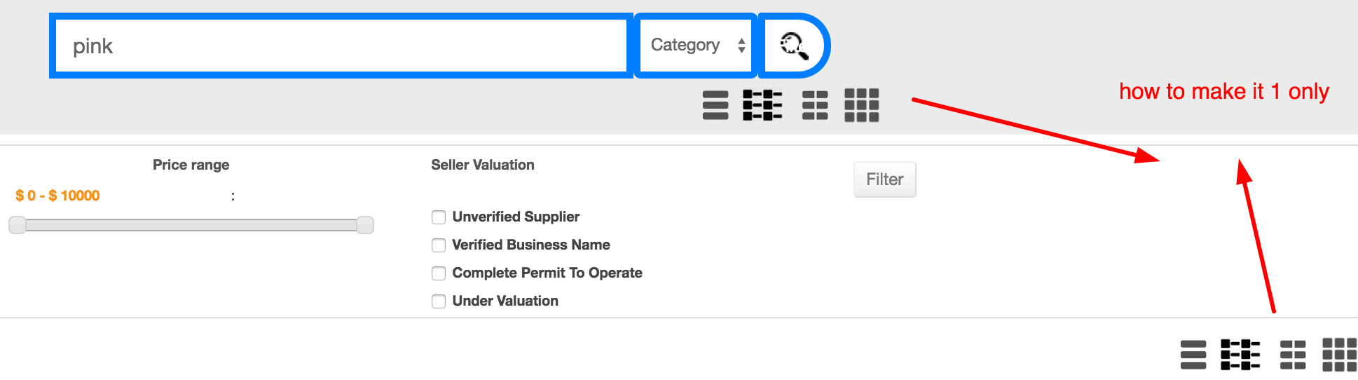

my new problem is that for every instance of the filter, the grid view appears. Example if there are 2 filter modules, there are also 2 grid links.
can i add something so that only one instance appear?
Last edit: 10 years 1 month ago by ronron.
  • Posts: 2143
  • Thank you received: 747
10 years 1 month ago #244133
Hi again,
Obviously, that's due to the customization you made to have these links for different views.
Impossible to provide detailed help because only you know the customization.
But as a hint, it looks as if you should reconsider where to place the code for the links, so it does not appear multiple times on a page, and not multiple times with with filters.
