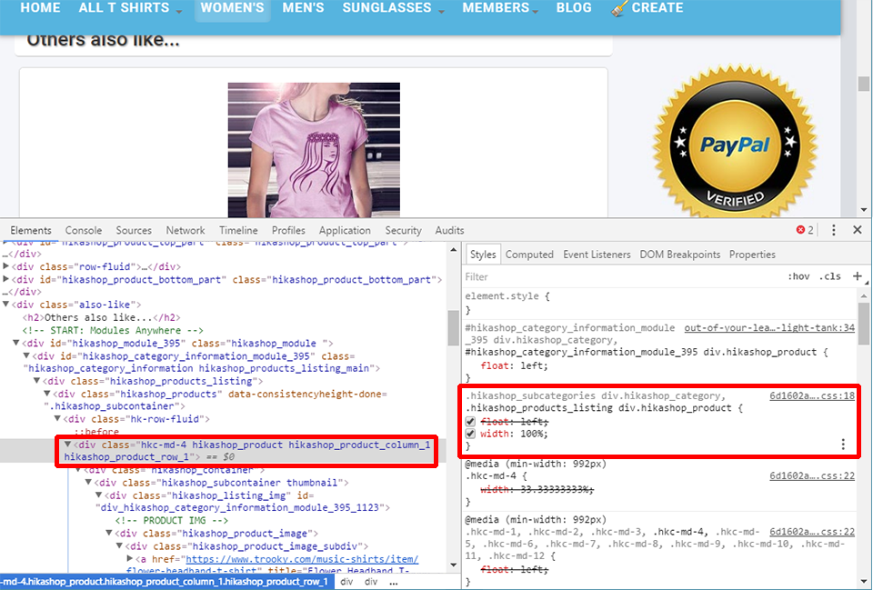

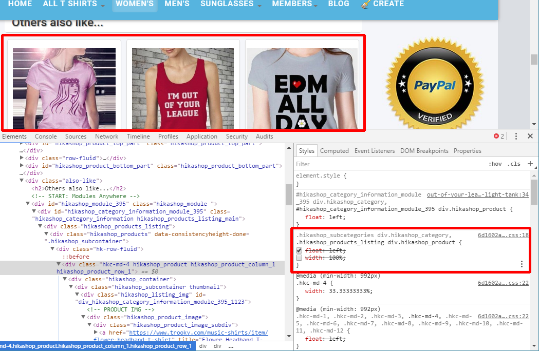

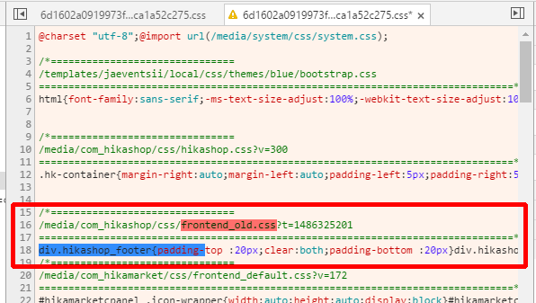

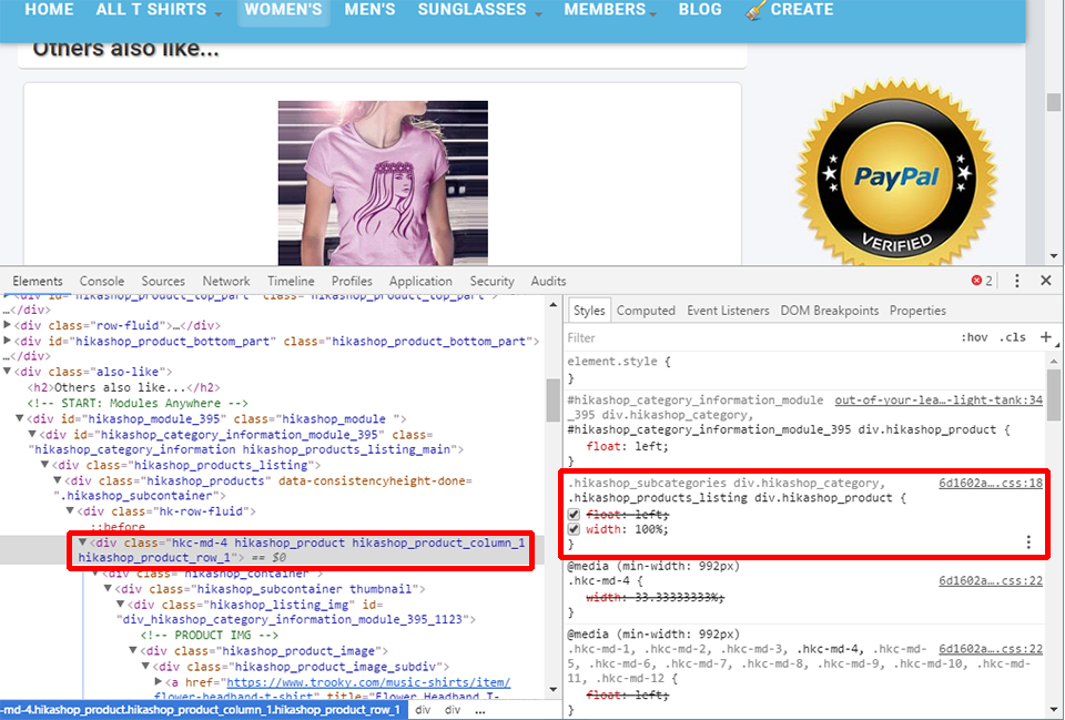

9 years 6 months ago #261680
We are here to help people, not to blame them, I don't see what you means for this point, neither I don't understand the aim of this discussion.
There is a lot of examples where we thanks customer for their feedback that leads to fix HikaShop elements.
Here the aim is to find root issue, and we help customers very often to get it on HikaShop or other components that work with HikaShop.
An E-shop is build with several elements that can leads issues when work together, and of course sometime we can make some mistake, but most often people are happy with our help,
HikaShop rating From JED :
But you can test other solutions, customer are free.

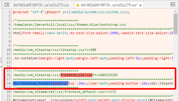

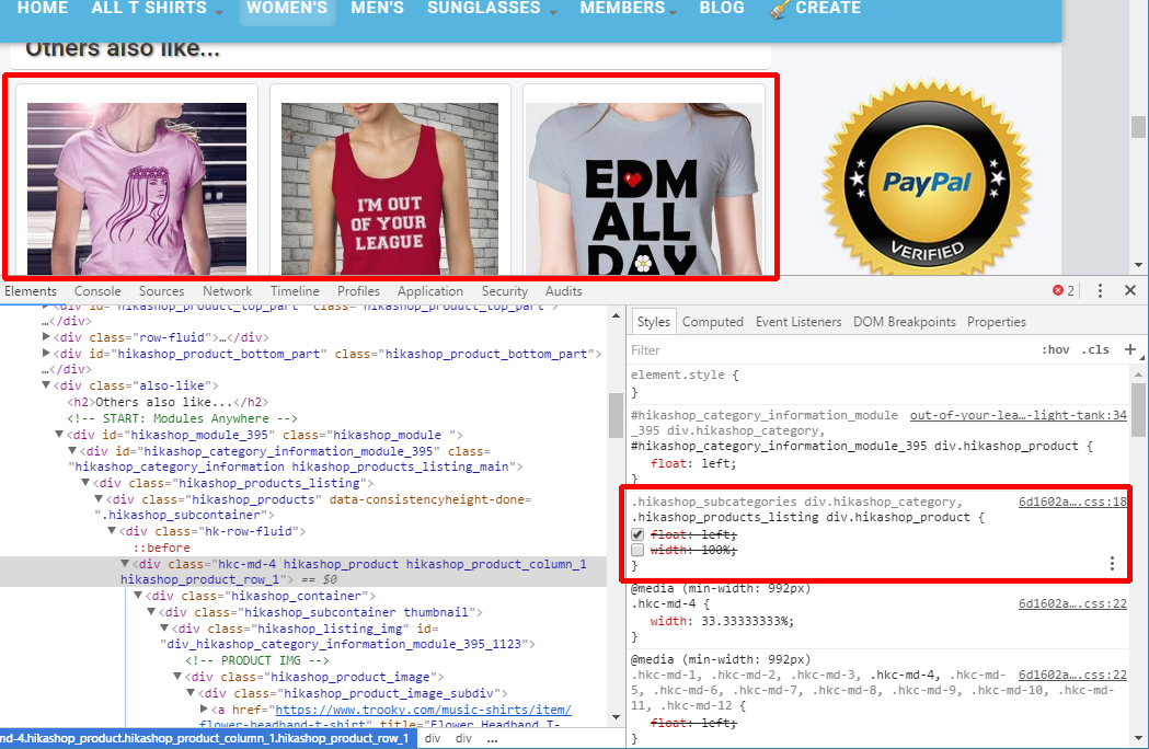

Otherwise, I have a look to your website and your video, I get it, follow me step by step.
Here, your page with the issue and the navigator inspect tool
We see a CSS command that push your div to be in 100% width, that's not normal.
Here, you see that your JCH OPTIMIZ process your css file and especially an old_frontend.css, that don't have to be there because it break the new HikaShop grid system.
And I don't know why this Css file is still there.
Now what to do ?
Remove this frontend_old.css file or the other solution, is to just remove this Css width order, but in the future if we change something in HikaSHop Css, there is some chance that some issue appear again, like in this case.
Last edit: 9 years 6 months ago by Philip.

  • Posts: 26381
9 years 6 months ago #261803
Your issue is related to an old CSS file which have a conflict.
By using the default CSS file, that conflict is not present.
So, because you have an old CSS file which has been customized, we indicated you that you have to just remove one line from your customized CSS.
I'm sorry but you had a question and we gave you the answer, the solution.
Now if you want to continue to tell that it is our fault, go ahead but it won't change anything at your problem and the solution won't be different.
Afterwards, because we don't think that your issue is our fault but is due to a conflict with an old customized CSS file in your website ; we argued in that way because we though it was our right to answer to your accusation.
But yes, it does not allow to go further and it does not change the fact that you have one line of CSS to remove.
