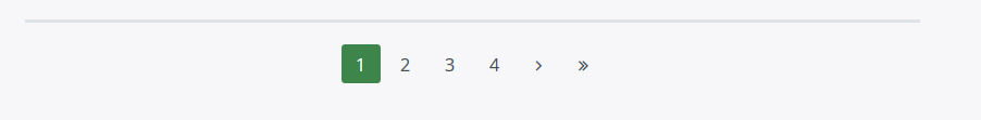

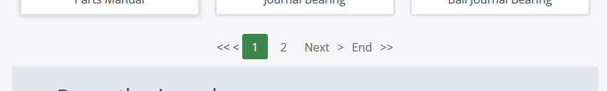

  • Posts: 56
9 years 9 months ago #255317
Hi right after solving the above issue I am now having a few pagination style issues.
After a few hours playing around with my frontend css file I have got the pagination to look very close to the main site pagination but for some reason i have a number of buttons showing which do not on the rest of the site. and its beyond my current skills to remove them perminently however I have managed to get them to display as i need via firebug.
1. currently my hikashop pagination looks like this.
2. but my joomla pagination looks like this.
I have tried editing the frontend css file which gives the results in 1 above and also on another attempt following the advice in this thread https://www.hikashop.com/forum/product-category-display/868410-pagination-display-problem.html and remove what i think is all references to pagination in the frontend css but when I do this I just end up with the stock joomla pagination shown below.
Any ideas what I need to do as I now a bit lost.
Website is on Joomla 3.6.4, Yootheme Square template.
Hikashop is configured for css button style and bootstrap design no
Last edit: 9 years 9 months ago by nippyzap.

  • Posts: 56
9 years 9 months ago #255410
The page with the working Joomla(Yootheme) pagination is www.marinepowerservices.co.uk/engines/past-engines
The hikashop page with with pagination can be found here. www.marinepowerservices.co.uk/gardner/wf-menu-config/lw-engines
You will see that the hikshop page now look as I would like it, but this is a messy temporary fix as from what you have written and the comments in the thread i mentioned earlier I take it that with all the css references removed relating to pagination the hikashop pagination should look identical to the Joomla one.
To get the hikashop one looking correct for now, I have ended up adding code into a number of hikashop files.
In the hikashop pagination.php file I have had to add the below. I cant put it in the template\html\pagination.php file because it breaks the other pages with pagination on the rest of the site however hikashop then shows correctly. Obviously this is messy as it will get overwritten when I update.

  • Posts: 56
9 years 9 months ago #255465
Good Morning Nicolas,
Thanks for the code however I don't seem to be able to get it to work, currently it just breaks the rest of the site like it did when I put the function in on its own. Im sure I have done something wrong. but as you can probably tell I am fairly inexperienced with PHP/CSS
I have returned the hikashop pagination.php file back to the standard one. and the template/html/pagination.php file now looks like this

This causes the joomla page with pagination to look like this
and the hikashop page pagination looks like this

  • Posts: 56
9 years 9 months ago #255554
Thank you for your efforts. I have returned Hikashops pagination.php file to the standard one and replaced the code in my template/html/pagination.php with your suggestion. It no longer breaks the rest of the site but does not alter the hikashop pagination from what is displayed without this code added.
I have left the site with the problem hikashop pagination showing so you can see what is happening.

  • Posts: 86058
  • Thank you received: 14184
9 years 9 months ago #255570
I've checked the issue on your website again, and its quite strange as it looks like the template is adding a second chevron next to the one added by HikaShop.
The one with the class hikashop_next_link, displayed by HikaShop has the correct look, while the class pagenav_next_chevron has a wrong look.
So the easy solution would simply be to hide these extra elements with CSS like that:
.pagenav_next_chevron , .pagenav_end_chevron{
display: none;
