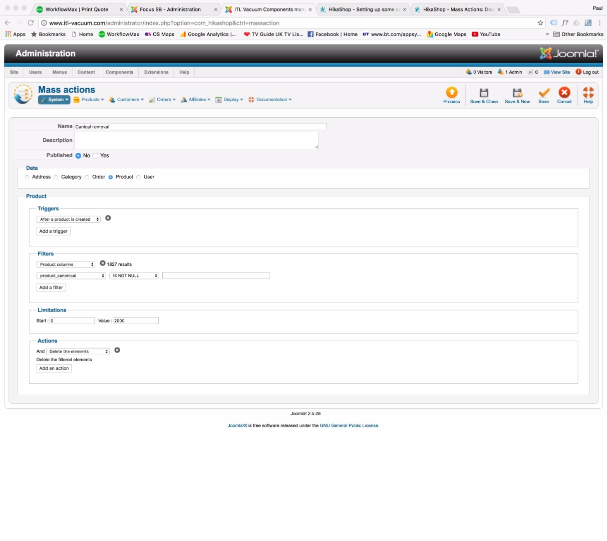

can you confirm that the settings (see attached) are correct for the mass action.

"Delete the element" will delete the product ; it won't update the product canonical field.
Please read very carefully the Nicolas' message:
with an action "update the values" on the "product_canonical" column

Is the attached correct? Not sure what value to add in the 'INT' drop down.

'INT' is the shortcut for "integer". So you want to use "string" instead as the canonical URL field is a text field.
