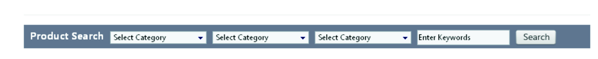

Search module
9 years 11 months ago #258105
by omys
Search module was created by omys

9 years 9 months ago #262463
by herb200mph
Replied by herb200mph on topic Search module
FOR: omys
Did you ever find a source for the search module you showed in your initial posting?
We are interested in applying something like that to our shop configuration.
Contact me if convenient.
