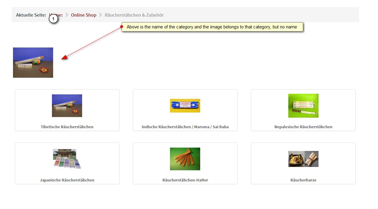

1. When I select a category with subcategories, the image assigned to the main category, is also shown without the name of the main category. Can I either have the name and the image shown or no image - see what I mean in the attached image.
I have also found that in one categories with no subcategories, it shows the full size category image, but in this one it only shows the thumbnail

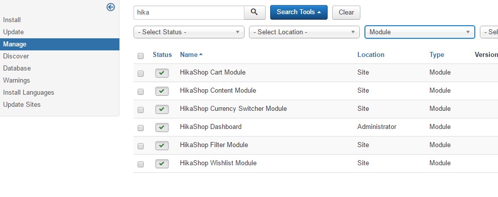

2. I don't appear to have a "Categories on 2 levels" Module - see image

1. The image of the main category is displayed as you turned on the "show image" setting of your menu item.
And the name is not displayed as you turned off the "page heading" setting of the menu item.
The image is indeed displayed in full size here. If you see a small image, it just means that the original image is small, or you have CSS code applied to that element to display the image like that.
2. It is added automatically when you install HikaShop the first time so if you don't have it, it's maybe that you had an old version installed before.
But anyway, it's only an instance of the HikaShop content module configured to display the categories like that. You can create your own new instance of that module and configure it the same way as the module instance installed by default and it will display the same.

1. As I said, it's a CSS issue. Add such CSS on your website and it will display the image normally:
img.hikashop_category_image {
height: auto !important;
