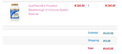

3. Tt couldn't change quantity in cart status. How to add a quantity change button?
4. And also when quantity changed in shop cart,total price should change automatically and timely.

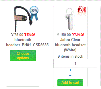

3. 4. You should check that the value of the "Quantity input method" option isn't set to "None" through the page "Hikashop->System->Configuration->Display" but also through your product configuration page.

3 and 4. I could find the "Quantity input method" option in "product options" area through the page "Hikashop->System->Configuration->Display". But where is the option of "but also through your product configuration page"

3 - We can assure you that there is a setting for the quantity input in HikaShop configuration :
www.hikashop.com/support/documentation/5...html#display_product

3. I had set the "Quantity input method" option in "product options" area through the page "Hikashop->System->Configuration->Display". But it still couldn't change quantity in cart status page.

3. In your checkout workflow, there are two views you can use to display the cart: "cart" and "cart status". The first one, "cart", displays the cart and you can modify the products in them. The second one, "cart status" displays the cart and you can't modify anything. It's goal is to display a status of the cart, for example, for the last step of the checkout, before the customer finalizes his order.
So if you want the quantity to be modifiable in the "cart status" view, I don't recommend that. Simply use "cart" instead in your checkout workflow and that will do it.

OK,I just added Cart Status before. Now Cart added and Ok. Many thanks for your help.
