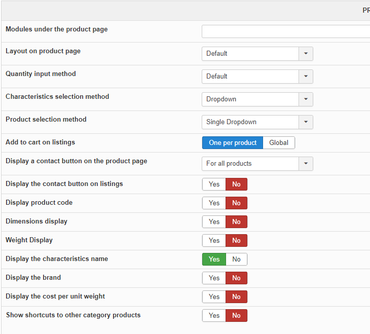

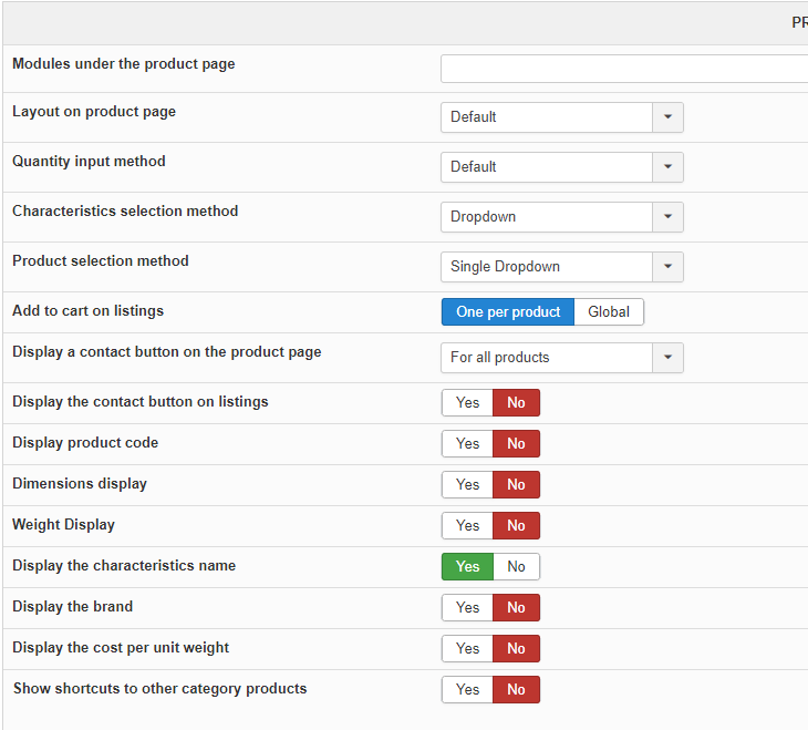

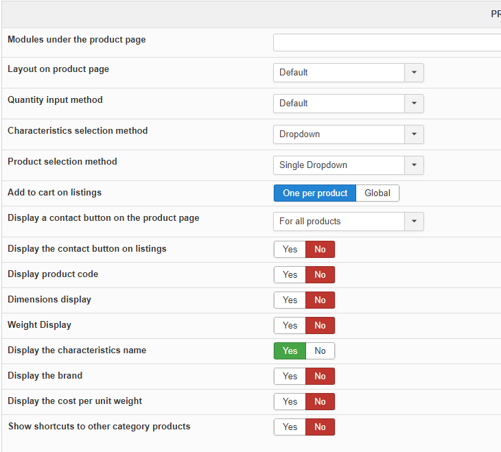

This is what the product page looks like
Attached

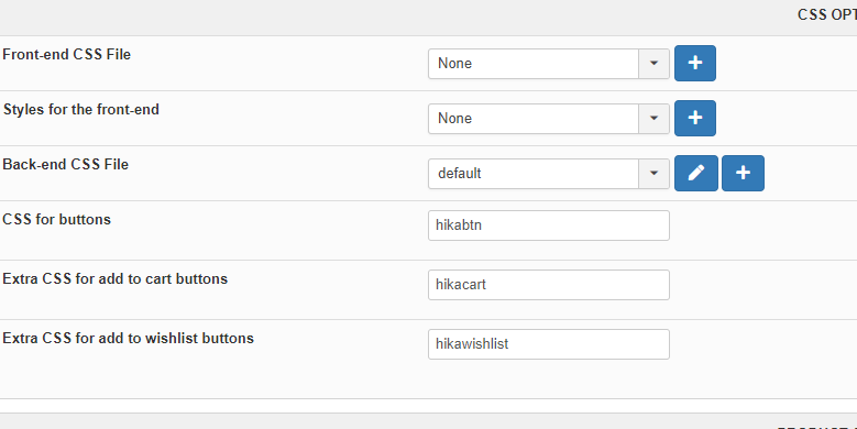

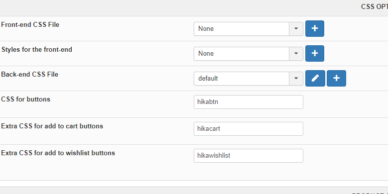

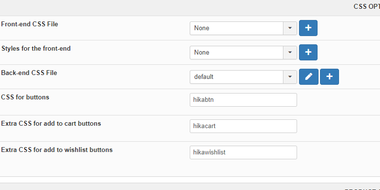

Here is the CSS options
attached
