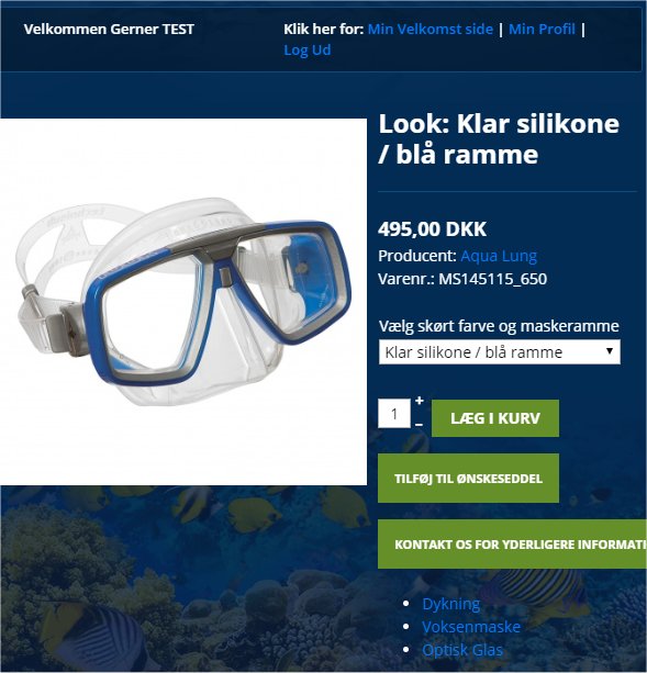

On my product page I have the product name and if there is any characteristics to the product its showed right after then mave like:
Mask: Blue
But I need it to be showed like this:
Mask
Blue
I cant figure out how to get a "<br>" in the code to move the characteristics down to next line.
I have tried to fix it on the code here (product / show_default.php):
<h4 class="hhead-line-bottom">
	<span id="hikashop_product_name_main" class="hikashop_product_name_main" itemprop="name">
    <?php if(hikashop_getCID('product_id') != $this->element->product_id && isset($this->element->main->product_name))
		echo $this->element->main->product_name;
			else
		echo $this->element->product_name;
    </span>
</h4>
As you can see on the attached photo its showed like:
Look: Klar silikone / blå ramme
But I need it as:
Look
But was not able to manage it, can some one please advice?

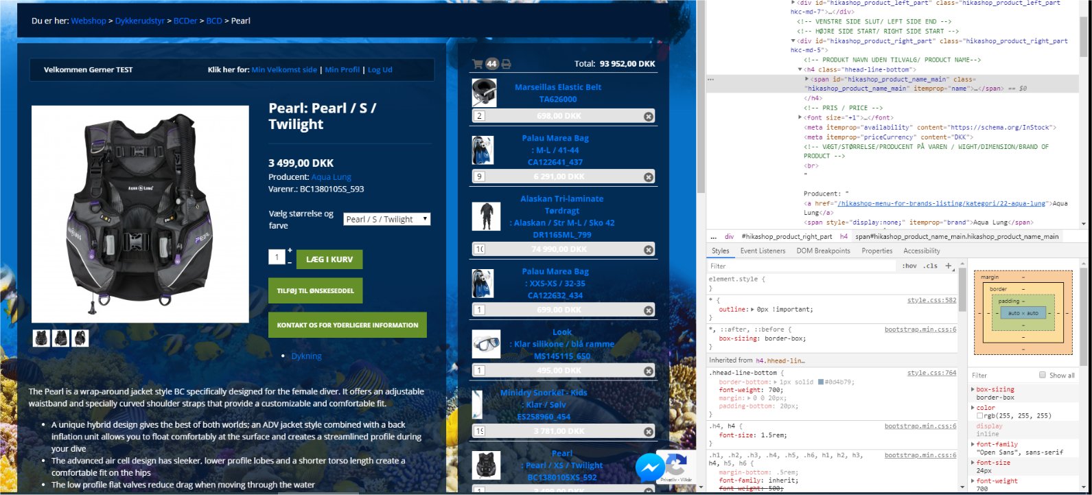

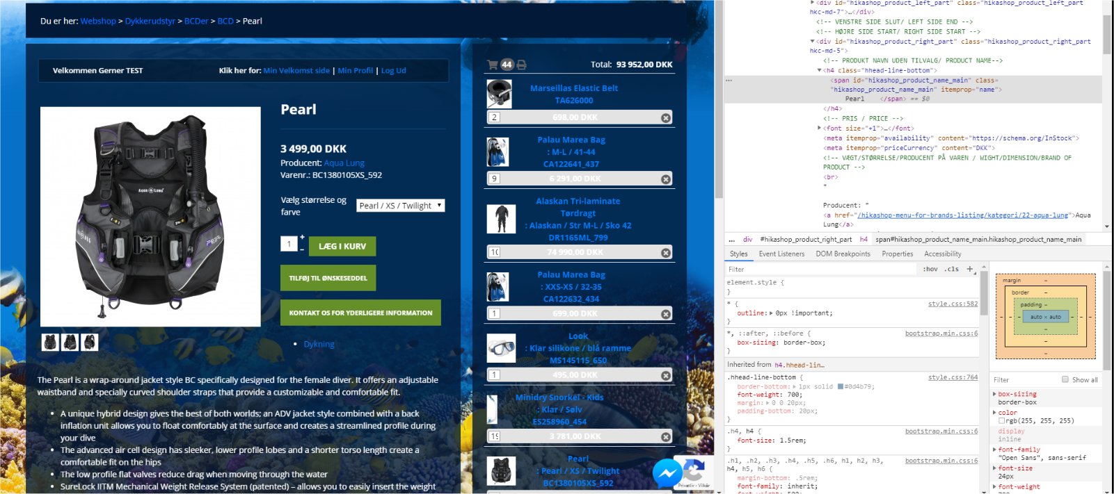

  • Posts: 35
6 years 4 months ago #316976
Move subname / characteristics to new line.
When you go to the website and to a product the page look like this:
Its where the product name is: Pearl I face the issue. The above photo is correct, but when you choose a size (characteristics) the page change to this:
Now the product name says: Pearl: Pearl /S / Twilight
What I want is that the text look like this:
Pearl
Pearl /S / Twilight
when you choose a size (characteristics).
The blow code is from Google Chrome
Pearl
<span class="hikashop_product_variant_subname">
Pearl / S / Twilight
</span></span>
But when I search for hikashop_product_variant_subname in all CSS files nothing show up! I was hoping that I could change something in there.
When I check the php file I can find the code:
</span>
</h4>
And that show the product name (Pearl), so if I remove that code the product name on the website disappeared and the same for the characteristics when that is chosen, but the above code don’t refer to the characteristics codes so I’m not able to add a <br> anywhere. Can some one tell me where the code are located for characteristics displayed on the product page?

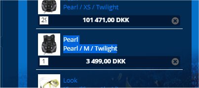

  • Posts: 35
6 years 4 months ago #317072
Thanks, I add the <br> and that works fine :)
I now try to do some small changes to the CSS and need an advice. In the shopping cart on the product page the text is placed in left side of the box and in the middle, but I would like to move it to the top, but I cant finde the right comando to do it. What I got is:
.hikashop_cart_module_enhanced .hikashop_cart_module_product_name_value.hikashop_cart_value a {
		display: block;
		text-align: left;
		margin-left: 3px;
		font-weight: bold;
		vertical-align: top;
		width: 280px;
As you can see I tryed to add: vertical-align: top; and: vertical-align: text-top; but non of them move the text to the top. Please see attached photo.
Can anyone advice?

  • Posts: 35
6 years 4 months ago #317116
Thanks for your reply. Sorry for not being clear in my question. It’s the text like:
Pearl
Pearl / M / Twilight
I would like it to be moved up to the same height as the top of the photo, so the text is on the top of the box and not centered vertical
Hope that make sense :)
Last edit: 6 years 4 months ago by Gerner.
  • Posts: 86052
  • Thank you received: 14180
6 years 4 months ago #317131
Then, you can add such CSS:
.hikashop_cart_module_enhanced .hikashop_cart_module_product_data { vertical-align: sub !important; }
