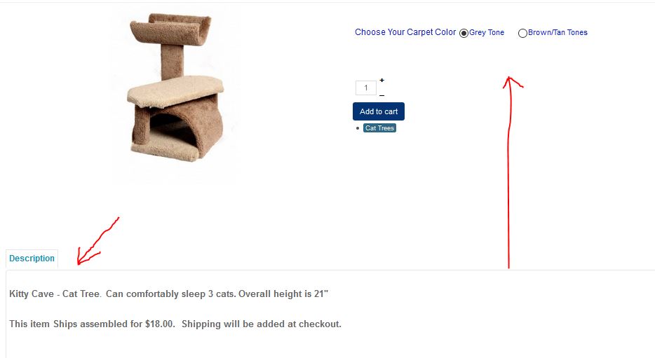

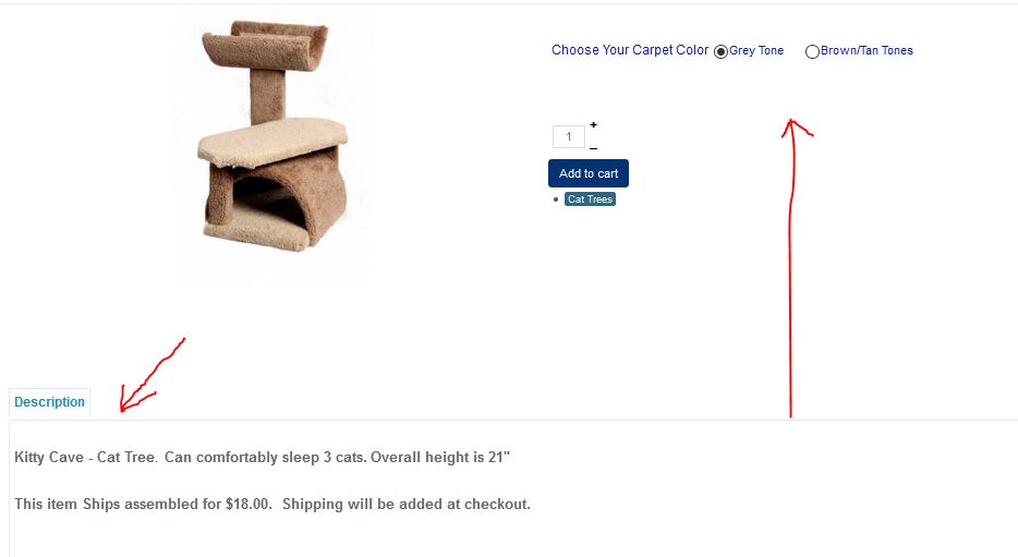

When you select the characteristic everything drops under the picture. Where or how do I edit to keep everything to the right?
  • Posts: 86052
  • Thank you received: 14180
6 years 4 months ago #316924
In the file www.customqualitypetfurniture.com/templa...e/css/thirdparty.css of your template you have that CSS :
.hikashop_product_left_part {
  width: 55% !important;
.hikashop_product_right_part {
  width: auto !important;
This is what is creating the problem. Without that CSS it would work fine.
Now I don't know why your template provider is adding that CSS since I don't see it solving any problem the default CSS of HikaShop already solves.
So I would recommend to check with your template provider as they will be able to provide the best solution, knowing why that CSS code is there.
