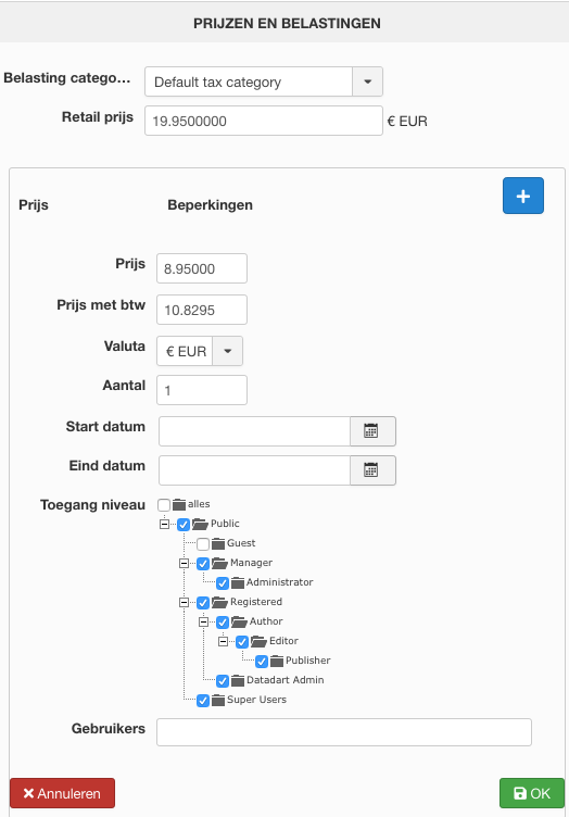

I've got a shop running with over 1400 product running and this is working fine! However I need to change the rights for thsi products to make the pricing also public and also for guests.
i know this can be done in batch but can someone lead me to the proper instructions?
Thanks!

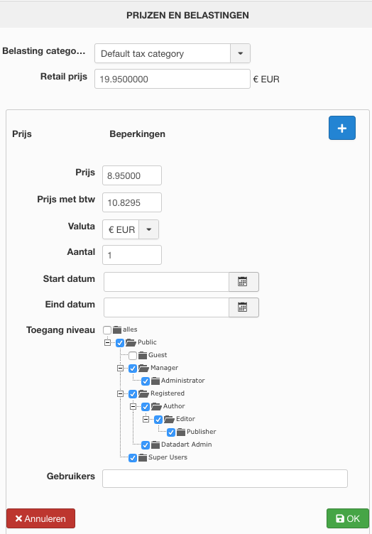

5 years 9 months ago #324862
Dear Mohamed,
Thanks for your reply. I've tried different settings and variables on this mass action but I can't get it right...I would like to set the pricing access to "all", see screendump. Any suggestions?
Thanks!

5 years 9 months ago #324873
Setting the price access level to all with a mass action is quite easy actually.
You just need an action "update the values" in the column "price_access" with the "string" mode and the value "all" (without the double quotes). When you process the mass action, it will run the action on all the products unless you add some filters to your mass action to only do it for some products.
