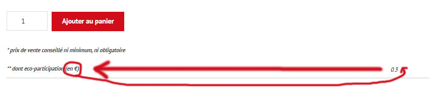

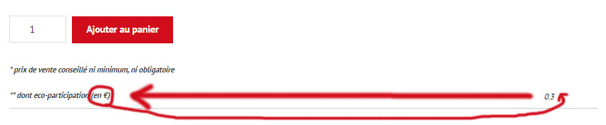

I have a custom field but i would like to change the display so that the number is closed to the label and the symbol € after the number.
Can you help ?

Thanks for your element, from what I see, I have some suggestion, follow me step by step :
Custom field configuration :
1. Modify your label to have only "** dont eco-participation(en"
2. Then, like you do now in product backend only number 0.3
=> Result so far :
"** dont eco-participation(en 0.3"
Css customization :
We will complete this with some css :
1. Have a look on this tutorial , to see how to add custom css to your frontend file.
2. Use this command :
tr.hikashop_product_custom_ecopart_line span.hikashop_product_custom_value:after {
    content: "€)";
3. To suppress the space between the label & the value, use this css code :
tr.hikashop_product_custom_ecopart_line td {
    float: left;
    display: inline-block;
Hope this will meet your expectations.
