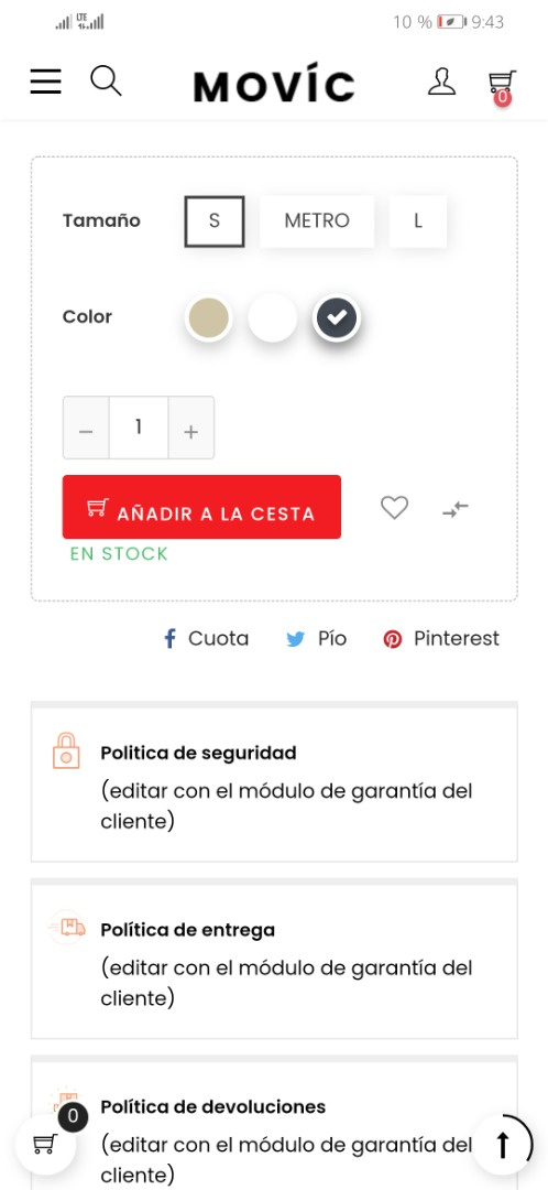

Como cambiar el estilo de selección de colores en la pagina del producto del sitio a círculos con colores donde el cliente escoge por medio del mismo (envíe una imagen de ejemplo de lo que busco)

3 years 10 months ago #335522
Thanks, but even if I manage to put colors on the products, I can't make them have a selection border around it that indicates to the customer that this was the one they chose.

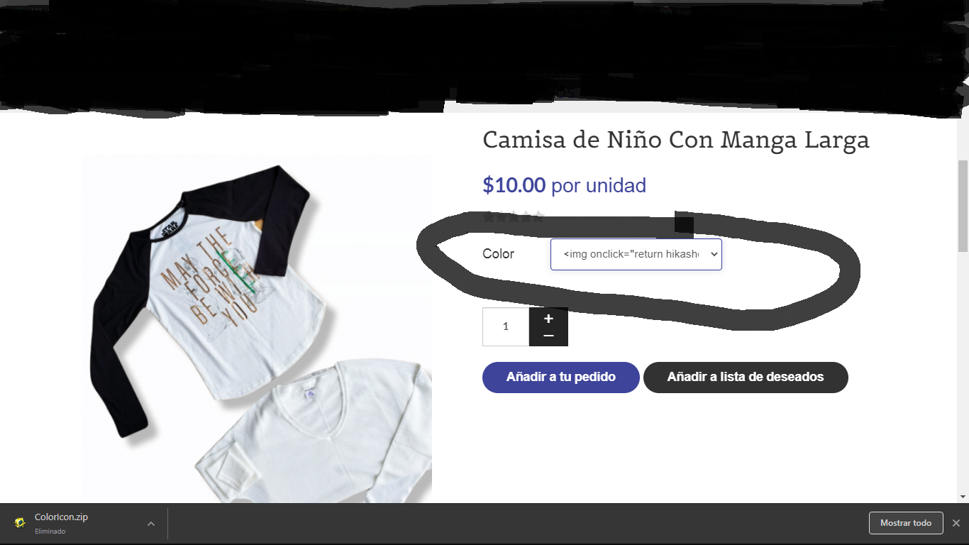

3 years 10 months ago #335562
I did all the tutorials but rather it got worse I show an image that is happening to me with the colors, I must say that during the configuration everything was going well but on the product page it looks like this I hope you can help me thanks

3 years 10 months ago #335567
In the HikaShop configuration, for the setting "Characteristics selection method", select "radio" so that the characteristic selector displays as a radio list and not a dropdown.
