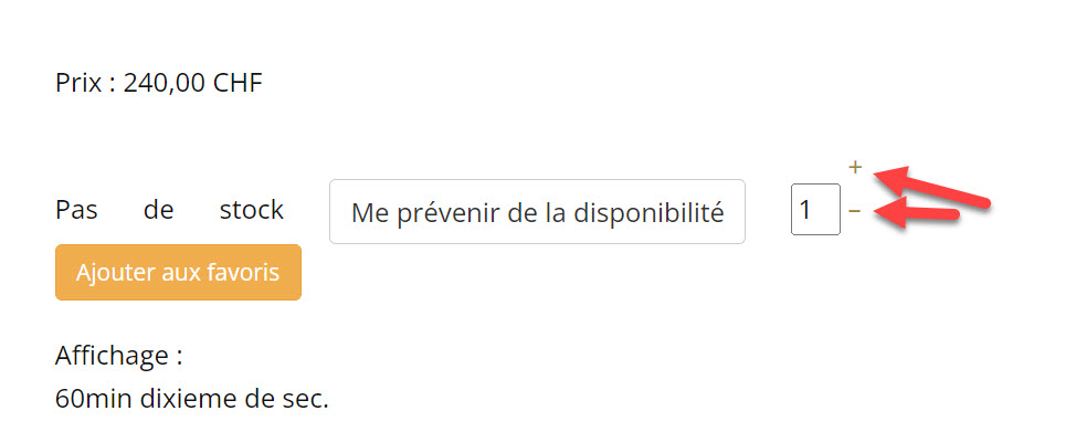

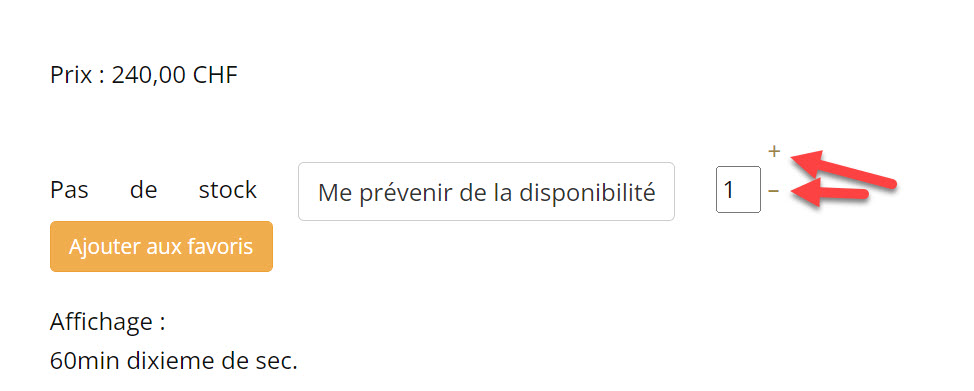

How can i customise the quantity box ? Whatever i select in the configuration, the layout is really bad.
As you can see in the screenshot :

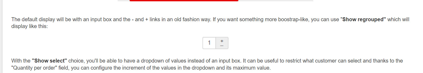

I want to have that, like in your documentation :
Actually is "show regrouped".

4 years 3 months ago #341276
You are right, the screenshot was made with the Joomla 3 template, now it seems that we have some work in order to keep this consistent with the Joomla 4 template.
We will work on our side in order to improve this on Joomla 4, in the meantime to immediately solve your problem and have what you need, follow me step by step :

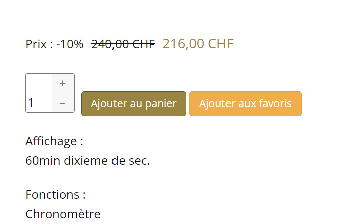

4 years 3 months ago #341290

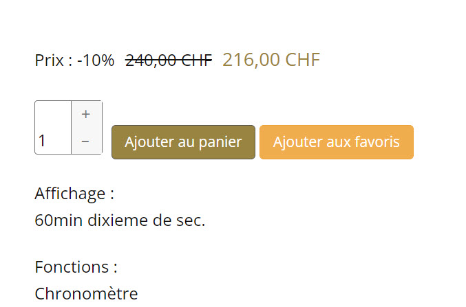

OK, thank you.
It is better, but a little bit big, as you can see in my screenshot.
Is it possible to reconcile the + and the - ?
Or put them horizontally?
I just modified the height to 53px in place of 50 for the border fit the height correctly. But as said, it is too heigh.
Here is the url, but you have to enter with the following credentials :
Regards.

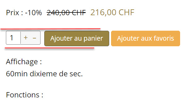

4 years 3 months ago #341309

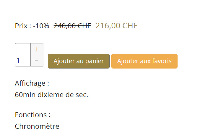

Hi and thank you.
I had to modify your code, because it was not working. It was staying too high.
I put the code used below (I hope I did it right) :
.hikashop_product_quantity_change_div_regrouped .hikashop_product_quantity_change_div_plus_regrouped {
    display: inline-block;
    margin: 0 3px;
div#hikashop_product_quantity_field_1_area {
    border: 1px solid rgb(118, 118, 118) !important;
    border-radius: 3px;
    background: #f7f7f7;
    padding-right: 5px;
.add-on.hikashop_product_quantity_div.hikashop_product_quantity_change_div_regrouped {
    display: inline-block !important;
    border-width: 0 0 0 1px !important;
    background-color: #f7f7f7;
	padding-left: 3px;
input#hikashop_product_quantity_field_1 {
    border: none;
    padding-left: 7px;
    margin-right: -4px;
I still have 2 small questions:
- I can't align the field with the buttons vertically.
- Is it possible to align the + sign with the - sign? They are not at the same height.
I know that these are small details, but if I can solve them it would be perfect.
