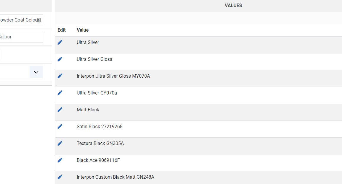

If I have 10 say standard colours in a characteristic called Powder Coat Colours.
Can I assign the colour palette to each variant? Meaning Red has a Red.img file assigned to it
Then when I add this characteristic to the product it will show the colour per selection?
I have 227 products, all have different number of variants based on product, colour availability for that product.
I really dont want to have to add each variant and then add each img file each time I create / update the product.
Is there a way to do this easily ?

Ok, here is the scenario that I am now facing. I am told there are up to 300 custom colours that can be possible to be used.
I have a set of standard colours maybe up to 30. Then a range of custom colours up to 200, then the rest are not so used colours, but are requested every now and then.
How do I present that against a product?
Do I do what I did for the custom field, have a drop down with Yes - Standard Colours, Yes - Regular Custom, Yes - Non Regular Custom and then turn on whichever Characteristics dropdown is selected ?
Meaning I have 3 Characteristics :
Standard Colours [125]
Regular Custom [126]
Non Regular Custom [127]
Depending on the dropdown display that Characteristics

4 years 3 months ago #342686
by nicolas
Replied by nicolas on topic Characteristics Display per variant selection
Since you already have the "dynamic display" activated for the characteristics, the color dropdown will display only the colors available.
So you can have only one characteristic for all the colors. And one characteristic to select the "standard" / "regular" / "custom".
Then, when you create variants, you need to add variants of the standard colors only for the "standard" choice of the second characteristic, regular colors only for the "regular" choice of the second characteristic, etc.
That way, HikaShop will filter the colors in the color characteristic radio selector based on what is selected in the "standard" / "regular" / "custom". dropdown.
Note of course that the "standard" / "regular" / "custom" characteristic should be first in your product and the color characteristic second so that the customer select first "standard" / "regular" / "custom" and then only see the corresponding colors.
