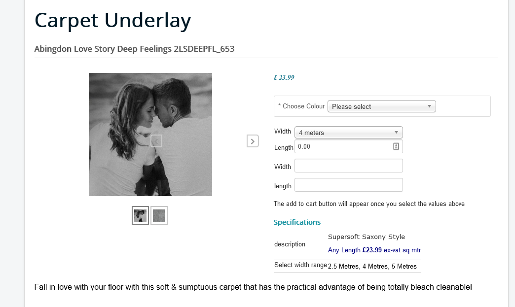

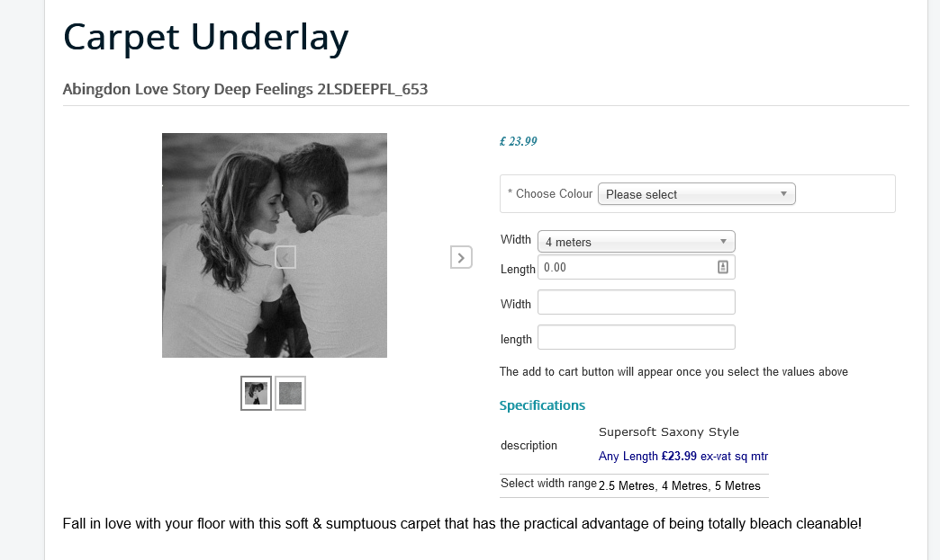

3 years 10 months ago #343530
HI,
When I select that option to:
"Display After Main Product Image" I get the attached behavior
However, I do want the main image to be replaced and the variant to be selected when pressing the variant thumb images - but they are not displaying?

3 years 10 months ago #343532
There may be 2 points to check and that can explain your current display results :
1. The product have just one image, and so HikaShop won't add some thumbnail image
2. Your Thumbnail option is switch off, in HikaShop Configuration, Main tab => Images part
Can you check this and make your returns ?
Hope this will help you to achieve your needs.

3 years 10 months ago #343566
1. The product has an image and each of the variants have a different image
2. Thumbnail is switch on.
For example this site (using a slightly older hikashop version) this works as it should, each variant image is shown as a thumb under the product: https://www.floor-site.com/carpet-ranges/multi-width-carpet-ranges/product/8310-abingdon-love-story-deep-feelings
Clicking the thumb of the variant selects the variant and the select drop down list is also selected to the correct variant - this is the behavior I'm looking for?
