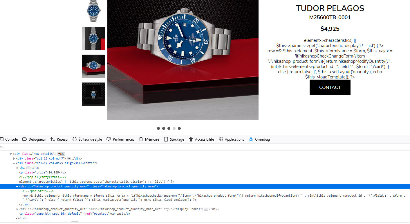

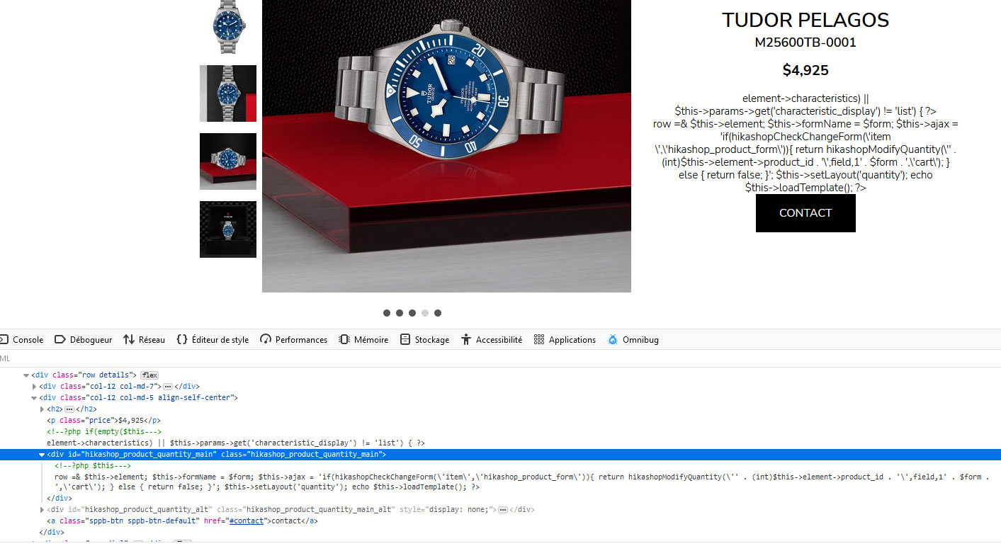

3 years 4 months ago #350362
So I added the code but didn't succeed to make it work. I tried to switch of editor and template to see if it could be the issue, but no result.
I enclose a screenshot of the result.
Sandra
  • Posts: 86050
  • Thank you received: 14178
3 years 4 months ago #350368
Can you provide a screenshot of the code where you did the modifications ?
Because I don't see how you can end up with that result if you follow what I wrote.

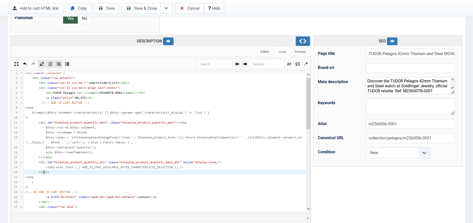

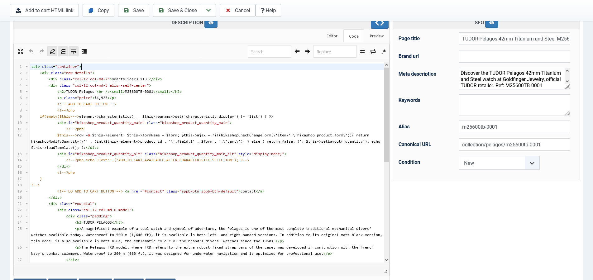

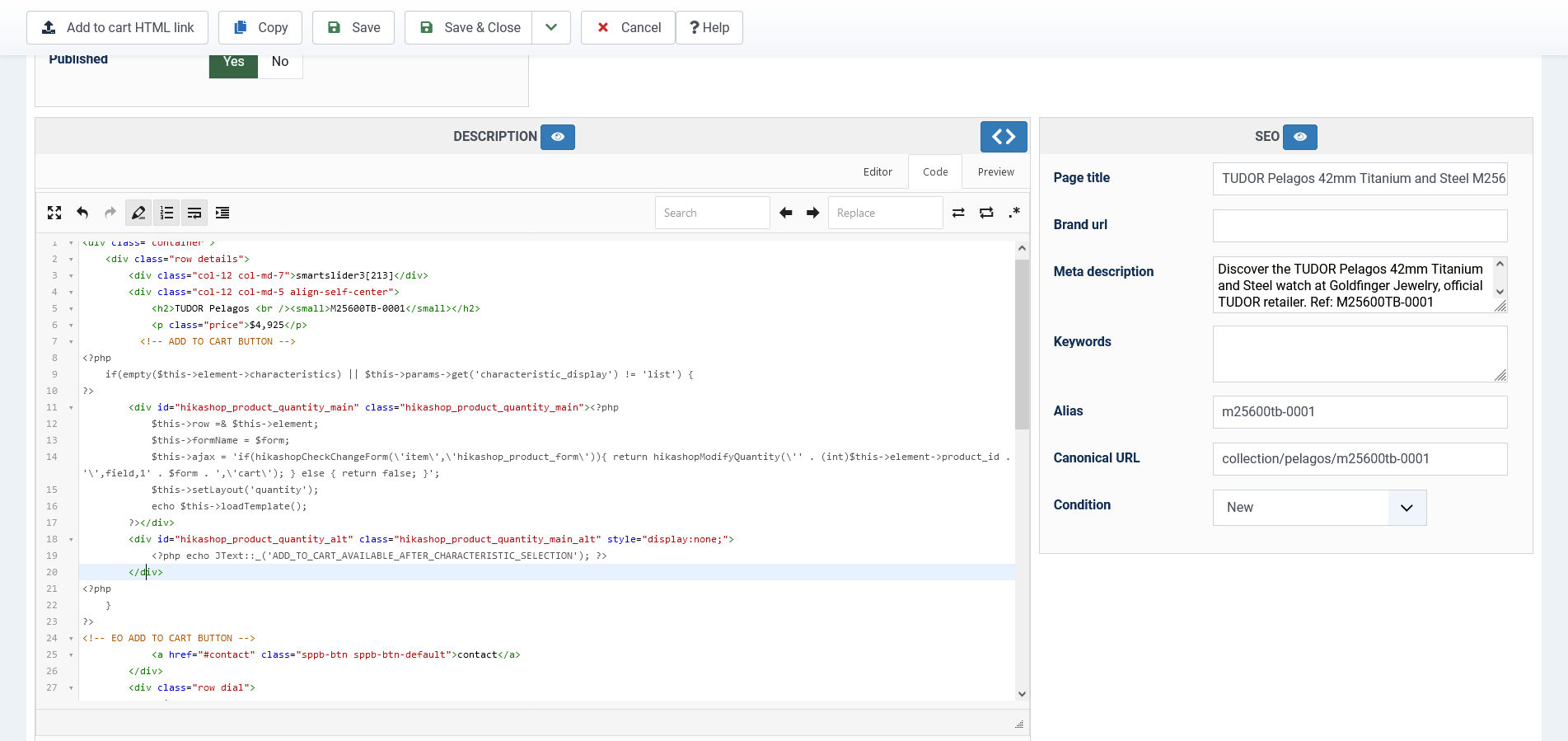

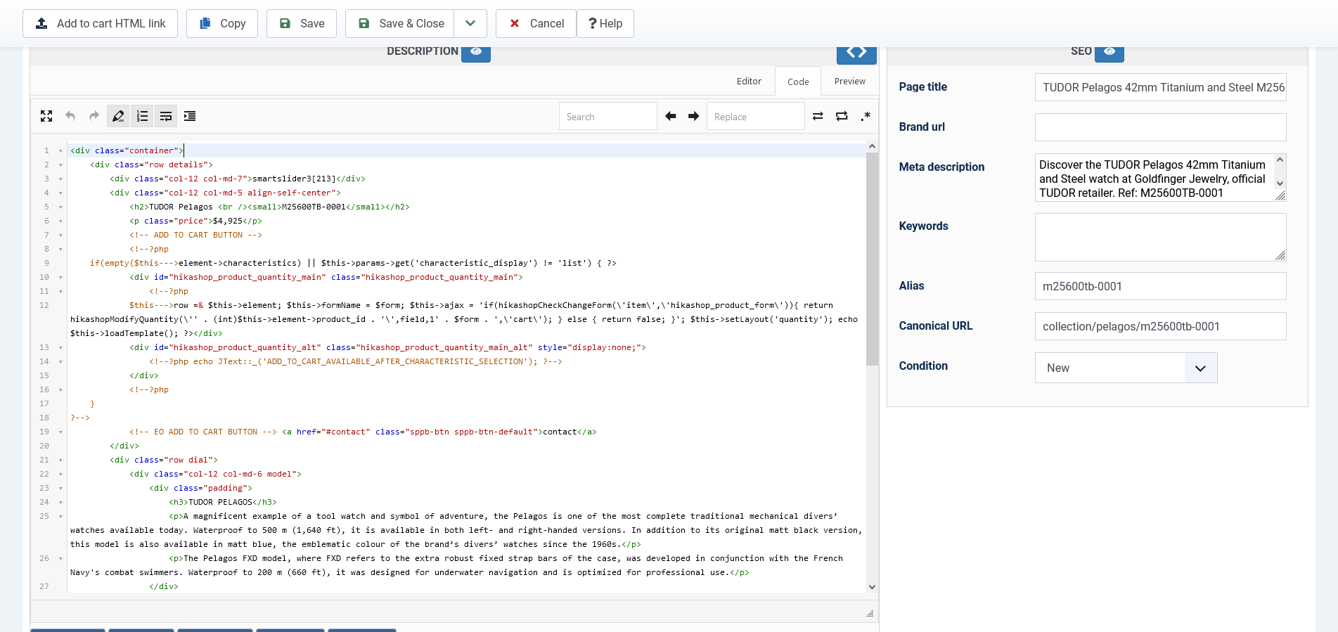

3 years 4 months ago #350380
1st screenshot is what I copy/paste
2nd is what happens when I save the page
