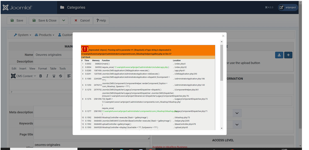

Also, I've been getting an error message when creating products: "administrator/components/com_hikashop/helpers/gallery.php on line 57", so not sure if this may be related. (I have attached an image with the error message)

The deprecated message is actually not an error. It there to tell developers what will change in future versions of PHP so that they can modify their code in advance, before it breaks.
So it doesn't change the behavior of the system. You can just ignore it on your end.
On our end, we actually already have a patch to change the code pointed by the message for the next version of HikaShop.

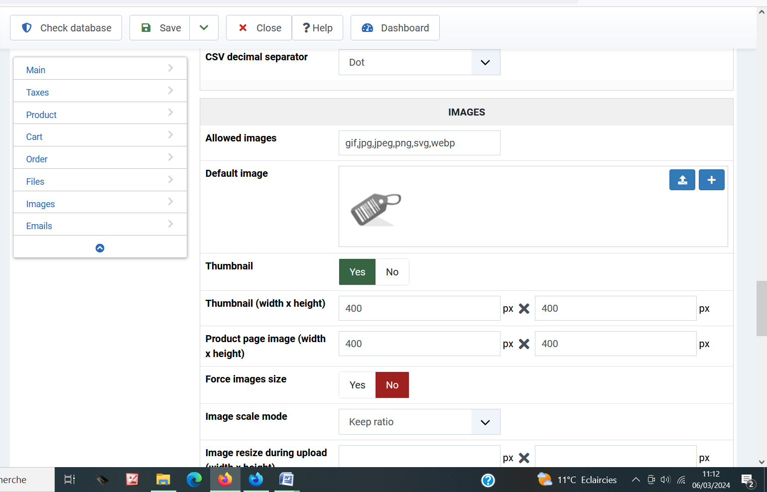

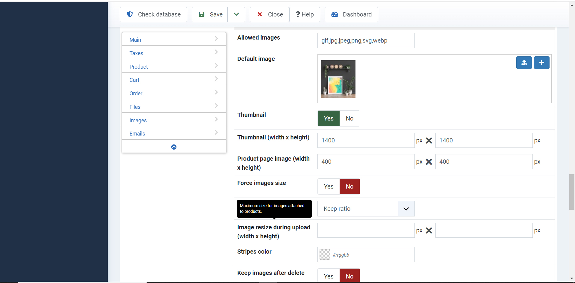

I’ve also added a screen capture image of the settings in the global configuration for hikashop. I tried putting higher values for the thumbnail size (1400 px x 1400 px) but it’s not making any difference. My images are around 950 px x 750 px with 95 DPI. I am currently using a joomlart template using T4 framework, in case this could affect the quality of the images. The problem started from the very beginning of me using hikashop for this particular website. When I uploaded my first image without configuring anything, the image appeared blurred. Then I started to look around in the configuration settings to see if something could be changed, but could not find anything that would change the situation.
I have created 2 categories and both are showing the same issues (blurred images).

3 years 1 month ago #354430 by nicolas
Replied by nicolas on topic Product image blurry
It's hard to say anything like this.
There are two possibilities:
- HikaShop does slightly compress the thumbnails when generating them. So the fact that it is a bit degraded compared to the original is to be expected. You can see the code:
Code:
case 'jpg': case 'jpeg': if(empty($res['quality'])) $res['quality'] = 95; $status = imagejpeg($res['res'], $filename, $res['quality']); break; case 'webp': if(empty($res['quality'])) $res['quality'] = 95; $status = imagewebp($res['res'], $filename, $res['quality']); break; case 'png': if(empty($res['quality'])) $res['quality'] = 9; $status = imagepng($res['res'], $filename, $res['quality']); break;
in the file administrator/components/com_hikashop/helpers/image.php
There, you can see that for a jpg image, the thumbnails are compressed by 5%. Change that to 100 and there will be no compression when HikaShop generates the thumbnails.
Note that once the thumbnails are generated, it won't regenerate them. So you would have to delete the folders under the images/com_hikashop/upload/thumbnails/ folder so that it would automatically regenerate them.
If you don't see any difference, then it's not this which is the problem.

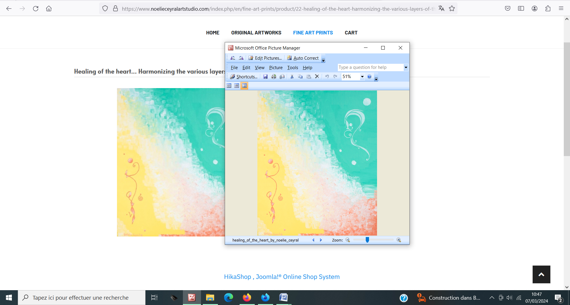

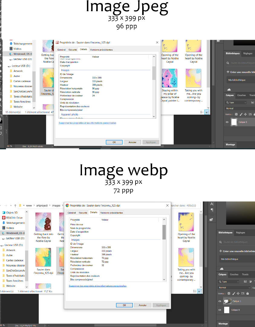

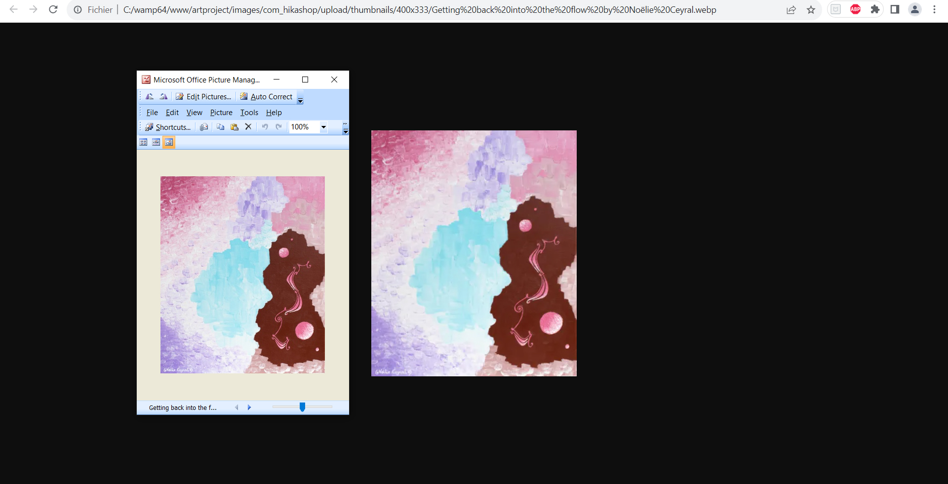

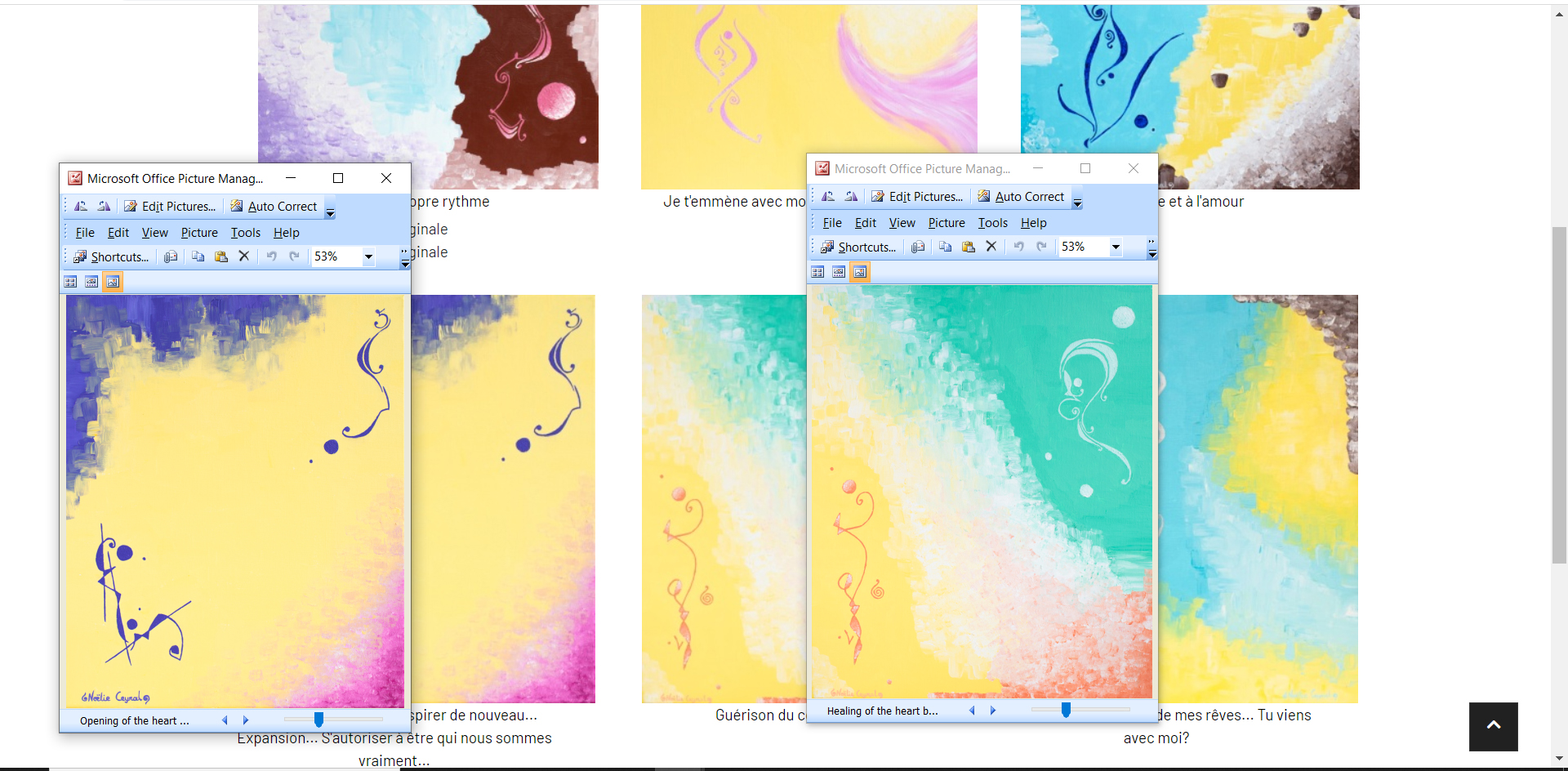

However, I’ve realized that every time that I upload an image, 2 images are being saved: one jpeg and one webp image. The webp image is of lower quality. I’m including an image for illustration.
In the screen shot, I’m sending you, I opened the jpeg image as well as the webp image for the same painting in the 400 x 333 px thumbnails folder. The jpeg image is slightly smaller in size, however, when I check its size it says 100%. The webp image is slightly bigger in size though it is also blurred whereas the jpeg image is totally clear. If I want my jpeg image to be the same size as the webp image, I need to increase its size by about 20%. Then the image also becomes blurred, just like the the webp image.
Also, when I right click on the images from the hikashop products and try to open up the image in a new tab, the image that appears is a webp image. But when I right click on other images of my website that are not from hikashop, the image that opens in a new tab is a jpeg image.
So, I guess that the issue is that the webp images of hikashop are being increased by 20% from their original size, hence the loss of quality from 20%. The webp images seem to be the images that are used for the products' images. Do you know where this problem could originate from? And how to change that?

I'm also realising that the jpeg image and webp image don't have the exact same resolutions when i'm right clicking on the image to find out its properties. See attached image which shows different ppp for the same size image in the thumbnails folder (one for the jpeg image and another one for the webp image). I tried uploading an image with 125 ppp (or dpi) in the upload, general folder, and here is how hikashop creates thumbnails for it for the 333 x 399 size:
- jpeg is 333 x 399 for 96 ppp
- webp image is 333 x 399 for 72 ppp
More

Then I would recommend checking the setting "Generate WebP images" in the HikaShop configuration. If it's on, turn it off and that way HikaShop won't use the webp images.

- or increase the size of the thumbnail on the product page in the settings of the configuration to reflect the size of the thumbnails you really want to use.

The image is very slightly blurred. It is not as sharp and clear as the original image. If I put the original image next to the image in the product section you can see the difference (see below image), but it is not a huge difference, though some people will notice it and I definitely notice it, even on my mobile phone screen, as I’m very used to check image quality for printing. As an artist it is essential for me to have clear and sharp images of my work on my website. But anyway, as I managed to get really clear and sharp images on the product listing page, there is surely a way to get to the same result on the product page.
I am going to try adding CSS to resize the image on the product page as you suggested with the below code.

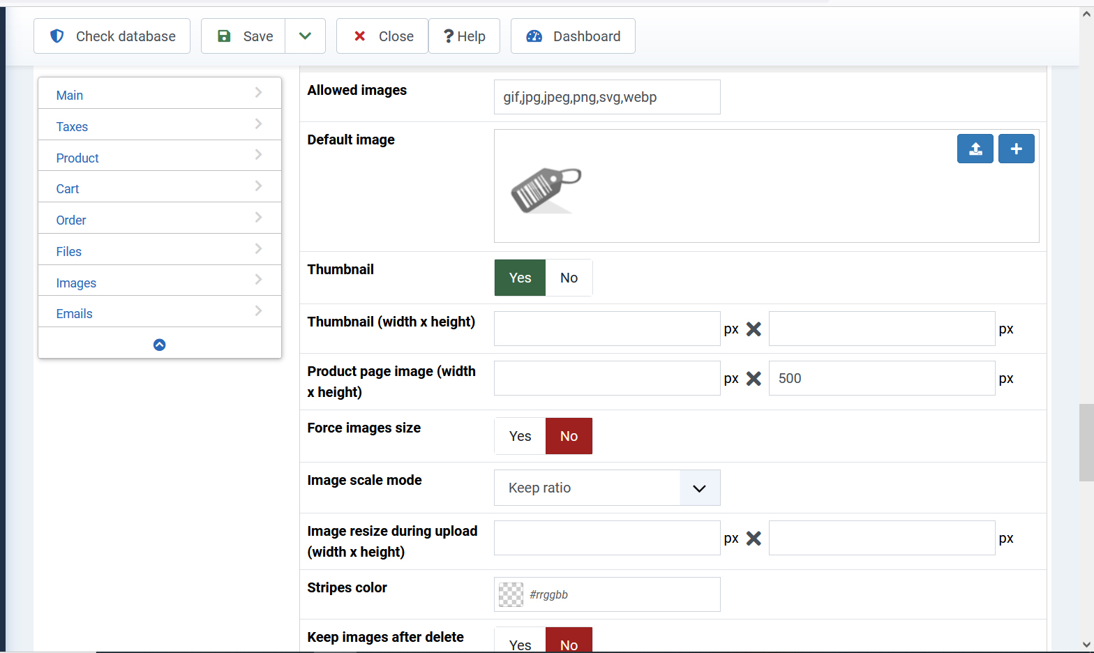

2 years 6 months ago - 2 years 6 months ago #359621 by Noe
Replied by Noe on topic Product image blurry
Great ! Thank you ! My template has got a custom CSS and I have now managed to get clear images on my computer screen with the CSS and configuration I'm sharing at the end of the message. However, I’m having an issue with how the images appear on my mobile phone (again just only for the product image on the product page). The image is now bigger than my screen and not centered (see attached image). Also the arrows of the thumbnails now appear inside of the image, when it was appearing on the side of the image before. Any idea on what I could do in order to solve that issue?
Here is the CSS I entered in my template custom CSS. I had to try various things before it could give me the desired result as it kept on changing the ratio of the image and stretching the width of the image.
img#hikashop_main_image {
max-height: none;
max-width: 400px;
It worked with the below hikashop configuration:

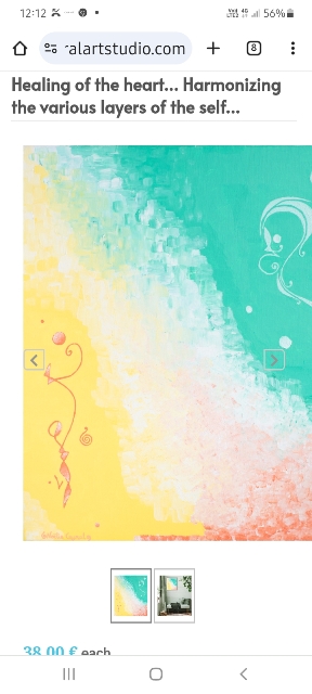

For the problem with the image being bigger than the size of the screen and the arrows of the thumbnails being in the middle of the image, you can check the below two links. The problem appears when I upload more than one image for my product and it is only visible on the product page when you view it on a mobile phone. On a computer screen, it looks fine:
www.noelieceyralartstudio.com/index.php/...ts/product/9-jumping
www.noelieceyralartstudio.com/index.php/...s-layers-of-the-self

Now, for your product image, it seems that your issue come from your current template, see my screenshot :
You can add this command can correct this : "max-width: unset;", see this documentation to see how to proceed.
