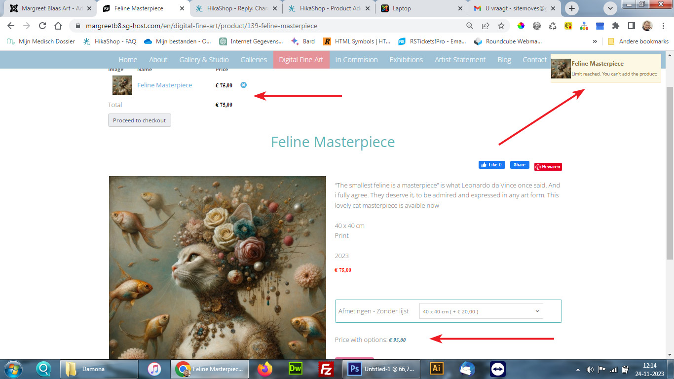

  • Posts: 56
2 years 8 months ago #356911

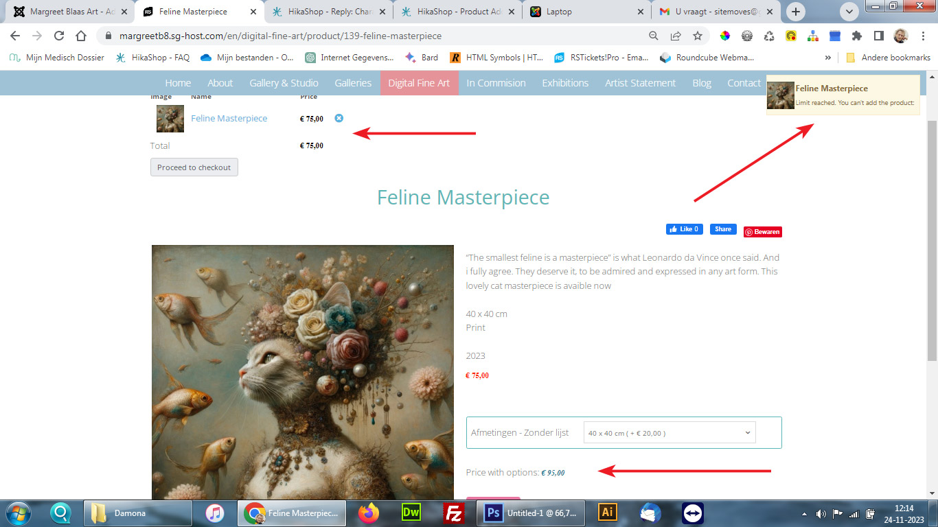

I did what I had to do to make it work.... I thing ;-)

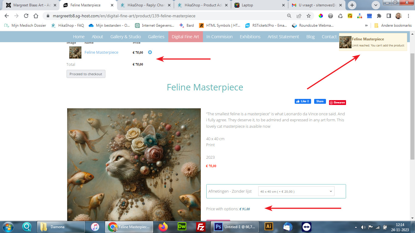

But when I go to the front-end and add my product to the cart, it sayed I reached the limit and can't add it to my cart....
When I go to my cart, I see the product and the price but without the extra option. (see screenshot)
Is ther something I forgot to set?
Regards, Theo

2 years 8 months ago #356912
This indicates that either:
- the quantity you set in the main product of the option or the variants of the option is not enough (so it would be 0 ?)
- your created limits in the Products>Limits menu and one of them prevents you from purchasing the product used as option.

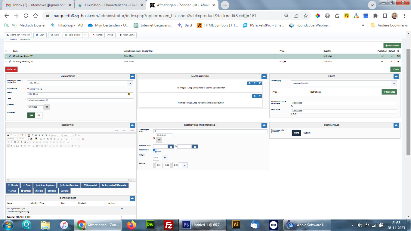

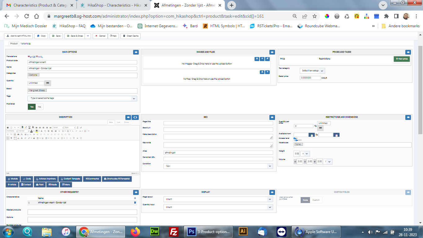

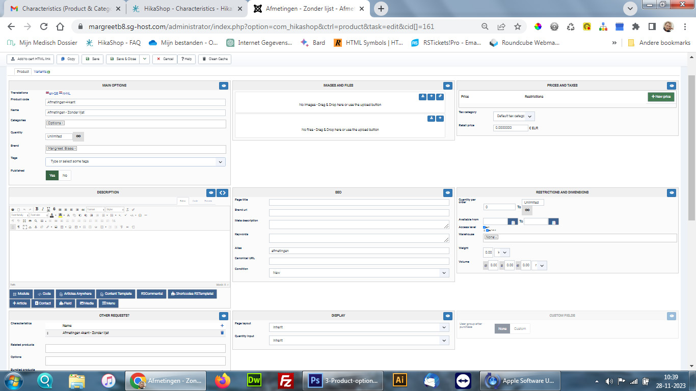

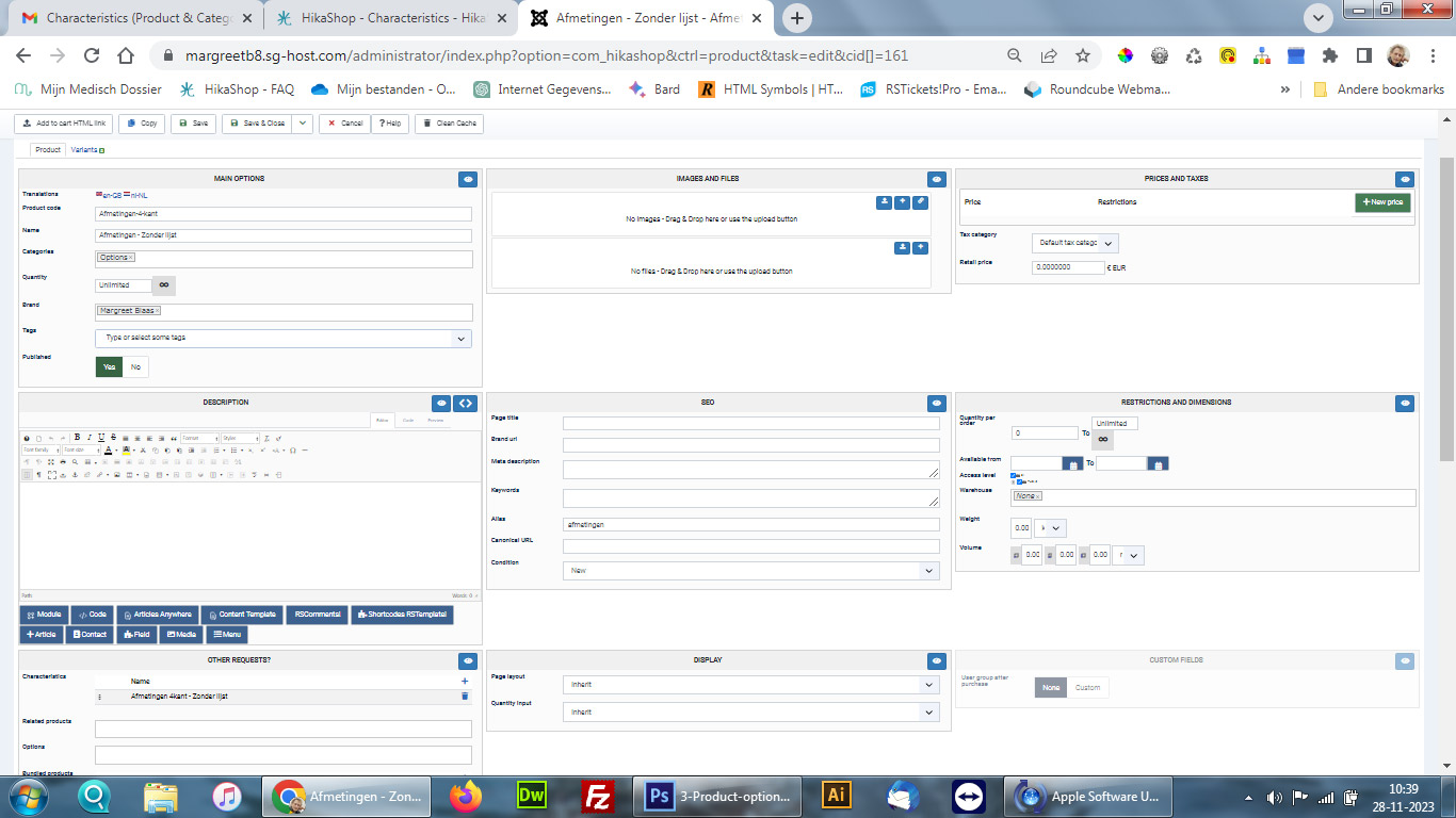

  • Posts: 56
2 years 8 months ago #356987
I did not cofigured any limit because I'm lost over there.
I can provide you a screenshot of mu options product.
Last edit: 2 years 8 months ago by sitemoves. Reason: made a mistake
  • Posts: 86050
  • Thank you received: 14178

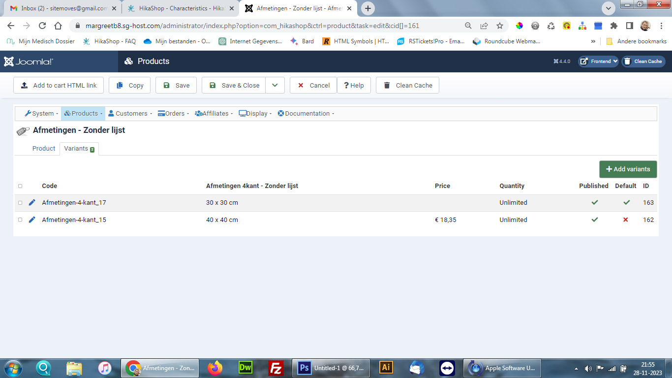

2 years 8 months ago #356989
Ok. If you didn't configure any limit, then there must be an issue with the settings of the option product.
Could you also provide a screenshot of what you have under the "variants" tab of your option product ?

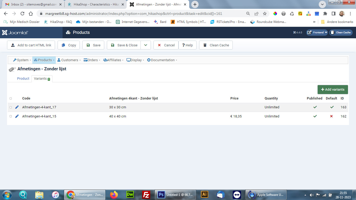

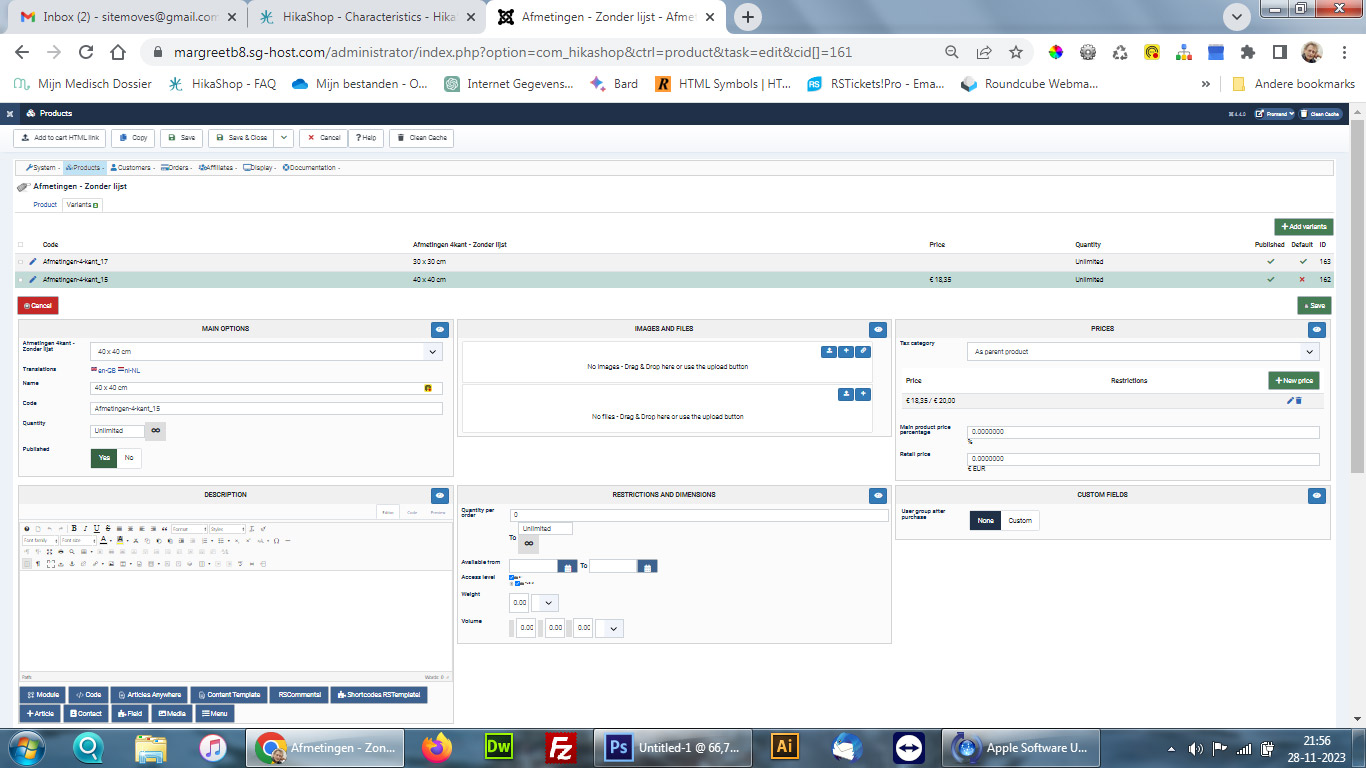

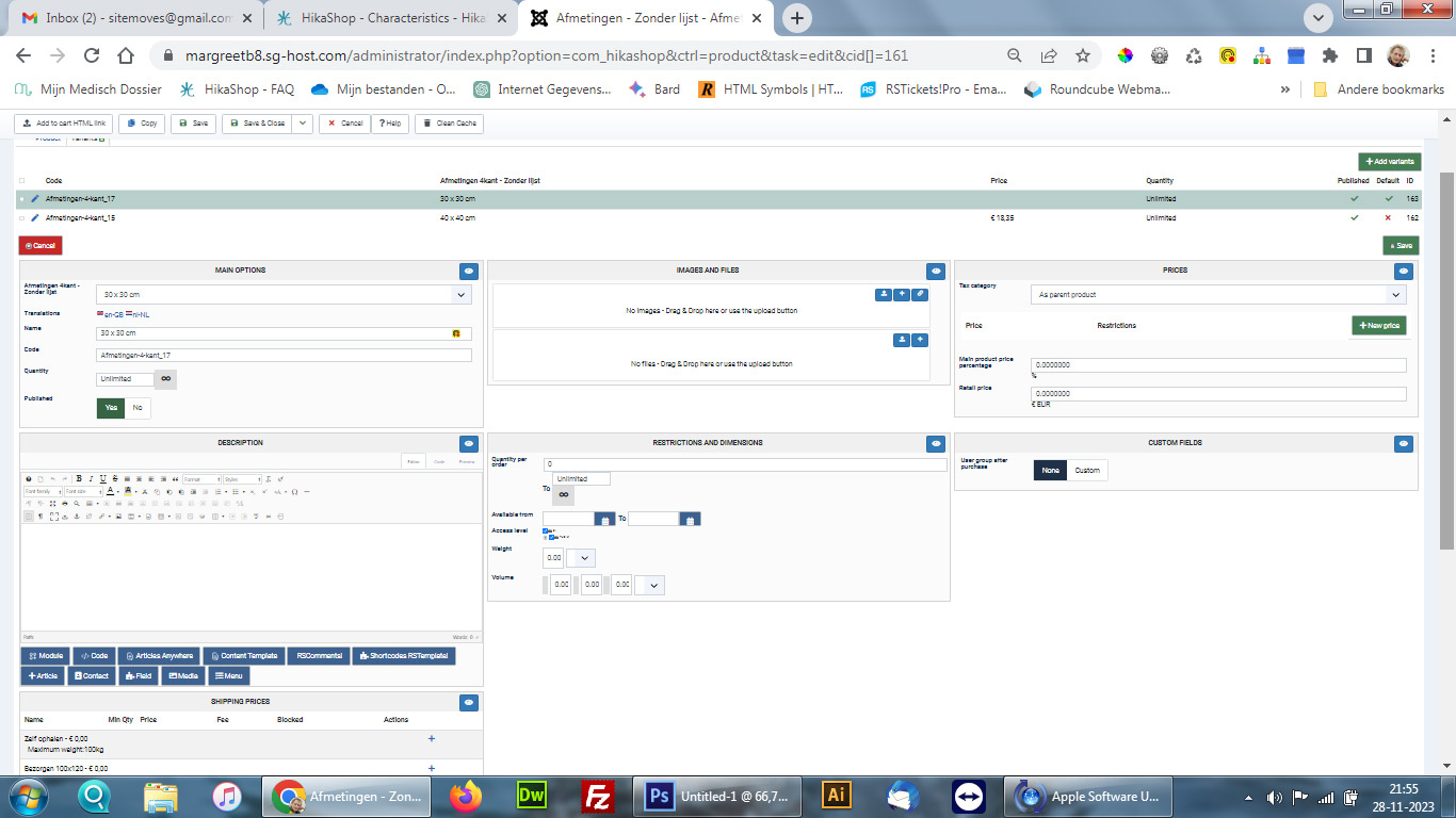

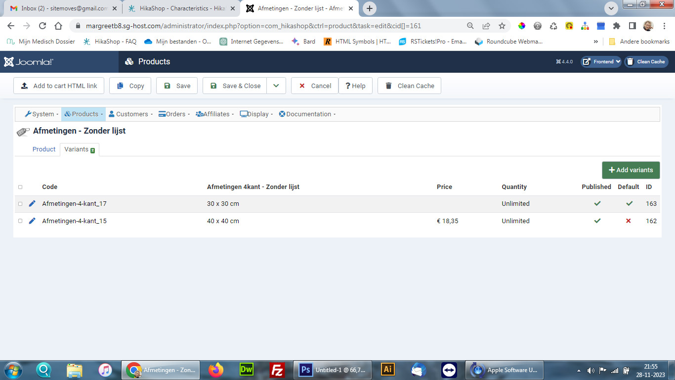

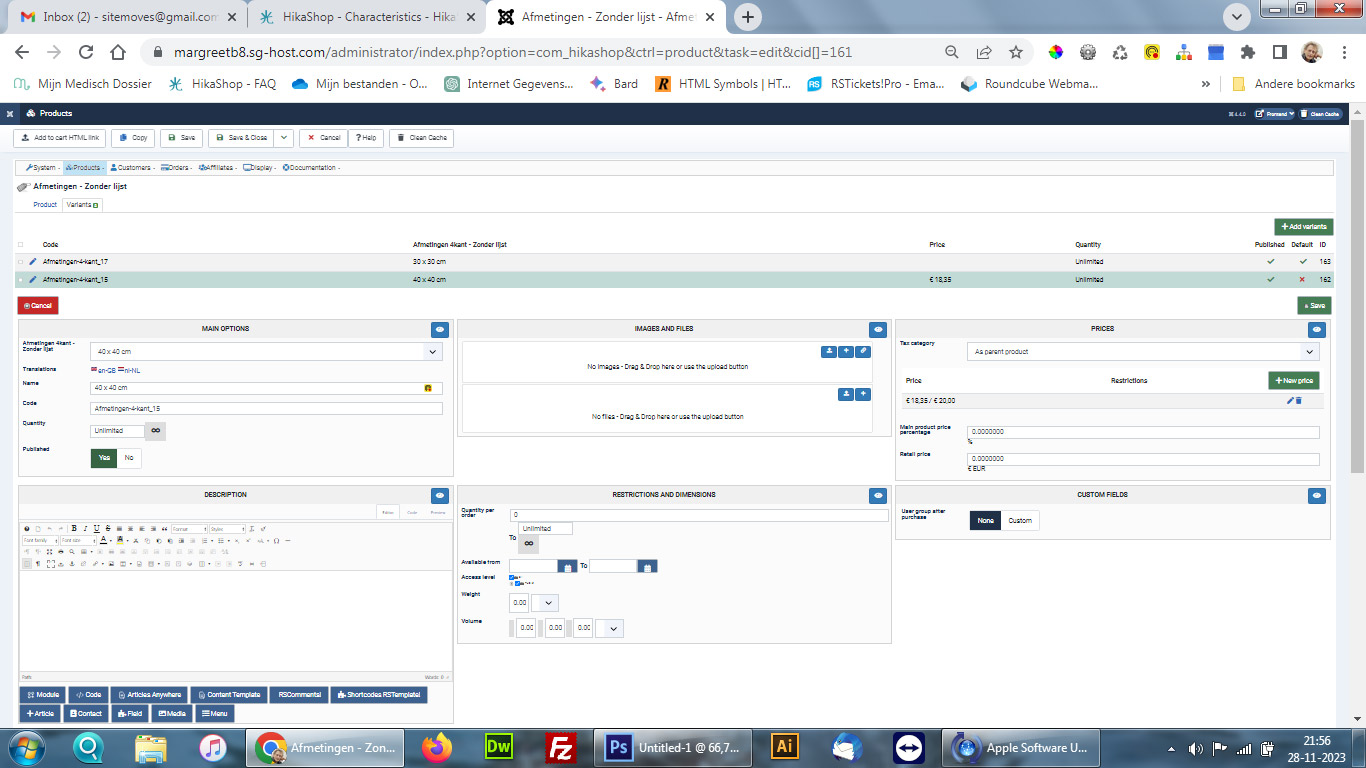

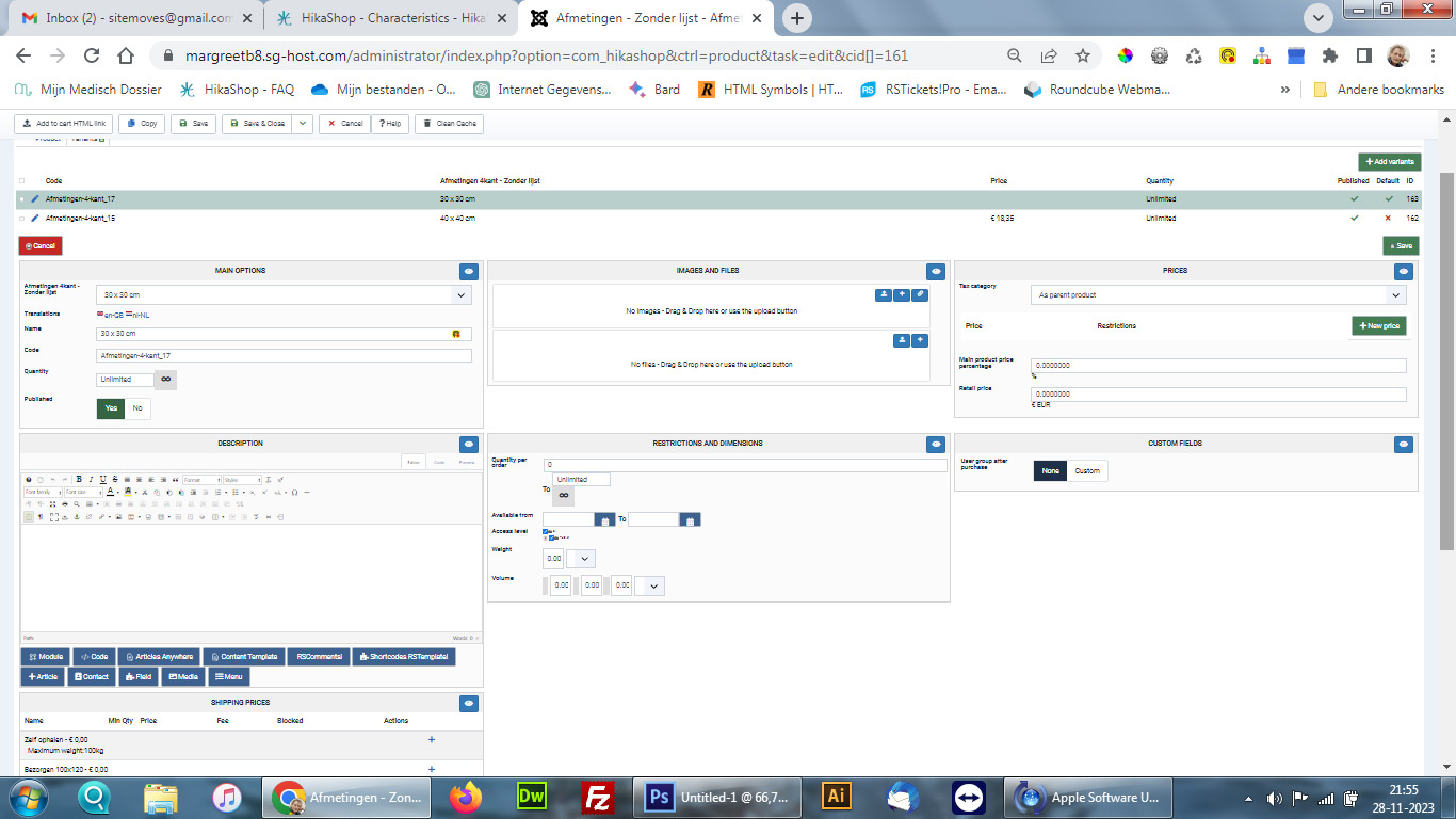

  • Posts: 56
2 years 8 months ago #357014
Here they are

  • Posts: 86050
2 years 8 months ago #357025
Thanks for the screenshots.
That's strange. Everything looks fine.
I guess I'll need a backend access and a FTP access in order to look into it. Could you please provide these via our contact form ?

2 years 8 months ago #357056
Thanks. I found the issue.
I had forgotten to check the setting "Maximum number of items in the cart" in your HikaShop configuration.
You set that to 1 so it's not possible to have both a main product and an option product at the same time in the cart and that's why the add to cart is being refused.
