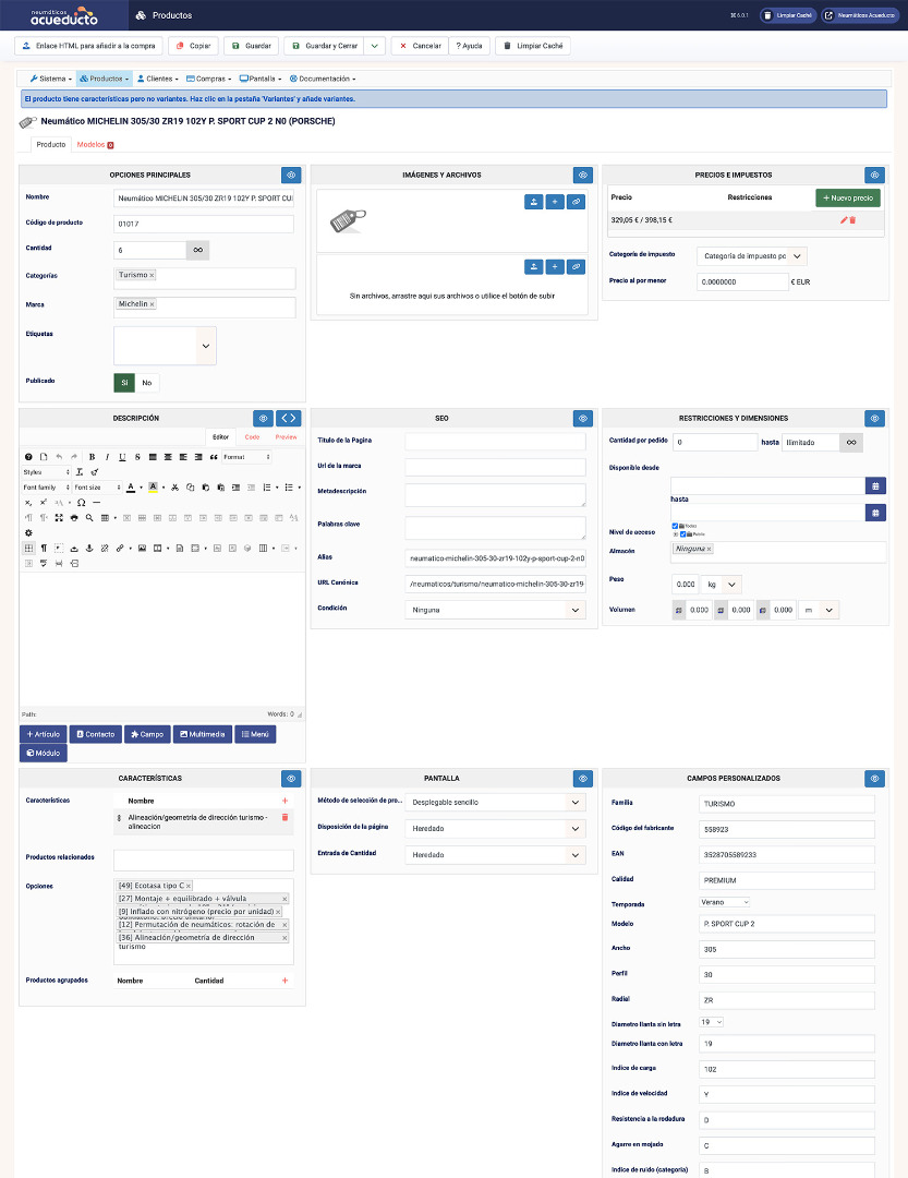

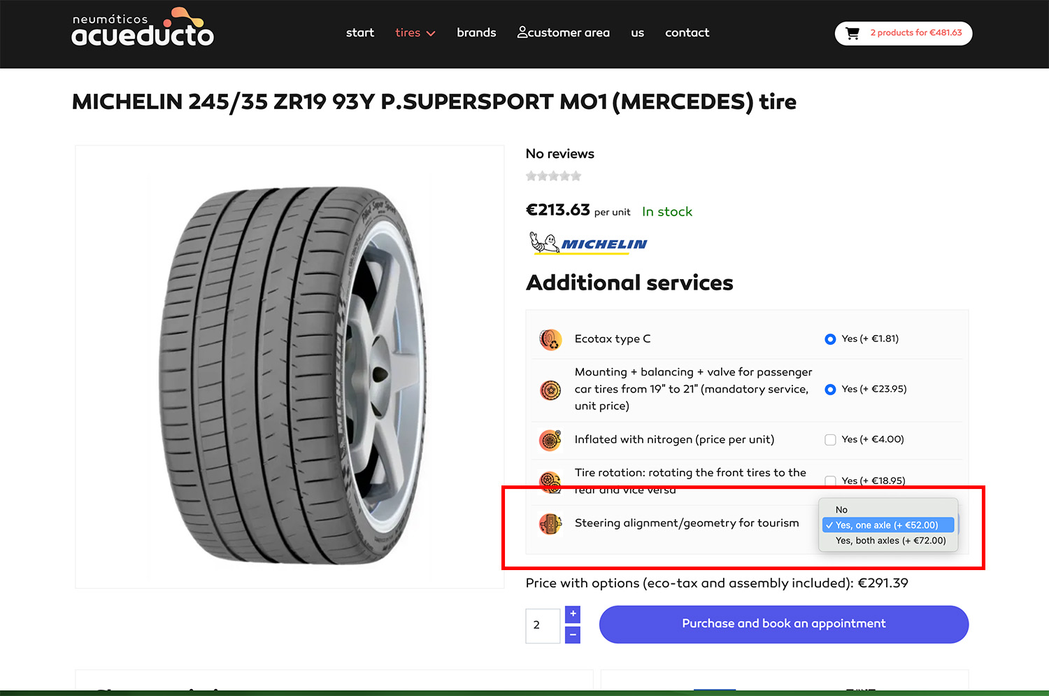

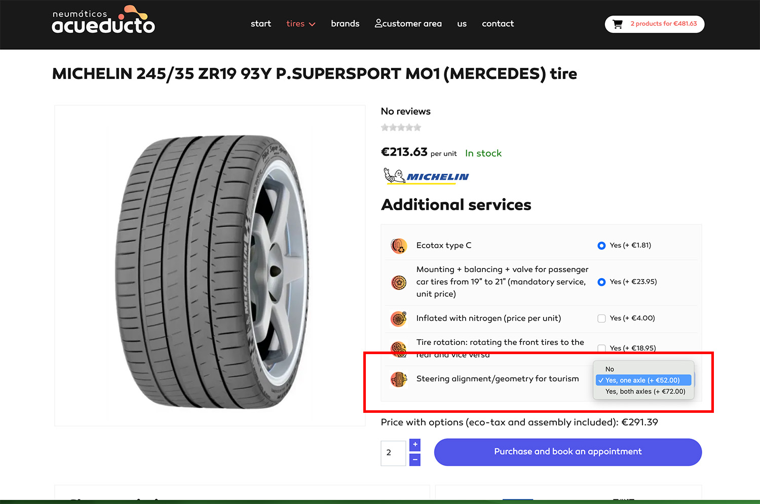

We have a tire shop configured with HikaShop where customers can purchase tires and additional services. Most services are charged per tire unit (mounting, nitrogen inflation, etc.), but we have one specific service that should be charged once per vehicle, regardless of tire quantity: "Steering alignment/geometry for passenger cars".

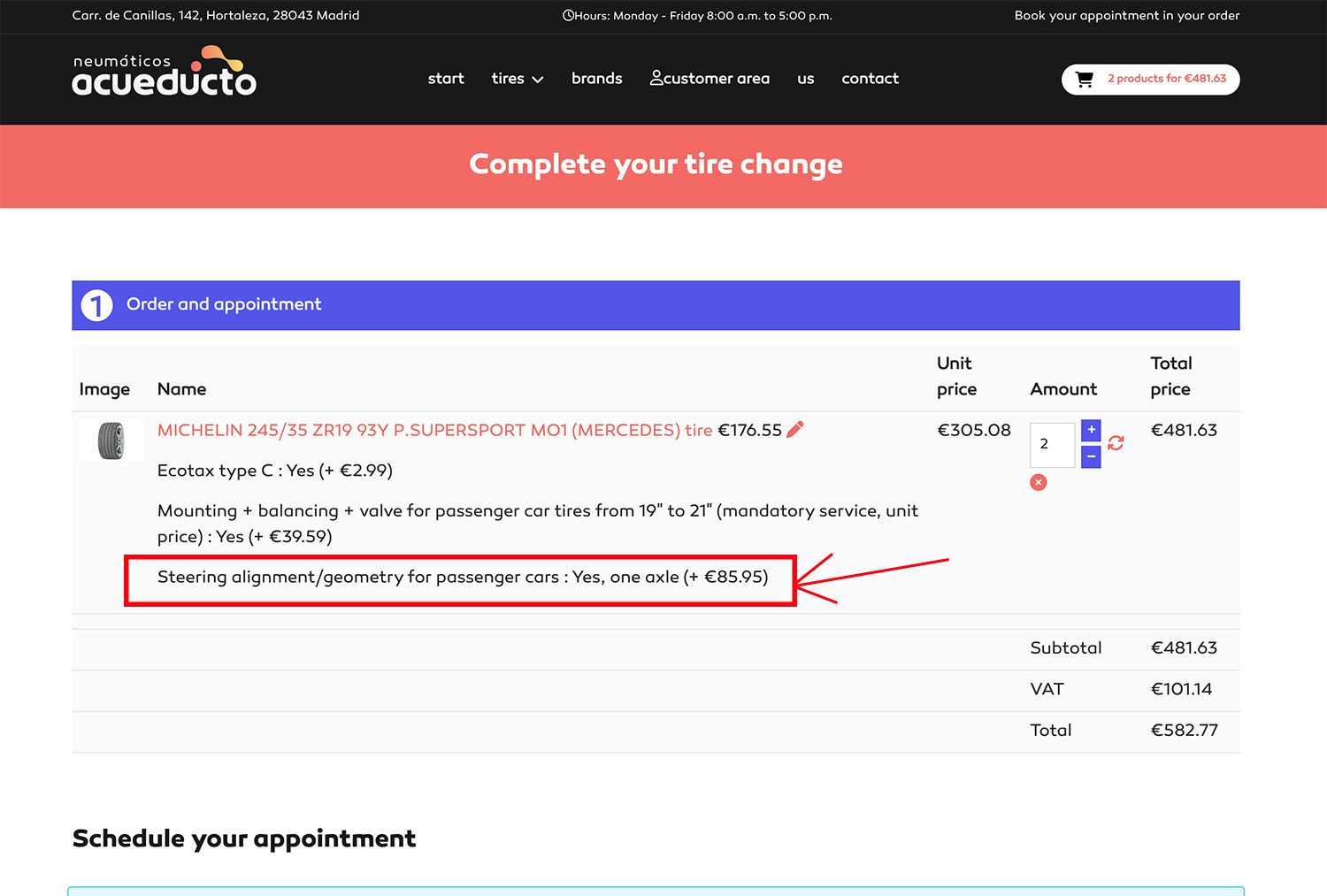

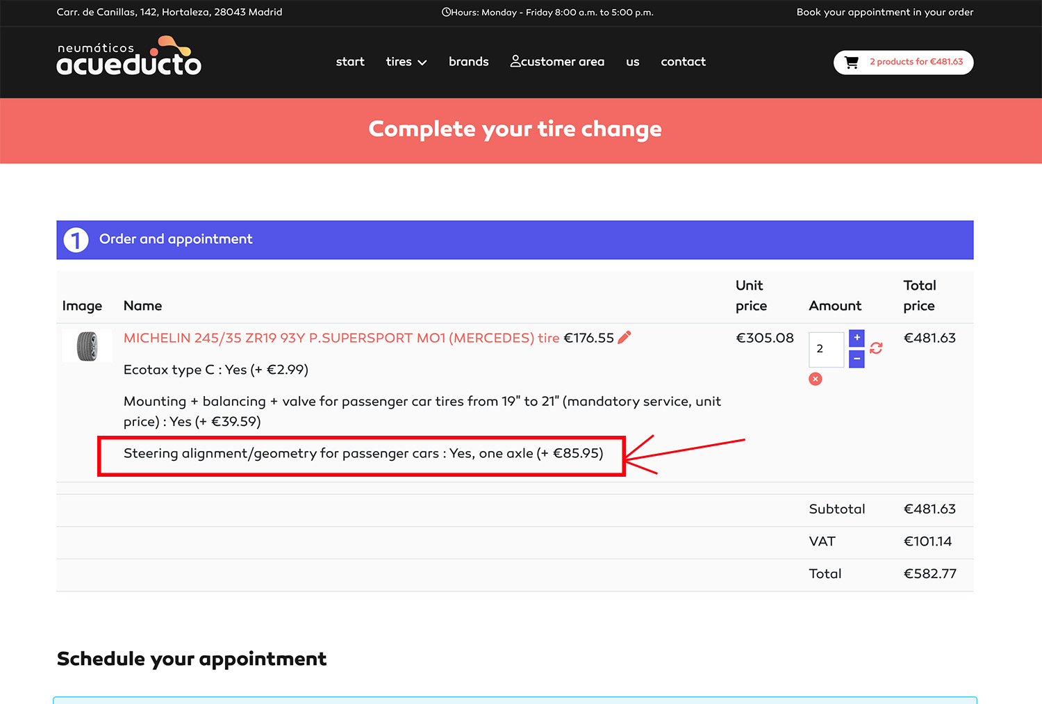

Current problem: This service is configured as a product characteristic, and when a customer adds 2 tires to cart and selects this optional service, the system multiplies it by 2 (85.95 € × 2 = 171.90 €), when it should only charge 85.95 € once, as this service is performed on the vehicle as a whole, not per individual tire.
What we need:
This service should remain optional (not mandatory)
It should be visible always, even when buying a single tire
When selected, it should add only 1 unit to cart, no matter how many tires are being purchased
All other services should continue working per tire unit as they do now
Question: How should we configure this service to charge it once per vehicle instead of multiplying by tire quantity? Should we use a different configuration method (option instead of characteristic, or separate product)?

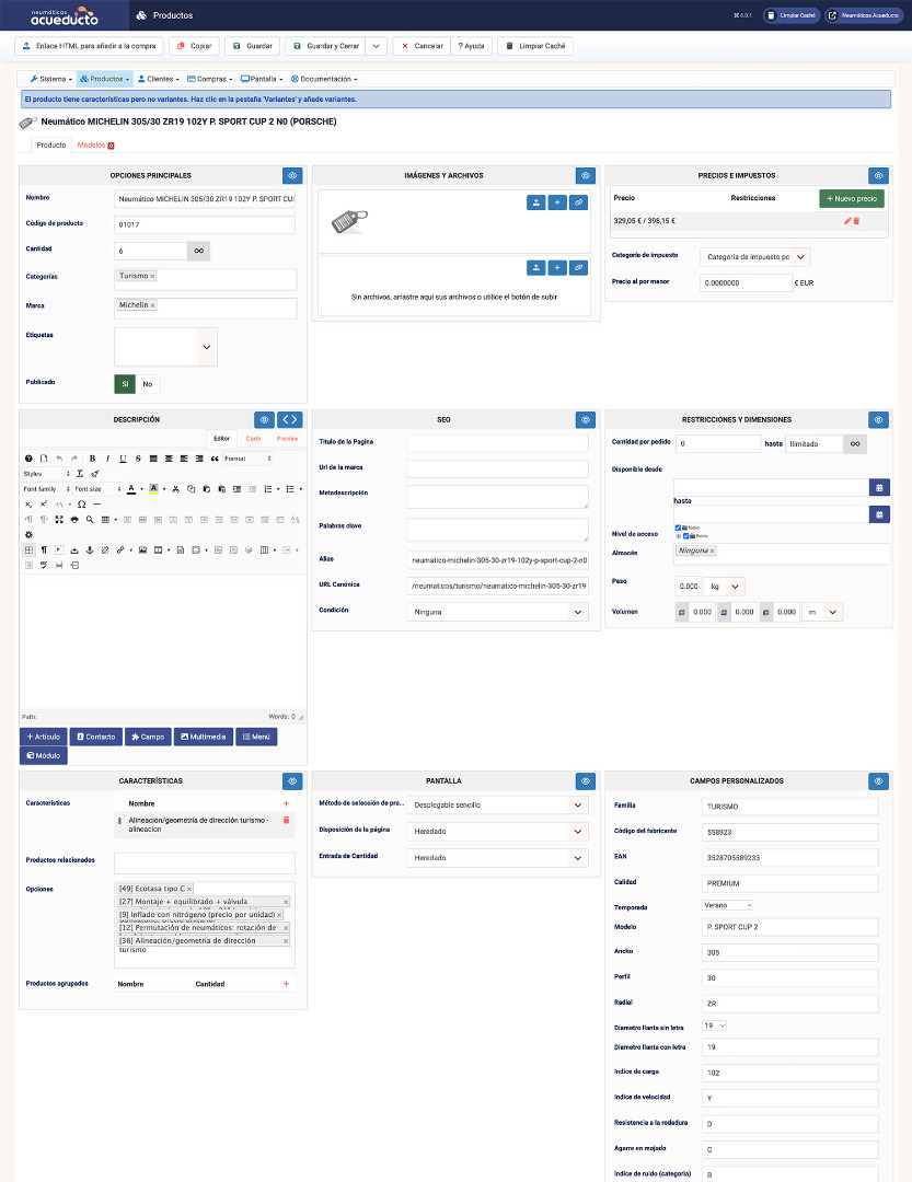

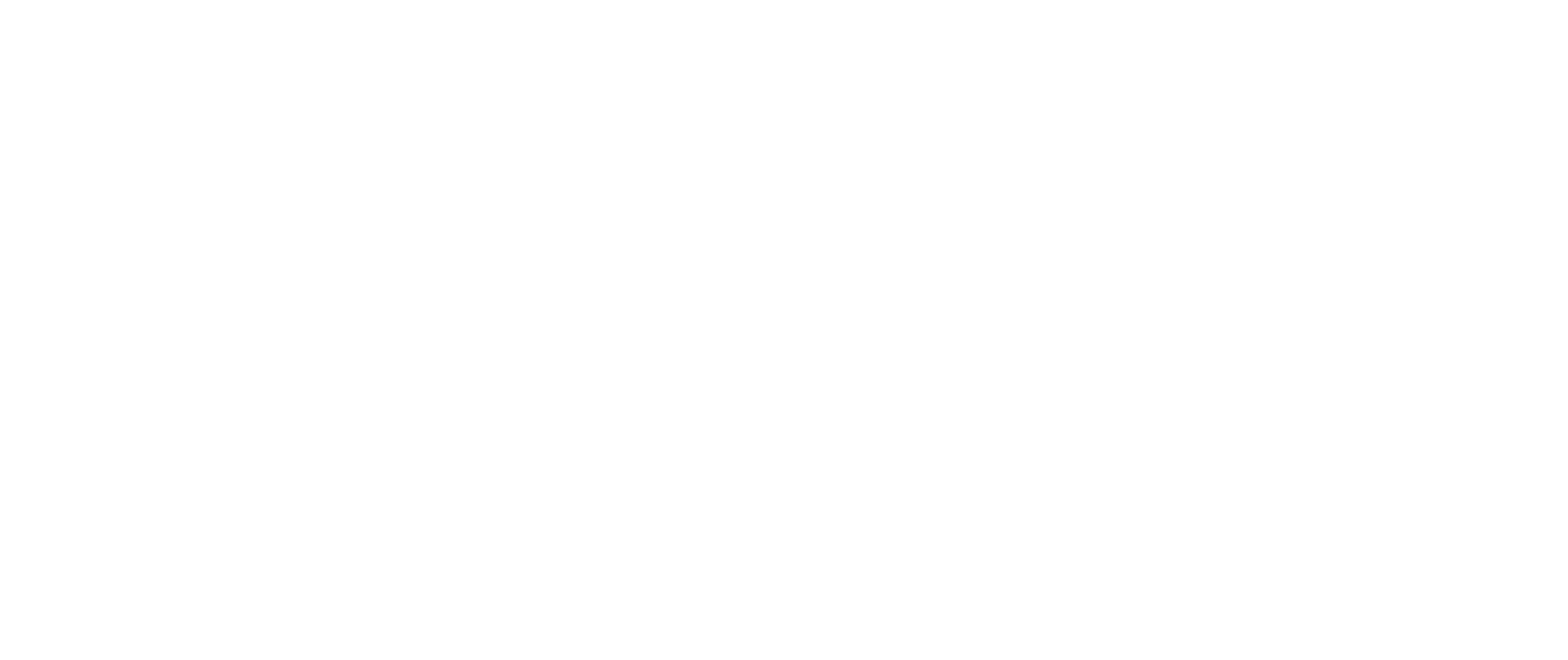

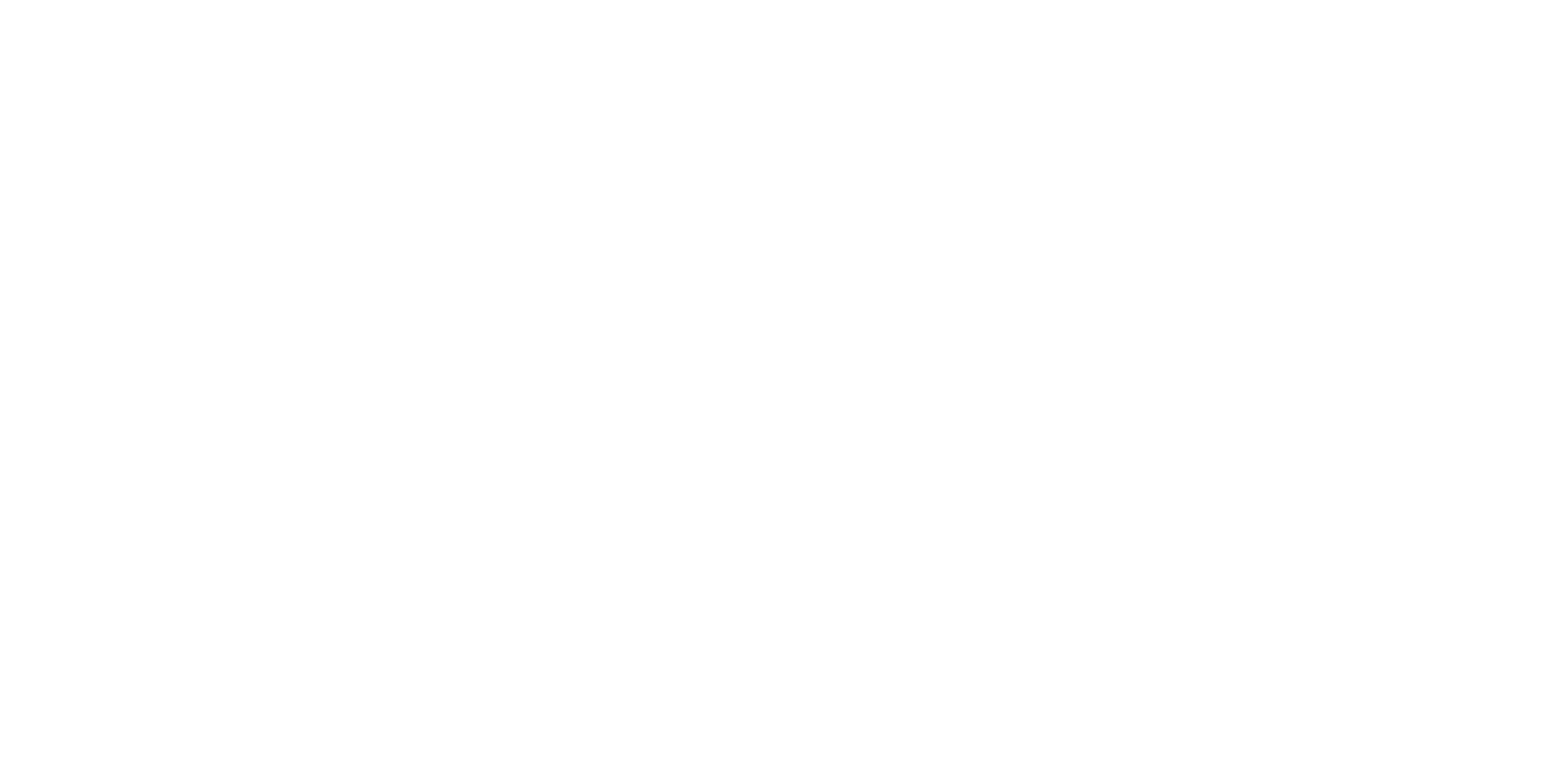

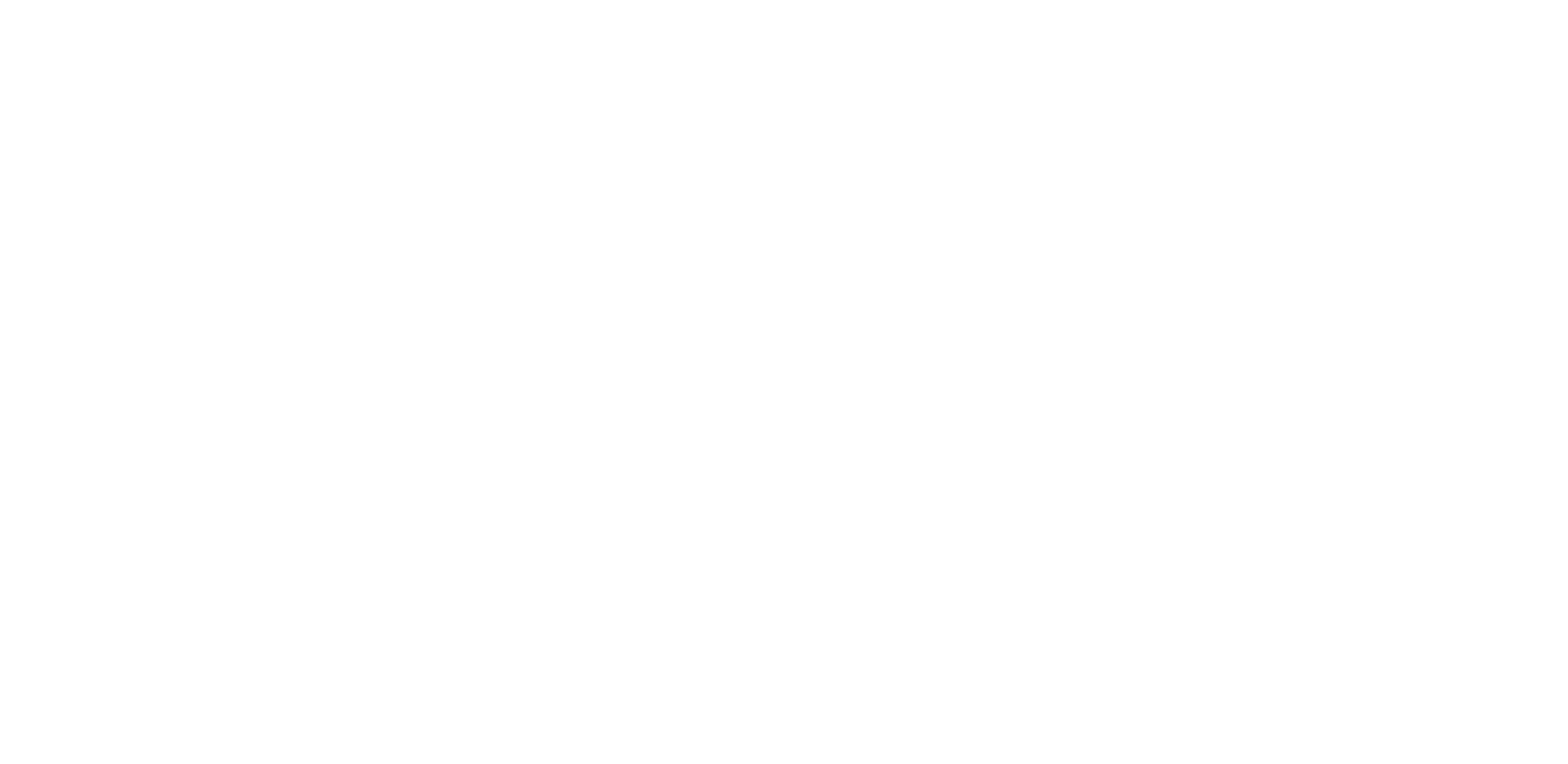

Please see attached screenshots:
Product frontend view showing the service
Cart showing the service multiplied by 2
Backend product configuration
Thank you for your assistance.

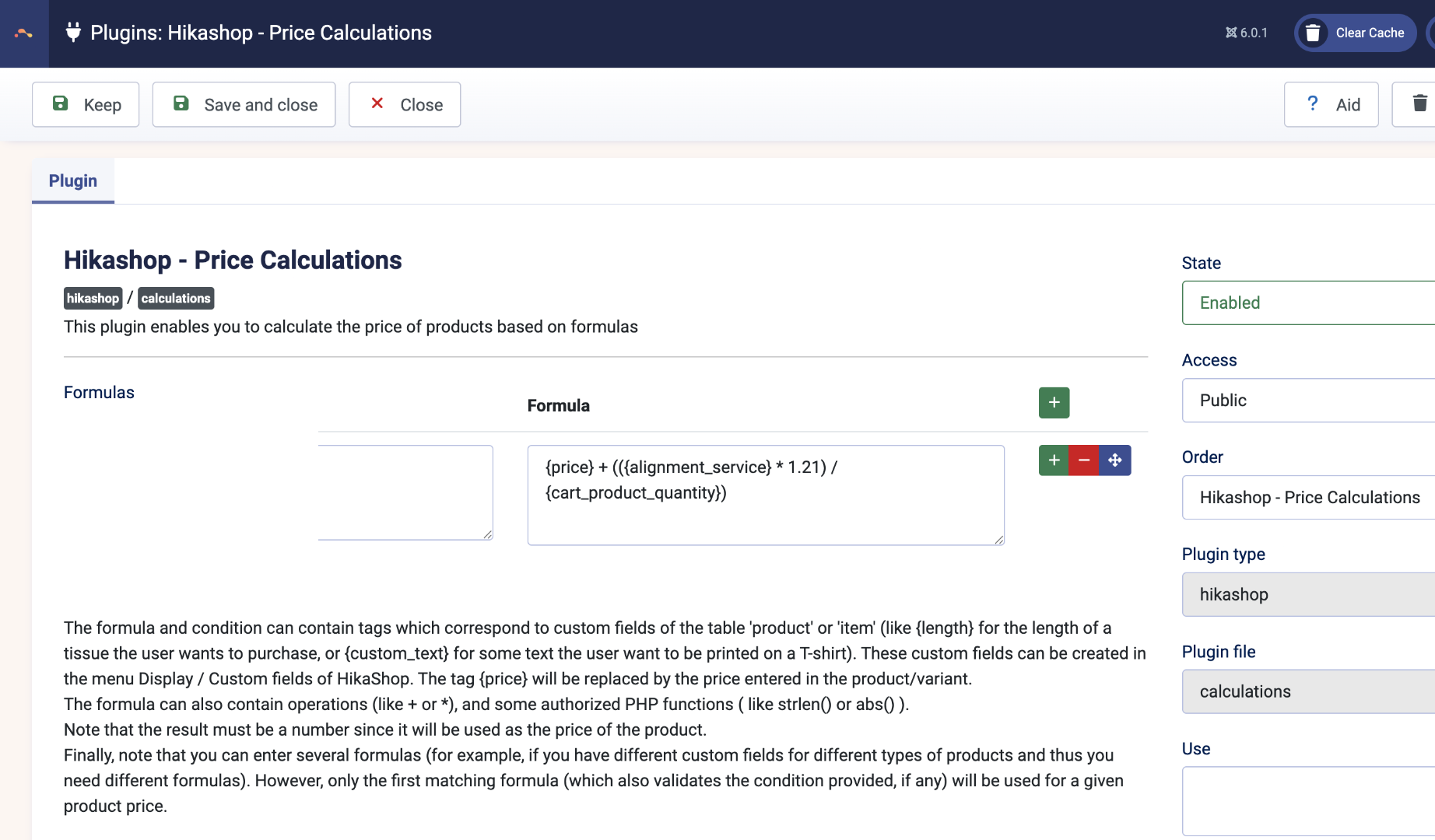

I'm using the Price Calculations plugin to add an optional alignment service to tire products. The formula uses a division operation to charge the service once per order (not per tire), but this is causing tax calculation inconsistencies.
We are using Hikashop: 6.1.1
Plugin formula: {price} + ({alignment_service} / {cart_product_quantity})

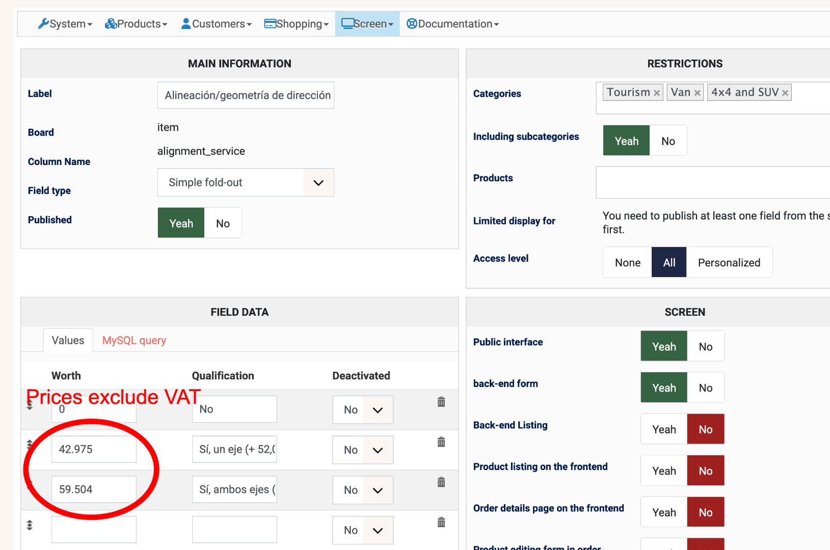

Custom field configuration:
Table: item
Column: alignment_service
Values: 0, 42.975, 72.00 (without tax)
Tax: 21% Spanish VAT
"Show prices with tax" = Yes

With 2 tires + alignment (value 42.975€):
If field value = 42.975€ (without tax):
Product page: 445.40€ (❌ missing ~4.51€ tax on alignment)
Should show: 449.91€
Checkout total: 899.82€ ✓ (correct)
Checkout unit price: 475.67€ (❌ should be 449.91€)
If field value = 52.01€ (with tax):
Product page: 449.91€ ✓ (correct)
Checkout total: 910.74€ (❌ tax applied twice, +10.92€)
Should be: 899.82€

plugin.png: Price Calculations plugin configuration
field.png: Custom field "alignment_service" configuration

The problem you're experiencing is due to how tax is being applied when using division in the formula. When you divide by {cart_product_quantity}, the tax calculation becomes inconsistent between the product page display and the checkout total.
Here's what's happening:
When "Show prices with tax" is enabled, the plugin applies tax to your custom field value (alignment_service) before it's used in the formula. But since you're dividing by quantity, the taxed amount gets divided, and then at checkout, the line total is calculated differently, causing the discrepancy.
Suggested workaround:
Try using the alignment value without tax (42.975€) in your custom field, and manually add the tax in the formula:
{price} + ({alignment_service} * 1.21 / {cart_product_quantity})
This way, the tax is applied to the full alignment amount before the division, which should give you consistent results.
Could you please test this and let us know if it resolves the discrepancy? If this works, we can look into adding better support for dynamic tax rates in the plugin, such as a {tax_rate} tag that would automatically use the product's tax rate.

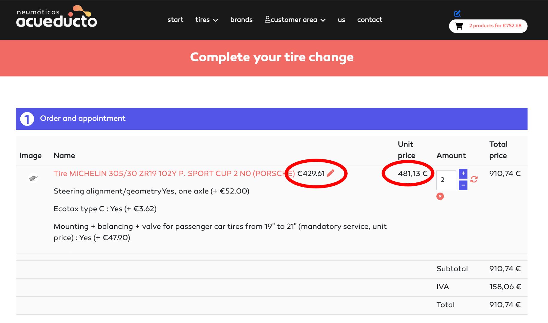

The change you suggested doesn't seem to affect the cart calculations at all. The product page calculations remain correct, but the cart hasn't changed from the previous version. Let me explain the issues I'm detecting in the cart:
The amount of 481,13 € comes from the following operation (all prices with VAT included):
481,13 € - 398,15 € (tire price) = 82,98 €
82,98 € - 47,90 € (mounting × 2) - 3,62 € (eco-tax × 2) = 31,46 €
31,46 € - 26,00 € (alignment / 2) = 5,46 €
These extra 5,46 € come from adding the alignment VAT twice: (52 × 21 / 100) / 2 = 5,46 €
So the alignment VAT is being duplicated.
Additionally, the prices marked with red circles (images in attachments) are very confusing not only for the user but also for us.
I would like to know if the product list in the cart table could be improved so that the unit price shown is for a single tire with its individual options, i.e., tire price + eco-tax + mounting, which in this case would be 423,91 €, and below it a line for alignment (a unit cost since it's per vehicle) of 52 €.
Ideally, the cart should look like this:
"Tire Title" + tire price (398,15 €) ... Unit price 423,91 € ... Qty 2 ... Total 847,82 €
Alignment/wheel geometry: Yes, one axle (+ 52,00 €) ... Unit price 52,00 € ... Qty 1 ... Total 52,00 €
Total ............................ 899,82 €
VAT .............................. 156,17 €
Amount without VAT ............... 743,65 €
I'm attaching screenshots of the current cart along with screenshots of the plugin configuration and the custom field.

Thank you for reporting this issue. We’ve looked into it today. The problem is relative complex and this lead us to add several things to the plugin. We've released just now a fix, among other things, in version 2.2.0 of the Price Calculations plugin.
THE PROBLEM:
When using division in formulas like {price} + ({alignment_service} / {cart_product_quantity}), the cart_product_quantity field was being incorrectly treated as a price and taxed, which broke the calculation.
THE SOLUTION:
The plugin now automatically detects fields that are clearly not prices (quantities, IDs, counts, etc.) and excludes them from taxation. This means your formula will now work correctly.
YOUR FORMULA:
Simply use: {price} + ({alignment_service} / {cart_product_quantity})
Make sure your alignment_service custom field stores the value WITHOUT tax (€42.975 in your case). The plugin will:
1. Tax the alignment_service value (€42.975 -> €52)
2. NOT tax the cart_product_quantity (stays as 2)
3. Calculate: €423.91 + (€52 / 2) = €449.91 per tire
4. Cart total: €449.91 * 2 = €899.82

I didn't explained myself clearly.
I don't need to add additional fees to the cart—the Cart Fee plugin doesn't solve my problem.
My problem is with the cart display.
Current situation:
Unit price shown: 481,13 €
Quantity: 2
Total: 962,26 €
But the math doesn't add up: 481,13 € × 2 ≠ 962,26 €
What I need:
Unit price shown: 449,91 € (the actual price of 1 tire with all its services)
Quantity: 2
Total: 899,82 €
And the options (Eco-tax, Mounting, Alignment) displayed as separate rows in the table instead of text below the product, so the customer can clearly see what they're paying for.
Does this require modifying the cart template (/templates/xxx/html/com_hikashop/checkout/cart.php)?

Yes, in that case, you'll have to customize the display with a view override:
Note that it is the view file checkout / show_block_cart.php that you want to modify.
