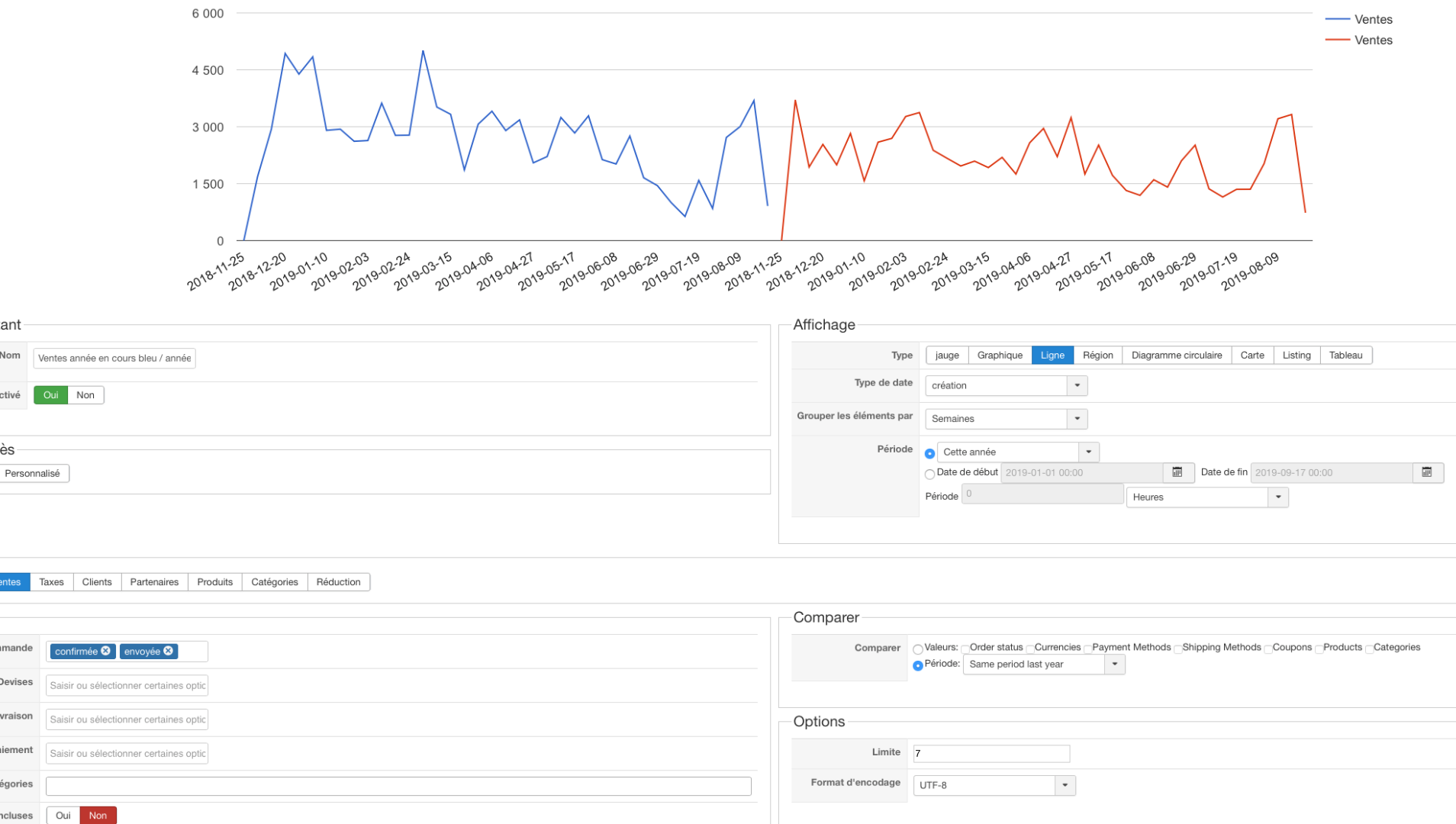

as the "column type" display has been removed, I have been using "line display" reports for a while.
The line display reports used to show 2 lines (blue and red) on the same chart, as the "graph type" does.
Now my "line display" reports show 2 separated side-by-side lines, each one on its own chart (see attachement).
Is it a way to have the blue and red lines on the same chart, like the "line display" was before ? ... easier to compare sales, in a glance, over 2 period of time.
Thanks !

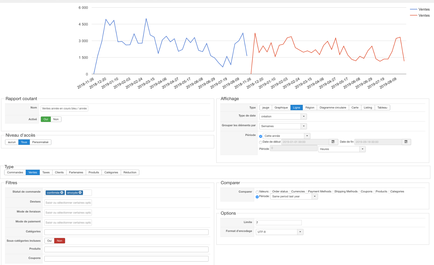

In order to better help you can you provide your report configuration page via a screenshot ?
  • Posts: 70
6 years 11 months ago #311059
here is the screenshot :
  • Posts: 86113
  • Thank you received: 14210
6 years 11 months ago #311065
Thank you for your feedback.
This stems from the changes we had to make to display properly the dates with the Hijri Shamsi calendar:
www.hikashop.com/forum/import-export-csv...p/308376.html#308709
Because of that calendar if we want to display properly the date, we have to add the year (before the year was not specified).
And because we now specify the year in the date, the lines are now separated where they were side by side before as the date value was the same.
So I was able to reproduce the problem and improved the patch I had made for the other thread so that it doesn't cause a problem here.
Download the install package of the 4.2.1 again on our website and install it on yours and you'll get the patch.
The following user(s) said Thank You: Thierry H.

The date format will revert to the old way there was to display them with the patch.
So if you were happy with what you had before, you'll get just that.

6 years 11 months ago #311129
You made my day !
The line display is fine now. Thank you Nicolas !
