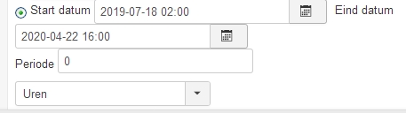

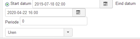

I have a report with start date 2019-07-18 and end date 2020-04-22

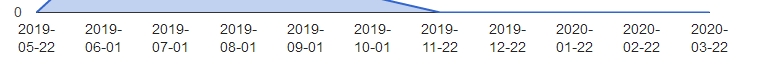

the graph x-axis labels start with 2019-05-22 (not 2019-07-18)
the next label is not on 6-22 but on 6-1
then it continues on first of the month until month 11. it ends with 2020-03-22
the graph then shows no orders for 2019-11-22 and only one order for 2019-10-1
there were more orders. but it somehow bundles those in month 9.

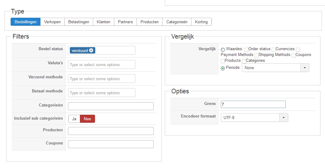

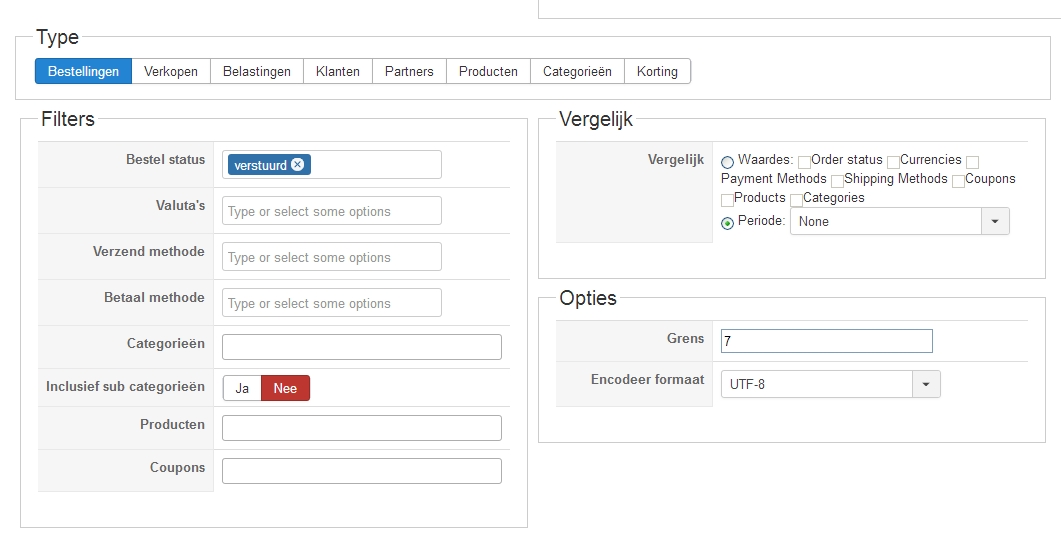

other reports settings:
- date type : created
- group by month
- type : orders with filter : status = shipped
(see screenshot 21 and 22)

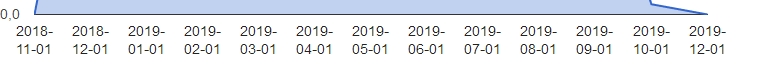

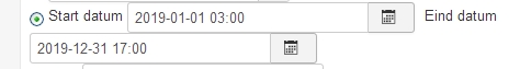

when I change the settings to start date 2019-01-01 and end date 2019-12-31 the report sstarts 2 months earlier and ends one month early. and it lacks month 10 all together.
(screenshot 23 and 24)

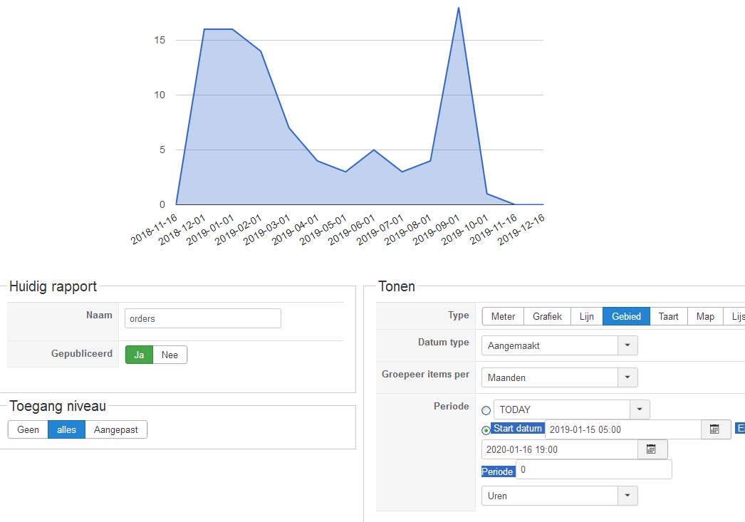

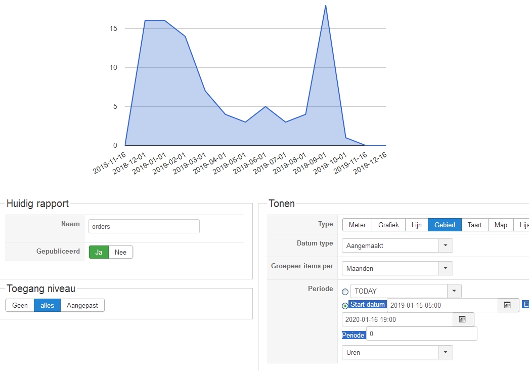

6 years 10 months ago #312926
as you can see start date is 1/15 in settings while it starts 11/16
then it starts display periods every first of the month up to this month and it stops a month early.
