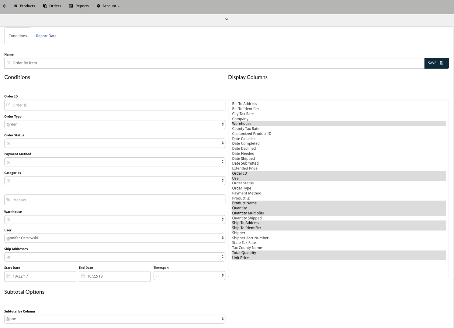

We need to create a report with the following information for internal reporting. I've tried doing this in the HikaShop Reports but can't seem to get it how we need it. I've also looked at the customer order history, but this doesn't have the ability to filter by date range or export or show products ordered.
What we need is a report that shows what products a customer is ordering in a specific date range.
Here is an example:
Select a customer
Select a date range
Create a report for the selected customer and date range that would include the following fields:
Item#
Item Name
Quantity Ordered
Amount paid
It would also be nice to filter by order status.
We would need to download this data into a spreadsheet. What would be the best way to go about this?

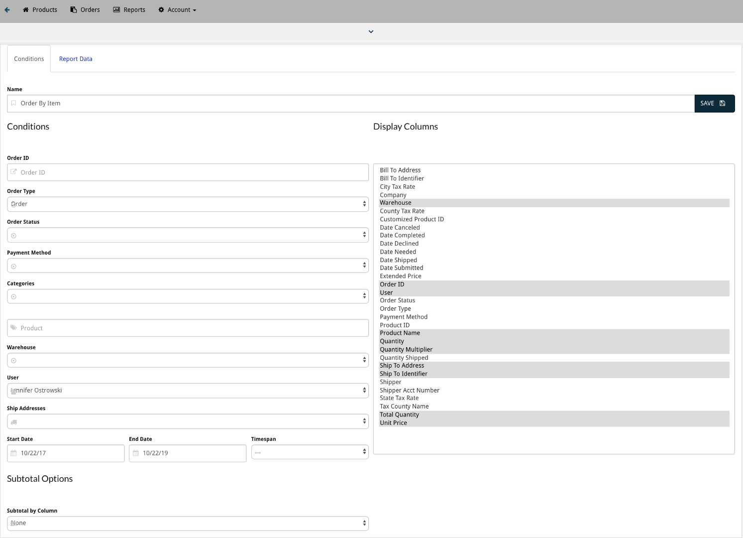

By way of example, attached is another ecommerce system we use that has this reporting capability.

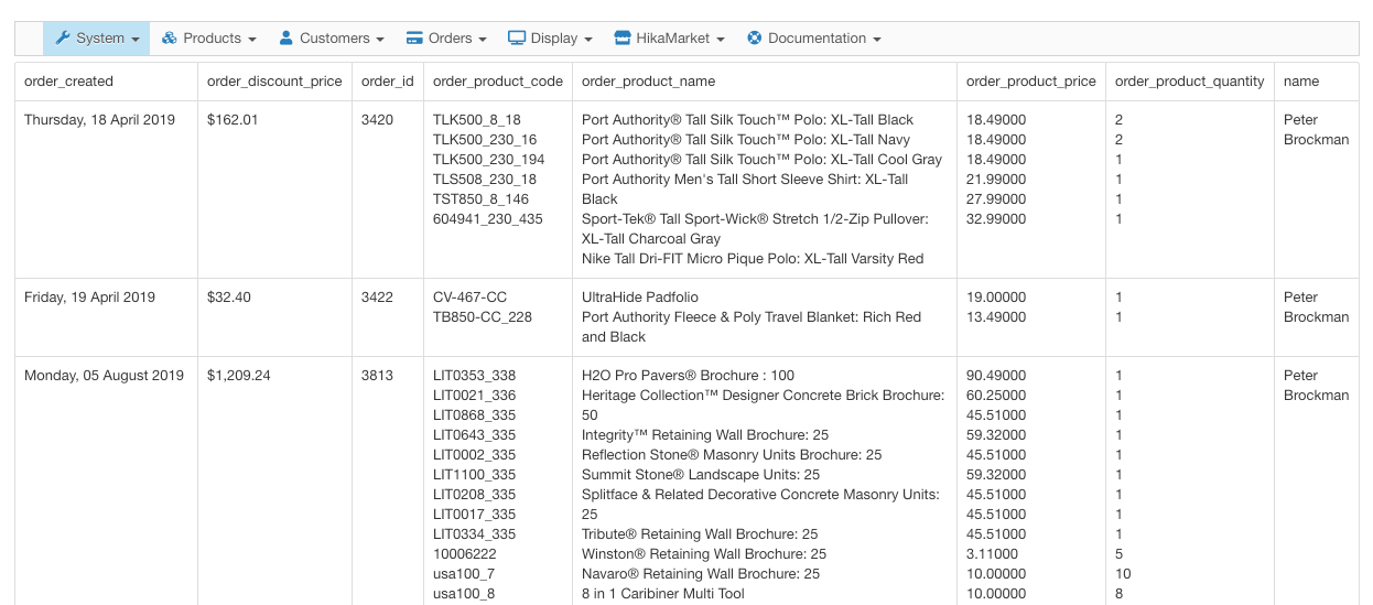

6 years 10 months ago #313272

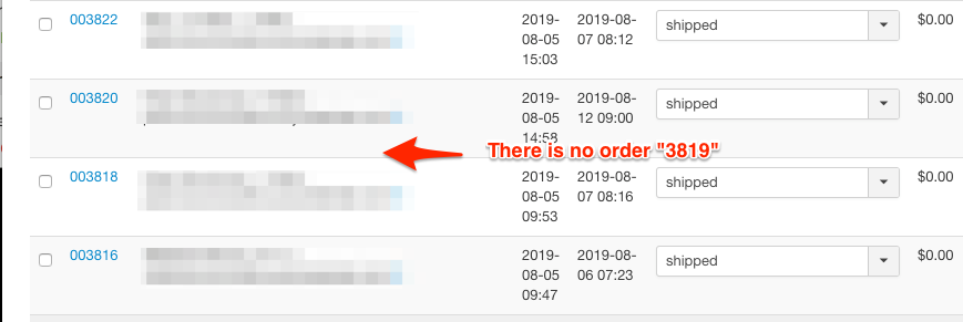

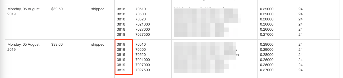

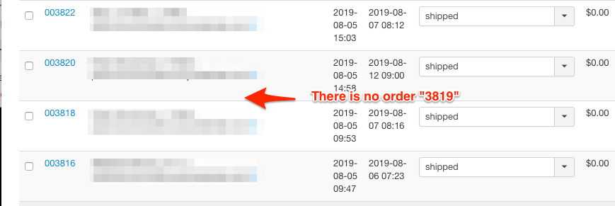

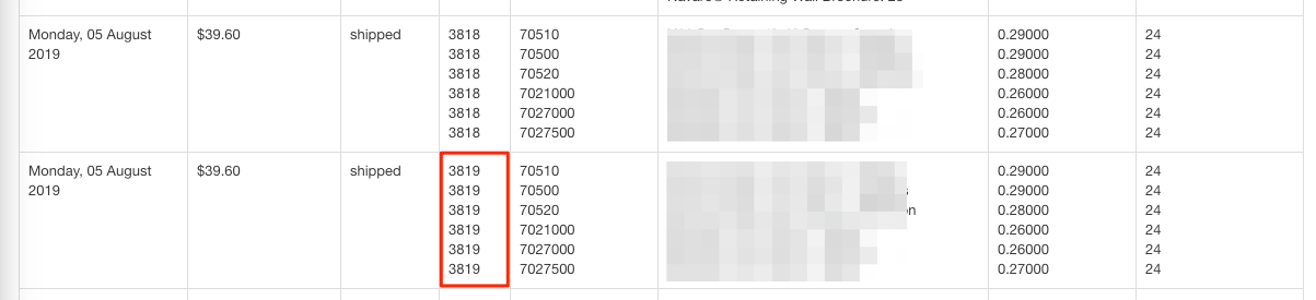

Thank you. We were able to pull the data via massactions following your example. But there seems to be a problem with the way the data is listed.
There are duplications listed with order numbers that do not exist.
For example,
Orders 3818 and 3819 are the same in the massaction reporrt. However, there is no order 3819. That is an order that was canceled and deleted. Same with 3820 and 3821
3822 and 3823
etc.
It appears that if an order is removed, it shows up incorrectly in the massaction reports as a duplicate of the previous order.
How do we fix this?
Images attached for reference.
  • Posts: 86217
  • Thank you received: 14222
6 years 10 months ago #313274
This is probably a "subsale" generated by HikaMarket. If you check the hikashop_order table in your database, you should have an entry with the id 3819. But its order_type should be different from "sale".
So what you want to do is add another filter on the order_type column being equal to sale to skip HikaMarket's subsales in your reporting.

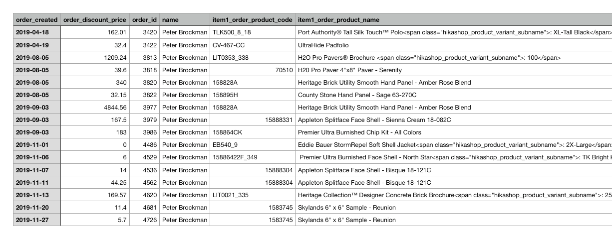

When set to "display the results" things look good.
However, if setting to "export to csv" with the same selections the resulting file is strange. Many extra columns are added and it is almost impossible to display or manipulate in any meaningful way. Is there a way to have the exported file look like what is displayed to the screen?

6 years 9 months ago #313863

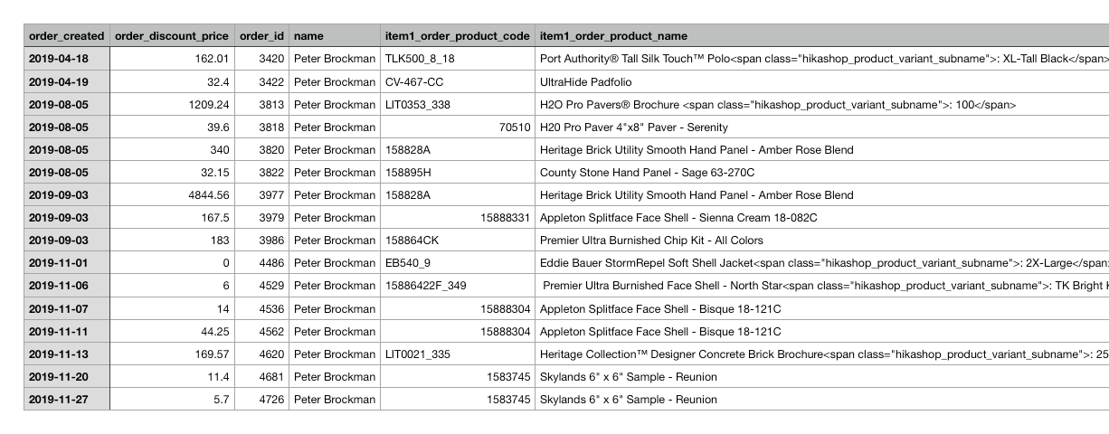

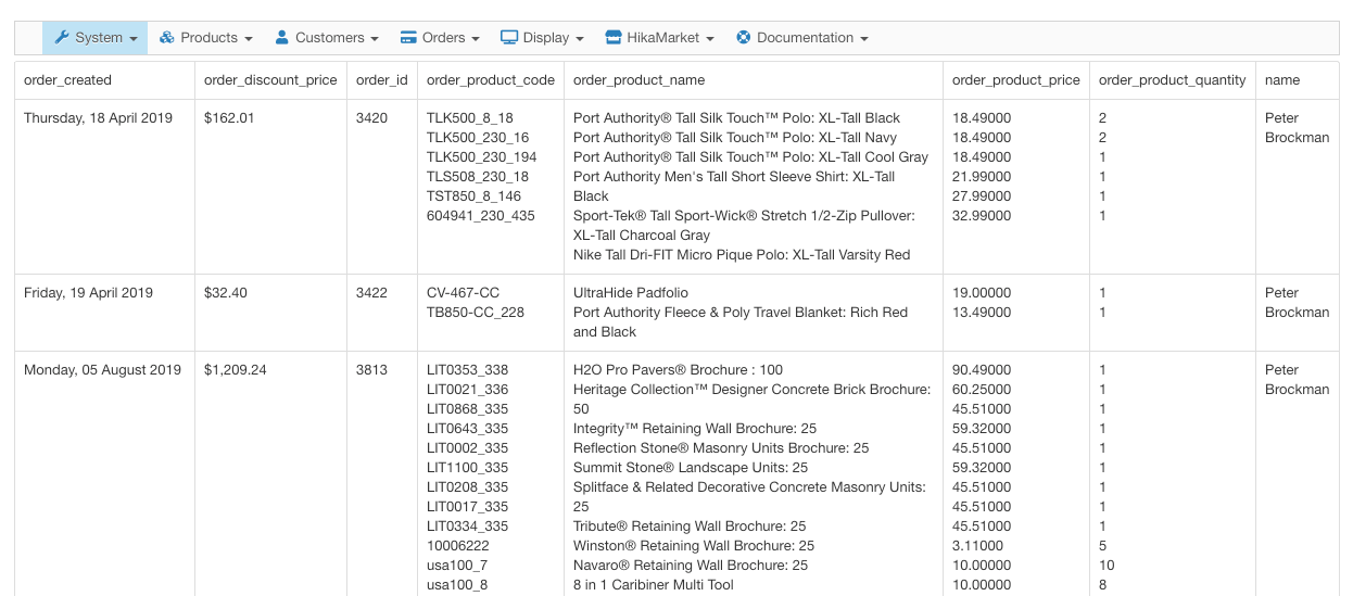

Here is a screenshot of the difference.
Selections are exactly the same for each. The display to screen is good. But the csv is unusable. Is there a way to make the csv export be more like the display version?
Specifically: The display version has all the items from each order displayed together in a single column. This results in 8 total columns displayed. The csv version has each item on an order spread out into thier own columns. This results in columns all the way out to "IU" (over 200 columns).

6 years 9 months ago #313872
There is no option for that. It's normal that the products information is split into different columns in the CSV exports.
Or it could be made into different lines, but then you would have one line per order per product so it wouldn't be anymore an export of orders but an export of products of orders.
