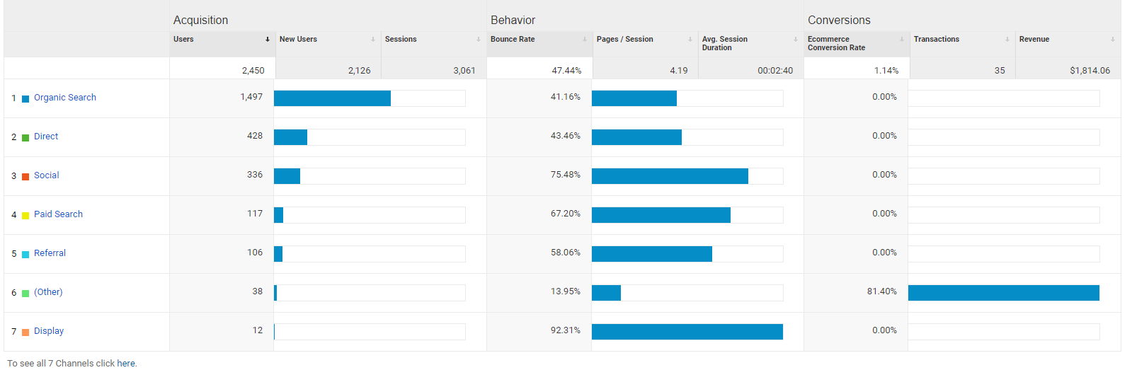

Description of problem:

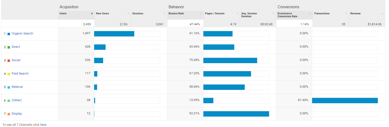

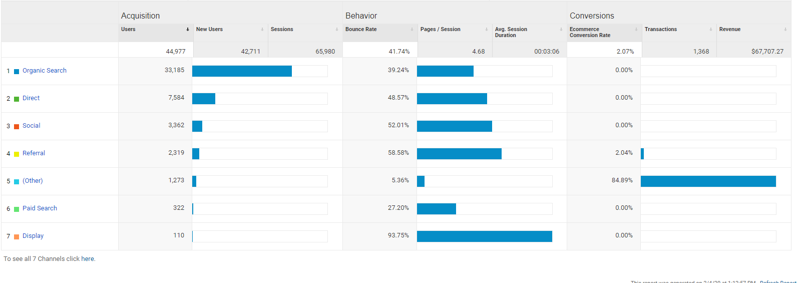

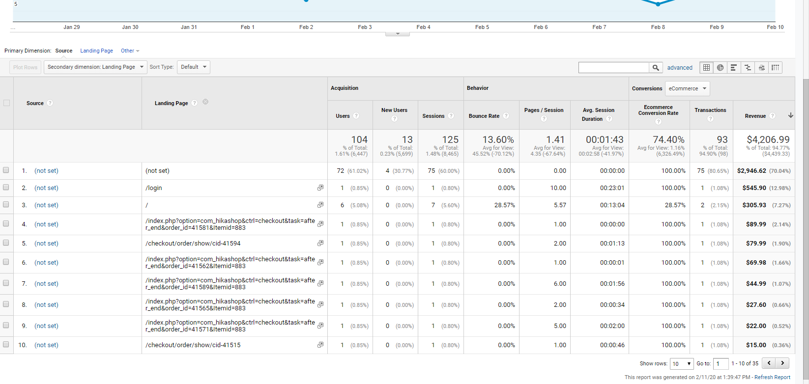

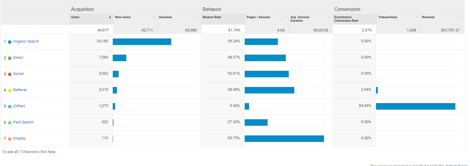

Google analytics reporting lumps all sales on website into the "Other" category. Upon further inspection, 99% of these are logged as "(not set)", implying there's either a lot of users using ad blocker, something is breaking in the direct call or there's some other thing going on with our checkout or GA that's preventing the correct logging.
Screenshot of data logged in GA:

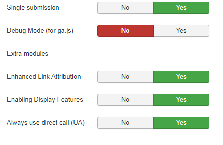

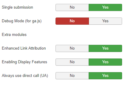

Screenshot of Hikashop GA plugin:
Most other statistics on referral traffic to the site are being tracked properly. The only delta seems to be the actual transactions. E.g., our facebook pixel tracks all traffic from watching ads or viewing our facebook page that get funneled to our website and converts to a sale. This accounts for a large number of sales on our website. By this logic, we should have a large percentage of transactions from Facebook. However, we do not.
Any help with this issue or things i should check to T/S would be appreciated.

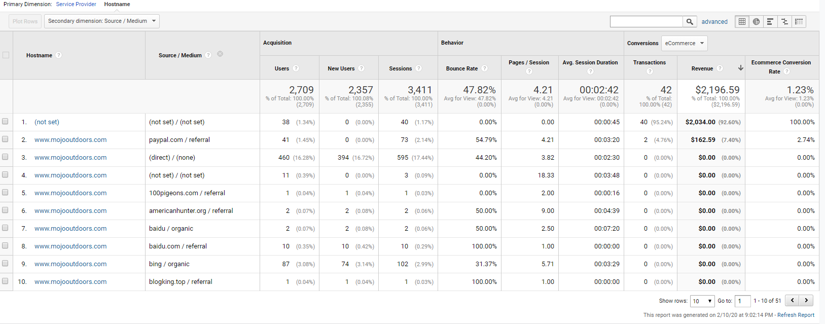

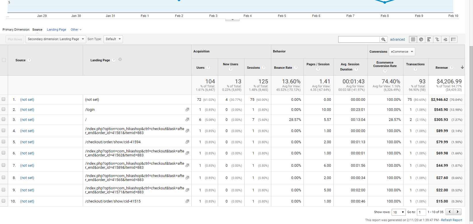

Also, here's what shows in the most recent order in the hikashop_order table in the order_payment_params column:
O:8:"stdClass":1:{s:12:"analytics_ga";s:44:"{"uuid":"484801840.1581374906","ul":"en-us"}";}

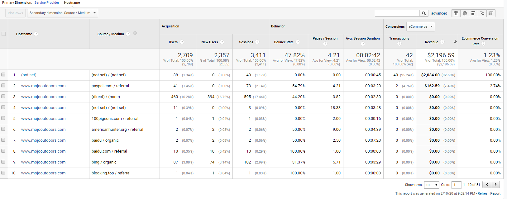

Not sure what to make of it. As i drilled down further, it appears that most of the revenue is coming from a (not set) hostname, which doesn't seem to be the ideal case. 40 of the 42 transactions over the last 5 days shows to have a hostname of (not set) which implies something isn't properly sent/logged in hikashop?
Also, it's a huge concern, but the other two transactions (2/42) are showing up with referral of paypal.com and not the actual referrer.
I can provide backend credentials or logs if that helps.
Thanks,
Holden

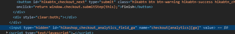

The order_params appear to be populating, but i only see
<input type="hidden" id="hikashop_checkout_analytics_field_ga" name="checkout[analytics][ga]" value="{"uuid":"1339775496.1544826346","ul":"en-us"}">
Last edit: 6 years 7 months ago by mojooutdoors-holden.

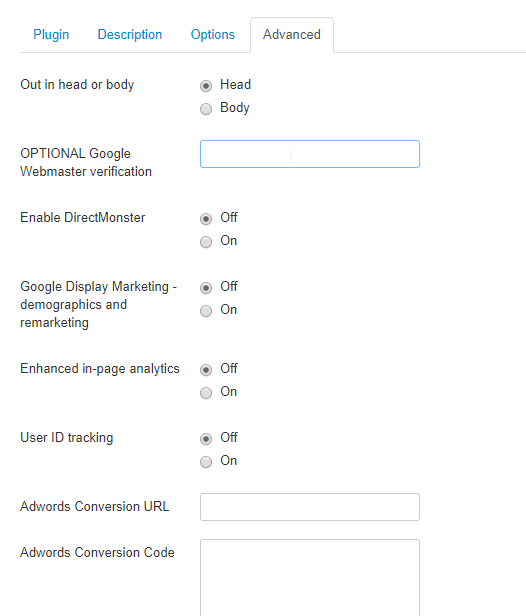

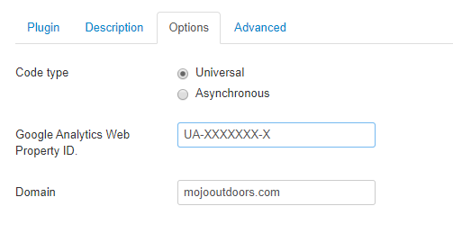

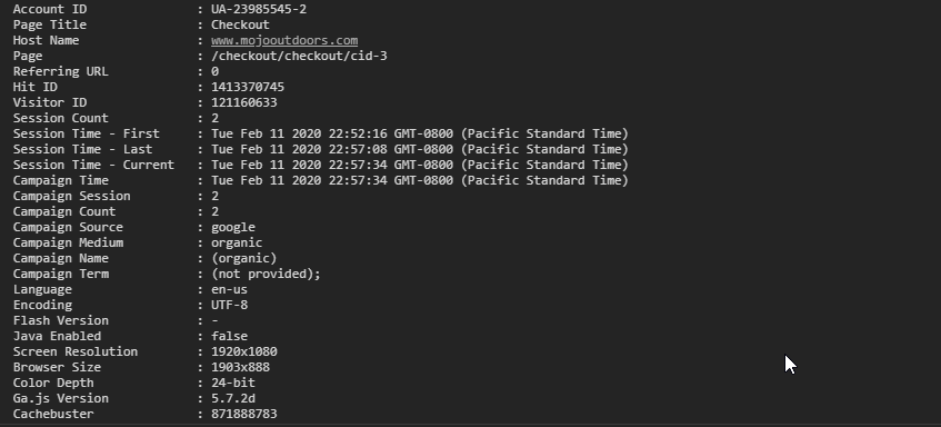

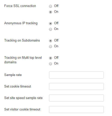

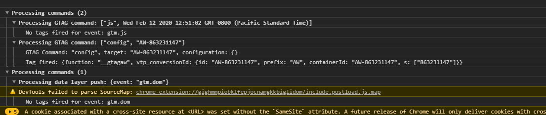

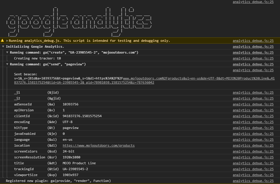

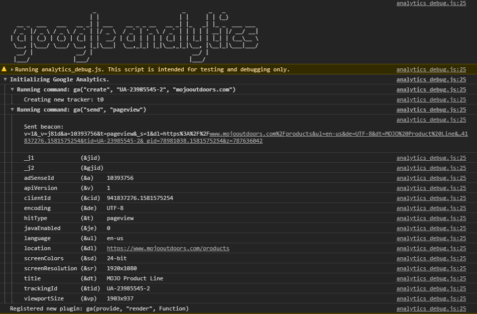

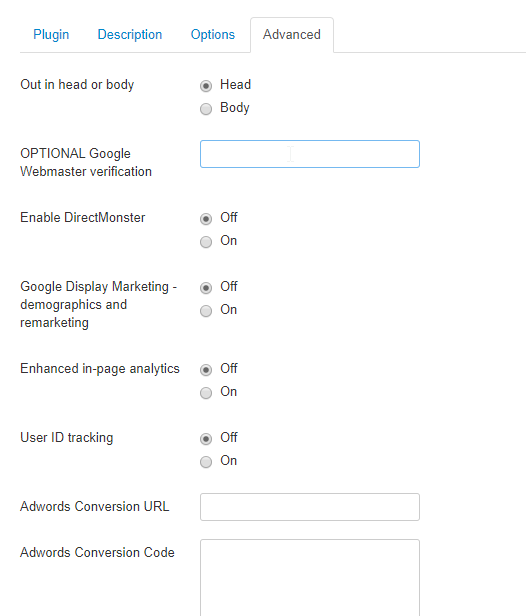

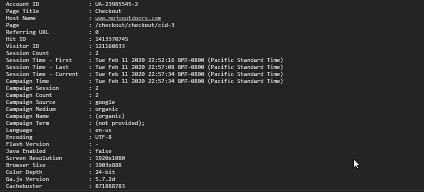

After some further investigation, i noticed my current GA plugin wasn't reporting the campaign, source, etc. properly. I unpublished the current one (Google Analytics Pro by Peter Bui) and reverted back to the Nice google analytics plugin.
After using the google analytics debugger, the campaign, source, etc. seems to be showing properly. However, after this change, the order_params are now missing (traded one problem for another).
While this did not fix the problem, it at least shows the behavior can be changed through the GA plugin. Maybe there's some conflict in my Hikashop GA plugin settings? I'm using universal with the following settings:
GA analytics Pro by Peter Bui settings:
Please let me know if you need any further data.

Since you have the direct call forced, after the payment a cURL request is sent to GA by the plugin with the information of the order along with the utm parameters it found in the order if any.
In that case, the link between the customer and that cURL request is lost since GA cannot link the user in his browser with his cookies and the cURL request on the server side.
To b able to keep the link between the too, the only solution I know of is to turn off the direct call so that a javascript code is run on the customer's browser after he comes back on your website on the thank you page.
That's actually done by plugin but it requires that you use the default thank you page of Hikashop and that the customer actually goes back on the website after the payment which might not be the case. And it won't work either for orders confirmed from the backend. So it's far from perfect. And I don't know any ways to be able to pass the information of the user to the direct call made with curl on the server side.
I searched a lot online but couldn't come up with any other solution.

6 years 7 months ago #315681
Google and most other search engines are automatically tagged by GA for organic and GA should know that the user accessed the website directly (bookmark or typing URL in browser). UTM parameters in this case are not necessary (according to GA docs). For social, referrer, ads, etc., UTM parameters must be present for GA to properly assign each session/pageview/conversion.
With that being said, I'm not exactly sure how GA tags as organic or direct but it appears this information is lost either as soon as the user lands on our website (e.g., clicking google search result or typing www.mojooutdoors.com in browser). I've done these two tests multiple times and cannot see organic or direct as source after the purchase is made.

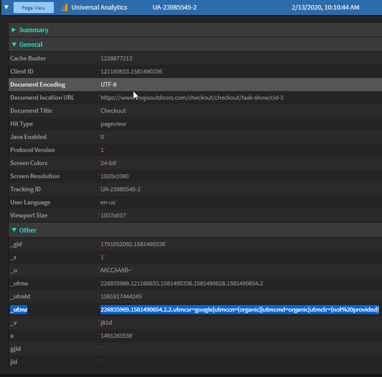

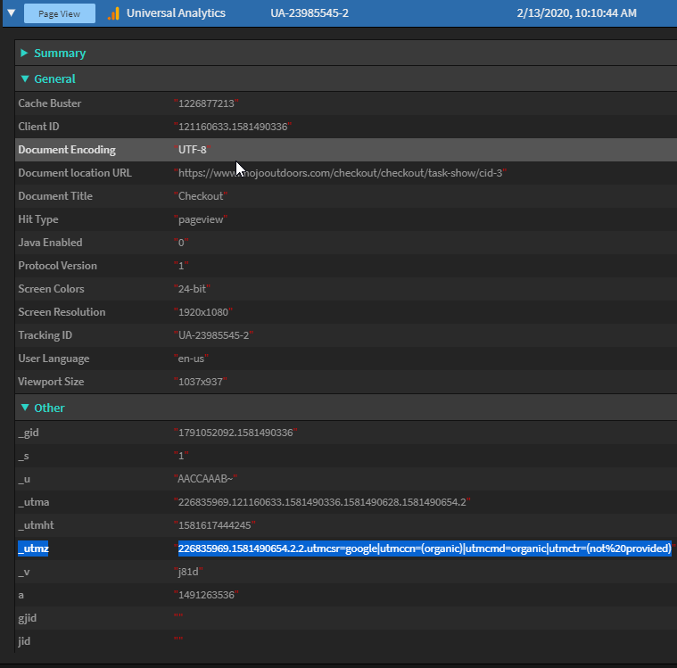

After speaking with Google Analytics rep and seeing what each piece of the GIF request that is sent back to GA, it appears that the campaign, source, and medium values are stored within the 'utmz' variable.
__utmz identifies traffic sources, campaign, medium, etc.:
http://springest.io/anatomy-of-google-analytics-cookies
An example from our website using omnibug plugin for chrome:
In this case, i have accessed the product via google search and it is properly identifying as (organic), but this info is not being passed back to GA after checkout is complete (from Hikashop side). Not entirely sure how you guys handle passing the data back to GA. I see in the plugin file that you look for utm_source, utm_campaign, etc. but not for the other utm parameters to pull this information. Is it possible that the hikashop plugin is overwriting the already collected utm parameters?
I can see with omnibug that even after redirect back to website from paypal, i still retain __utmz with the source, campaign, etc. The content of this variable is probably what needs to be transmitted from hikashop google analytics plugin to GA.
More info:
https://developers.google.com/analytics/resources/concepts/gaConceptsTrackingOverview
Let me know what you think?
