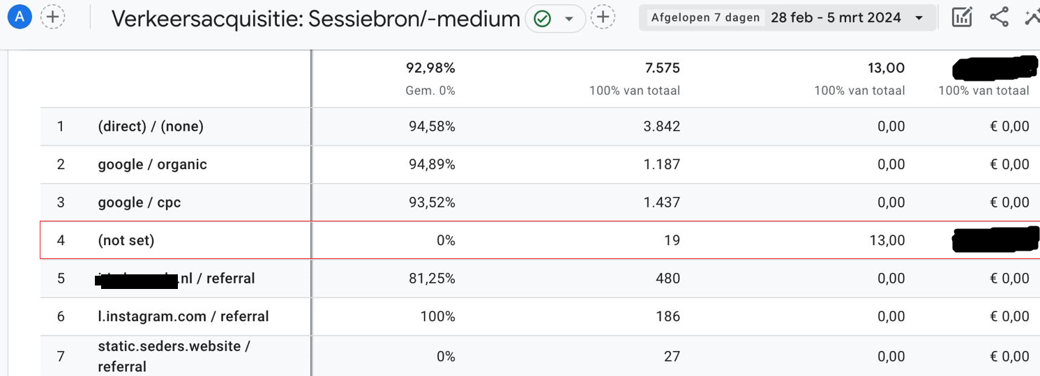

My ads manager asked if i can ask how to perfect the plugin connection for sales details.
He mentioned it has probably to do with "datalayer" but i am not skilled at all.
Could someone skilled in the GA4 plugin and how it should work in GA4 and gtag/ads check my attachment to see why we only get "not set" results on all sales and how to specify in gtag/ga4 what kind of sales they actually are?
Kind regards.

I checked some sources and discarded what could not be the problem, and i ended with this probability:
"Measurement protocol is not implemented correctly. The developer is sending events to GA4 without including a correct session_id. And if the event is sent to the past (up to 72 hours), then timestamp_micros parameter is not included (or it contains an incorrect value).
session_id parameter must contain a value of a session that was already tracked by GA4 on the website (client-side). If a developer randomly generates the session_id, the source/medium will be (not set).
If the event is sent to the past, the developer must include a valid session_id and it must include the timestamp (with timestamp_micros parameter) of when that session was actually happening on the site."
Is there a chance this is the issue in your opinion? Thanks

Thank you for your research on the matter. I think you're onto something here. I've been looking into this today.
session_id is not mentioned on the list of parameters of the "purchase" event in the GA documentation:
developers.google.com/analytics/devguide...ence/events#purchase
However, the page about sending events with the measurement protocol mentions it in passing:
developers.google.com/analytics/devguide...nts?client_type=gtag
In order for user activity to display in reports like Realtime, engagement_time_msec and session_id must be supplied as part of the params for an event.
However, it doesn't mention that it would affect the traffic source or anything.
Following this, I've stumbled on this page:
trackingchef.com/google-analytics/how-to...ent-protocol-events/
There, the author says that the session_id is necessary to connect the conversions with the user visits. So it might be what's missing indeed.
It also provides a payload example and a method to get the session_id with raw javascript.
Now, the code proposed there directly extract that from the cookies and requires the stream id. That's not ideal.
Searching further on this, I found this:
stackoverflow.com/questions/26915432/how...-by-google-analytics
Which provides the gtag code to get the session_id. That's actually the same mechanism the plugin already uses to get the client_id, which is another information the plugin has to provide when using the measurement protocol.
Now, this doesn't mean that it will fix the "traffic source" issue. I didn't see a mention of this so far. So I searched further and I found this:
stackoverflow.com/a/75500170
So here, passing the session_id indeed seems to be the solution to the missing source.
So, to make it short, I think that with this I can cook up something so that the session_id is provided by the plugin when using the measurement protocol to notify GA of the purchases. It's a shame that GA doesn't properly document this. We all waste so much time on this.
Anyways. With all that in mind, I've been working on adding this to the plugin and I just made a new release for it:
www.hikashop.com/marketplace/product/108...egration-google.html
Please try it and let me know how it goes.

2 years 7 months ago #359682 by NicoW
Unfortunately the new update did not resolve the issue yet.
Would/could it matter if i uninstall the old plugin before installing the new plugin?
More
2 years 7 months ago #359683 by nicolas
No, it won't matter. Check the "order_payment_params" of the new orders in the database. You should have the "session_id" in there.
Is that the case ?
Also, if you activate the "debug" setting of the GA plugin, once a new order is purchased, and provided that you configured the plugin with your measurement API secret, GA will log the communication between HikaShop and GA via the measurement protocol in the "payment log file" accessible in the HikaShop configuration. So you'll be able to confirm whether the session_id is passed to GA or not and if GA provides an error or not.
I'm suspecting that the session_id is provided to GA now, and that the problem is elsewhere (like in a configuration to make in the GA account).

2 years 7 months ago #359742 by NicoW
Yes, it seems like client_id is indeed fine and i see no errors:
BluePsyduck\Ga4MeasurementProtocol\Request\Payload Object
[clientId] => 787889507.1710273916
[userId] =>
[timestampMicros] =>
[userProperties] => Array
[nonPersonalizedAds] =>
[events] => Array
[0] => BluePsyduck\Ga4MeasurementProtocol\Request\Event\PurchaseEvent Object
[currency] => EUR
[transactionId] => D1L8T34
[value] => 34.95
[affiliation] =>
[coupon] =>
[shipping] => 0
[tax] => 6.07
[items] => Array
[0] => BluePsyduck\Ga4MeasurementProtocol\Request\Event\Item Object
[itemId] => 6011431748786_O
[itemName] => Lightbenders Oranje zwart
[affiliation] =>
[coupon] =>
[currency] => EUR
[creativeName] =>
[creativeSlot] =>
[discount] =>
[index] => 0
[itemBrand] =>
[itemCategory] => "UV400 filter brillen"
[itemCategory2] => "Alles"
[itemCategory3] =>
[itemCategory4] =>
[itemCategory5] =>
[itemListId] =>
[itemListName] =>
[itemVariant] =>
[locationId] =>
[price] => 34.95
[promotionId] =>
[promotionName] =>
[quantity] => 1
[session_id] => 1710273915
[engagement_time_msec] => 1
Hope any new ideas pop up, don't wish to need to go back to my developer to code this into hikashop for 300usd just to make it work. Thanks already.
More
2 years 7 months ago #359745 by nicolas
The debug you provided indicate that the session_id is passed to GA.
So if you don't see what you want on GA, then it means that the problem is not with this.
As for the session_id, I'm happy to add other improvements to the plugin if there is something missing in the data sent by it.
What would be missing ? I don't know. Maybe nothing is missing and it had nothing to do with the session_id in the first place ? Maybe it needs to configuration in your GA account ? I don't know.
I can only follow what the GA documentation recommends and if nothing is written about something, I can't guess it. We are already grasping at straws with the session_id.
