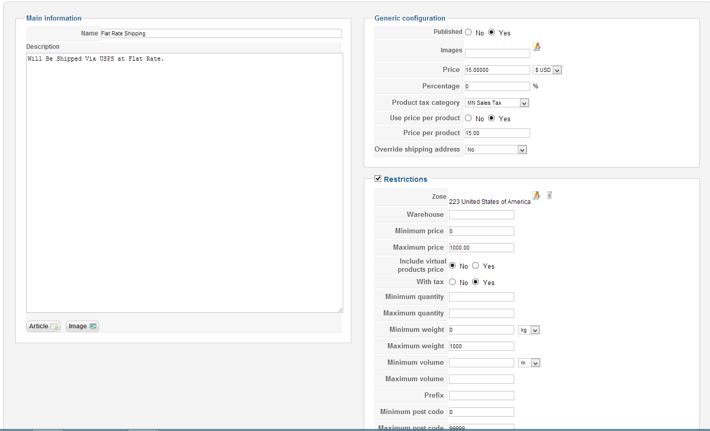

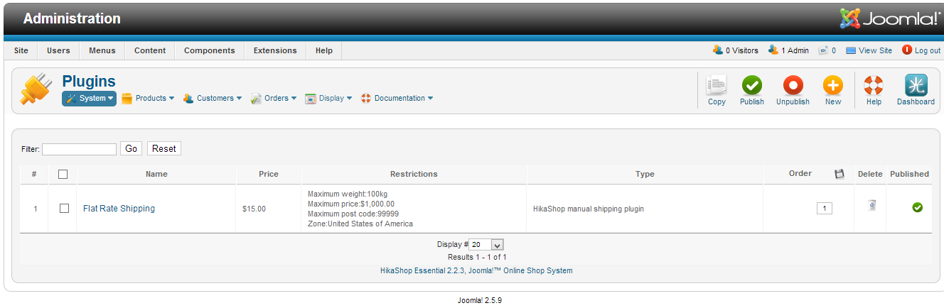

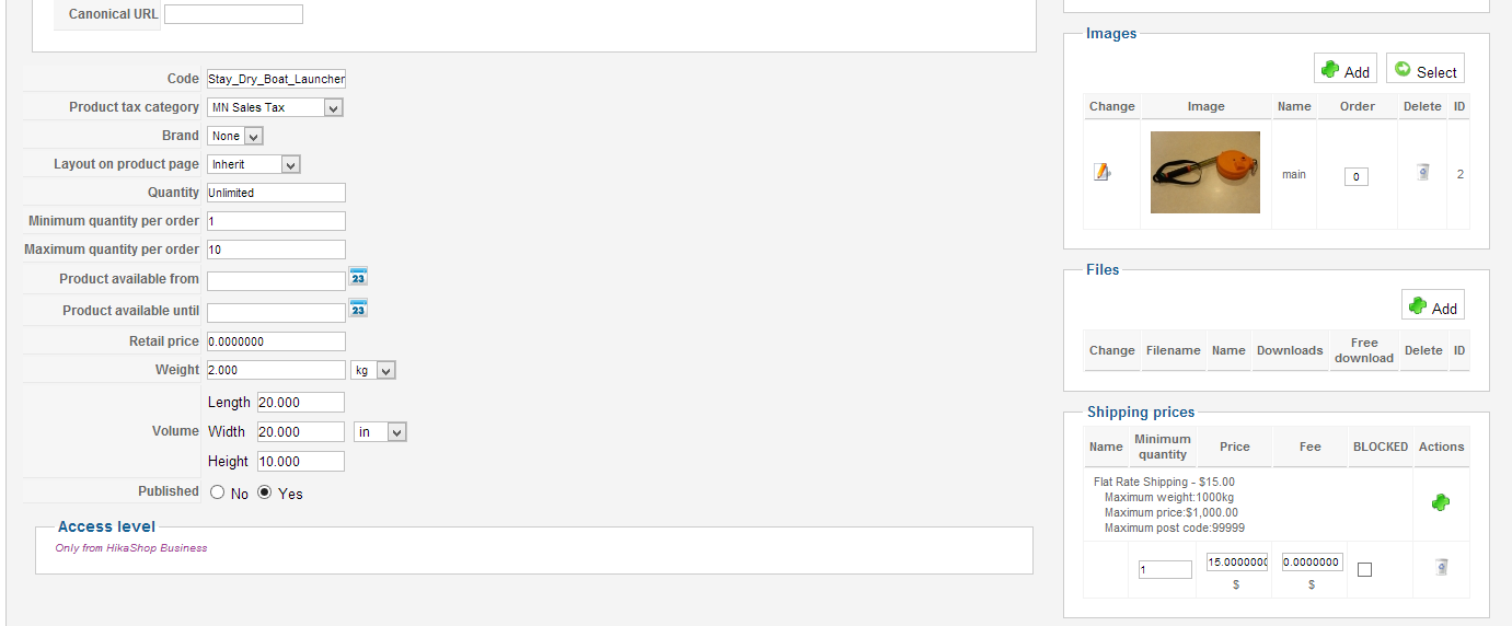

  • Posts: 2
12 years 8 months ago #138309
I've attached screenshots to this post.
I did notice that I tried to save to turn off the restrictions completely for the shipping method I have that it did not save it properly. Ex: Unchecked the check box and hit save and close, then come back to edit the shipping method and it still has that box checked.
Any help you could provide would be much appreciated!

12 years 8 months ago #138360
hawk1260 wrote: I've attached screenshots to this post.
Ok, so can you download the last Hikashop version through our website, install it and test it again, so that you can have a shipping method with less restriction because I think that the problem is coming from these restrictions ?
Thank you.
