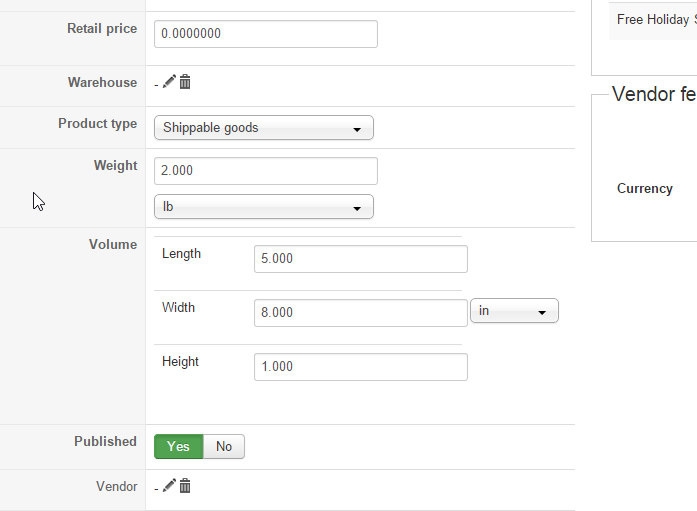

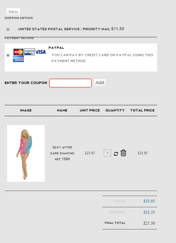

My USPS shipping will only provide Priority shipping. I will not give me the option of First Class, even if the backend has First Class checked as an option.
Originally, I was told it was because there were no dimensions and weights on the product, but that is no longer true. My products have dimensions and weights.
If the value goes above $45, then my promo kicks in and offers First Class for free, but a paid First Class for orders below $45 is not showing.
Am I missing a setting somewhere?

OK. Found out the issue from USPS, but have a follow up question on how Hikashop will handle.
First Class USPS is only available for packages under 13 oz (~.8lbs). IF over 13oz, then must by Priority Mail.
Are the dimensions listed on the product page supposed to be when packaged for shipping or before being put into a box for shipping?
If when packaged for shipping, how does that affect the "Container" choice on the Specific Configuration for USPS?
What I am trying to figure out is how to properly configure for Priority Flat Rate Shipping. I would like Hikashop to use Priority USPS Flat Rate Shipping when possible, but the flat rate boxes are sized (Small, Medium, Large) and I am unsure how the Container choice is affected with product dimensions.

Sorry if I was not clear. Let me try and explain again.
Priority USPS Flat rate is based on pre-determined box size. We would like to minimize the shipping cost charged the customer by putting as much as possible into the pre-determined box size. These boxes I am assuming are what is referred to in in the "Container" field in the shipping options (Small Flat Rate box, Medium Flat Rate Box, and Large Flat Rate Box).
The dimensions listed on the product page. Is that the actual dimensions of the product before we wrap it for shipping or after we wrap for shipping? How does the product dimensions affect the "Container" choice? Example, if I put the product dimensions as 10 feet x 10 feet x 10 feet, but I put the "Container" setting as Small Flat Rate box, what happens?
What does Hikashop do with the product dimensions when multiple products are in the same order? Does it add all the dimensions together? Ideally, what I am hoping for is you will tell me that based on the Product Dimensions, Hikashop can determine if a Flat Rate Box can be used. Example (dimensions are made up):
Quantity 1 Product with 2" x 2" x 1" dimensions fits in a Small Flat Rate Box
Quantity 3 Products with 2" x 2" x 1" dimensions fits in a Medium Flat Rate Box
Quantity 10 Products with 2" x 2" x 1" dimensions fits in a Large Flat Rate Box
Quantity 100 Products with 2" x 2" x 1" dimensions is calculated using a variable Container and weight
Does my question make sense now?
