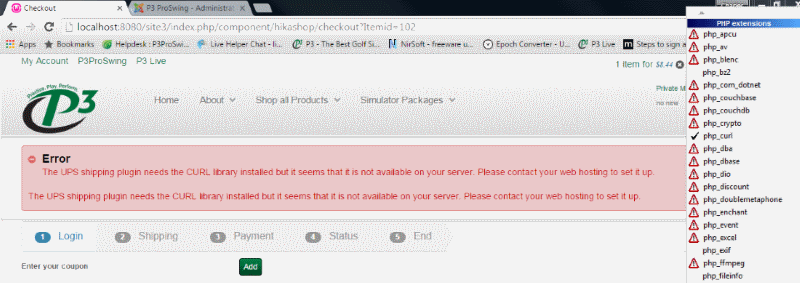

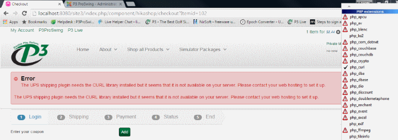

  • Posts: 14
10 years 6 months ago #232759
Yup, that resolved that error but created a new one. It now tells me that The UPS Plugin needs the CURL library... But I have the php curl extension installed. See the attached screenshot.

  • Posts: 104
  • Thank you received: 5
10 years 6 months ago #232764
Disregard. I found the issue. The curl extension was on for php, but not Apache. Once I started it for Apache, the error went away. Ironically - it wasn't an issue before the update though.
