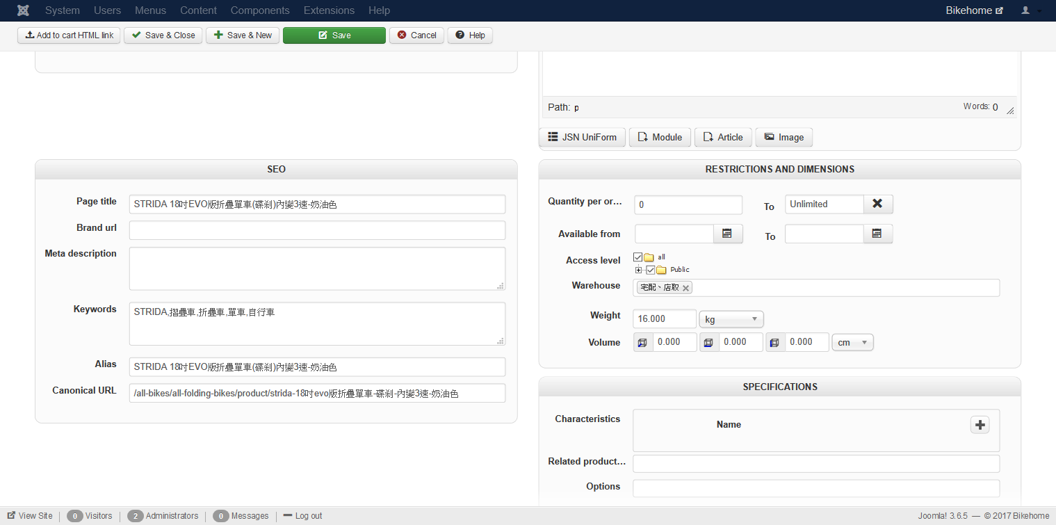

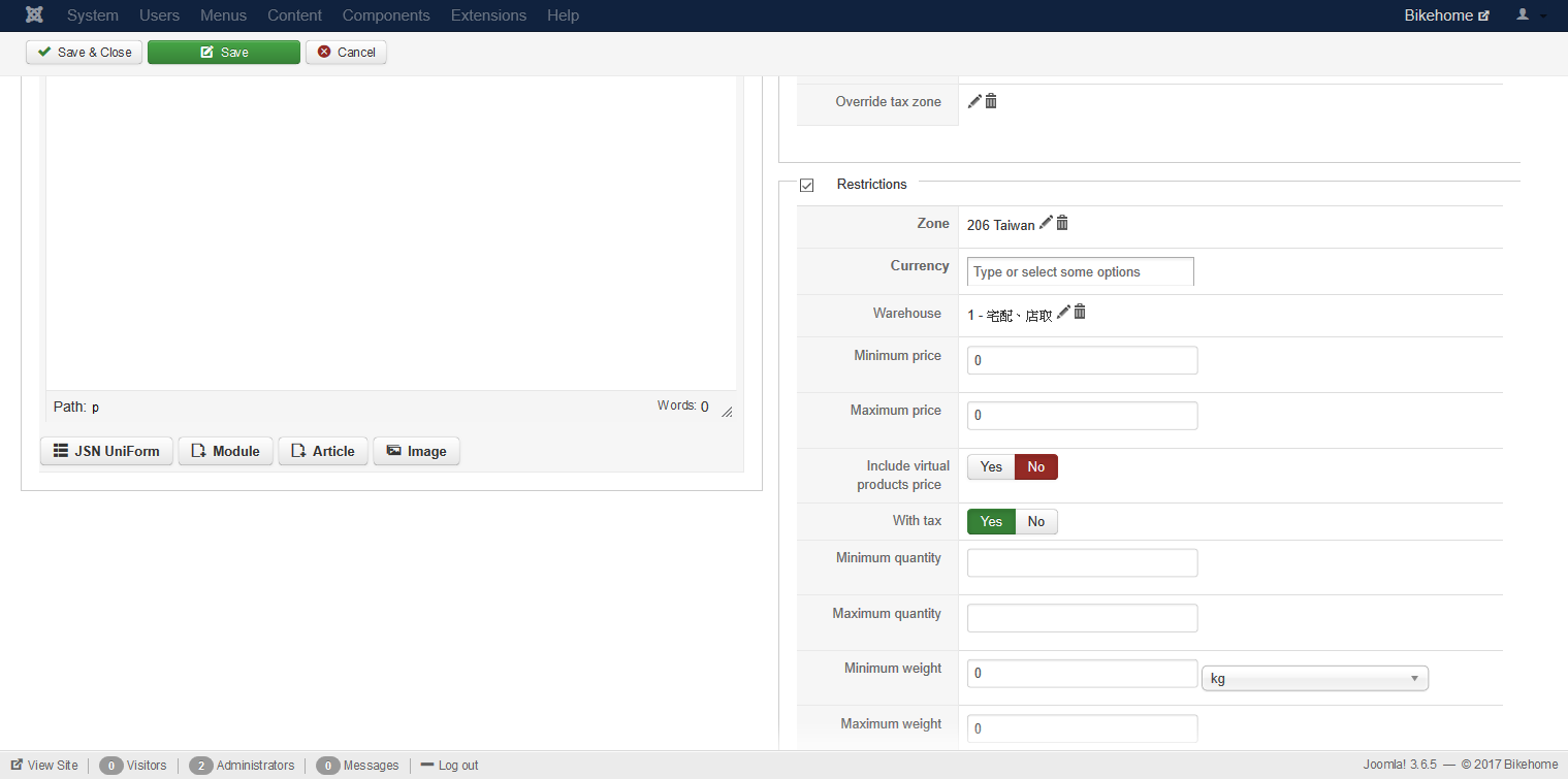

I have setting the product's waregouse and shipping method . The special shipping method is ok on check-out page!!
My question is , I have assigned many products on a wareouse A.
How can list all the product have assigned on warehouse A
