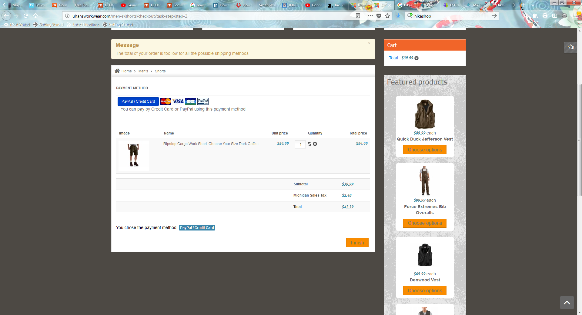

-- Joomla version -- : 3.8.3
-- PHP version -- : 7.0.22
-- Browser(s) name and version -- : Firefox 57.0.4 64-bit
-- Error-message(debug-mod must be tuned on) -- : Notice: Trying to get property of non-object in /home/localm9/public_html/uhansworkwear.com/plugins/hikashopshipping/ups/ups.php on line 794
Warning: Invalid argument supplied for foreach() in /home/localm9/public_html/uhansworkwear.com/plugins/hikashopshipping/ups/ups.php on line 794

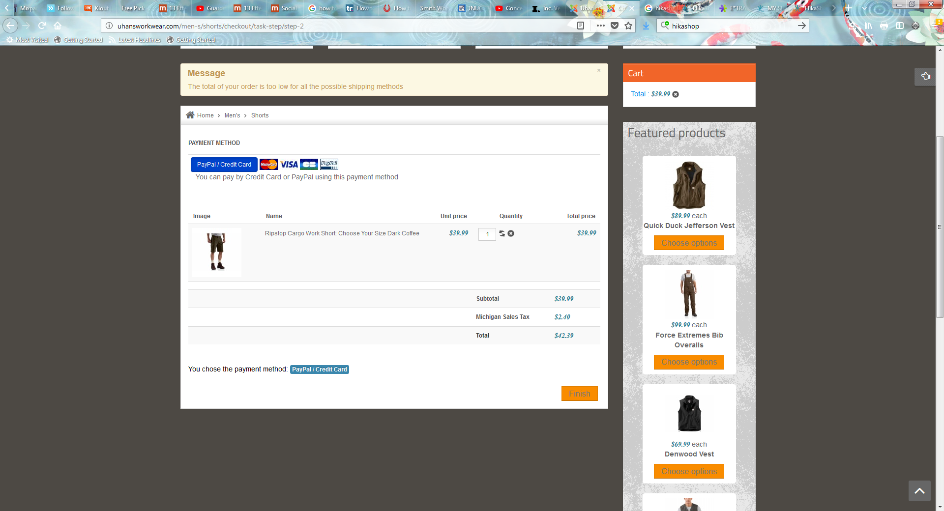

This worked for a couple years now all of a sudden no products can be bought that are less than $99. Anything over $99 uses a manual shipping method and is free shipping and customers can buy products. Anything less than $99 uses the UPS shipping method and all of a sudden doesn't work, people aren't allowed to buy products. Please help. I've tried for hours to figure out....thanks.

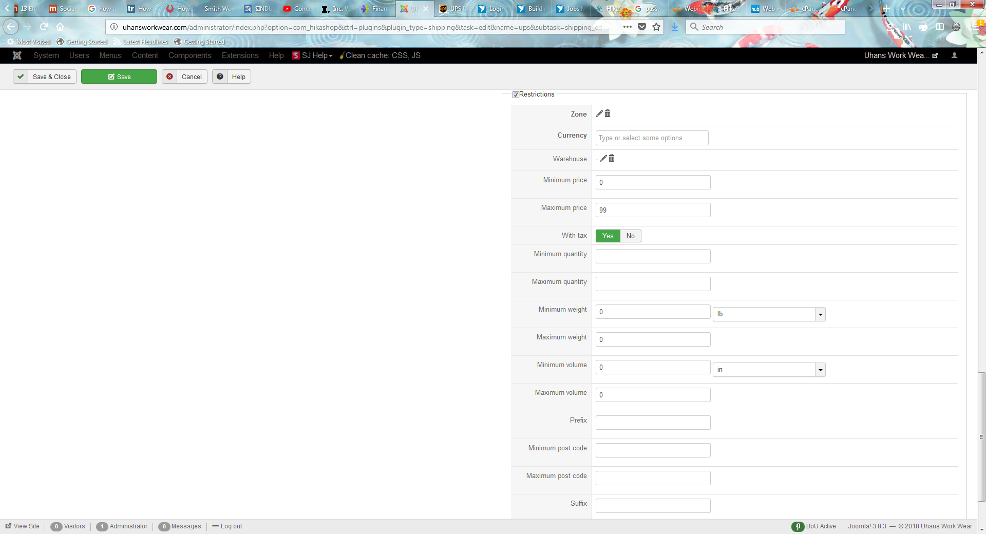

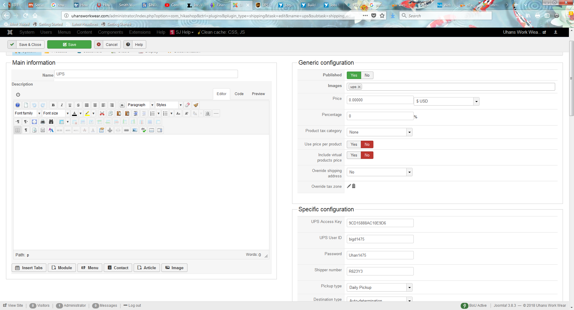

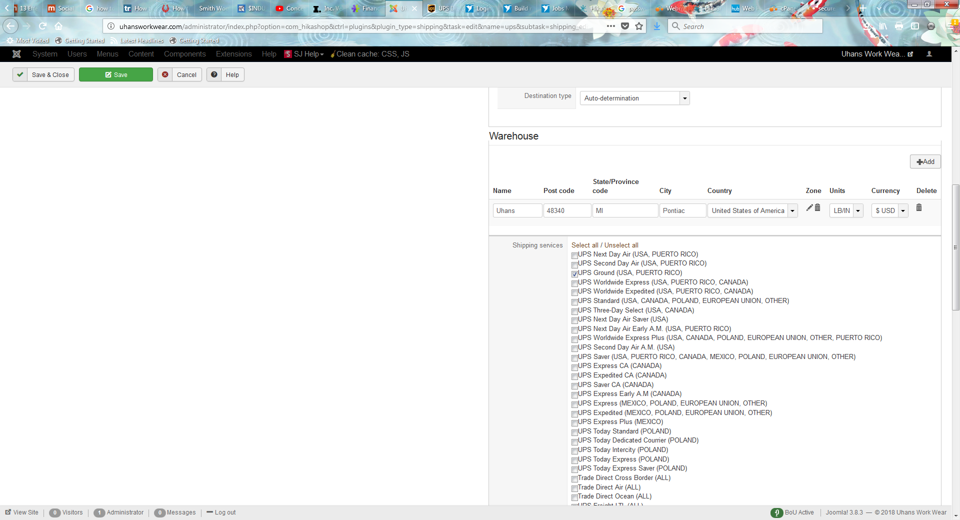

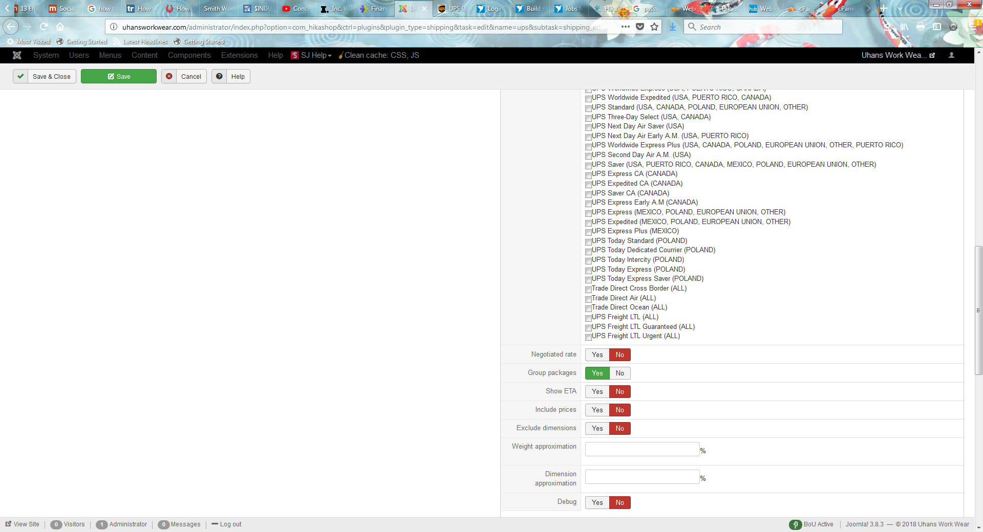

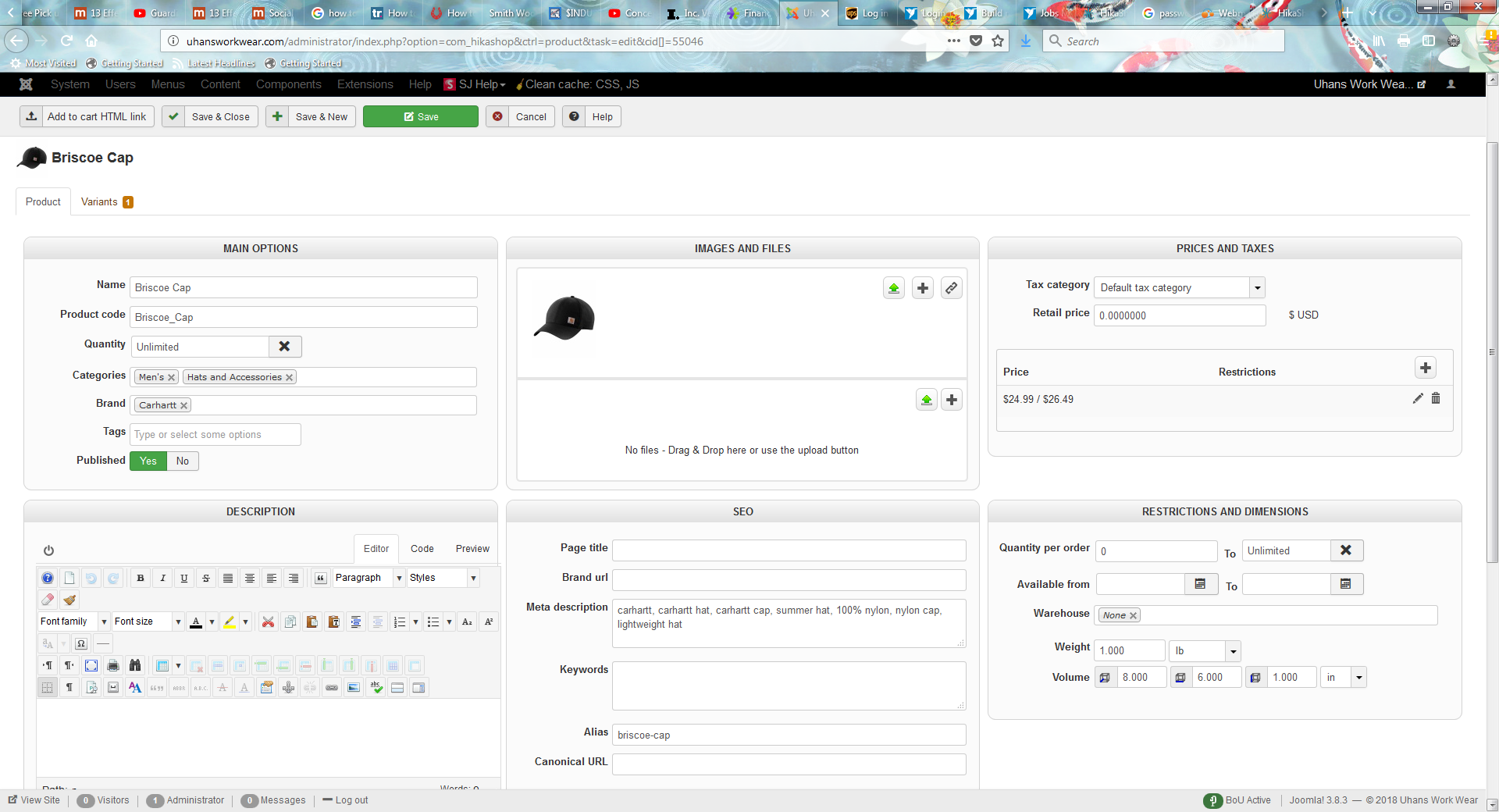

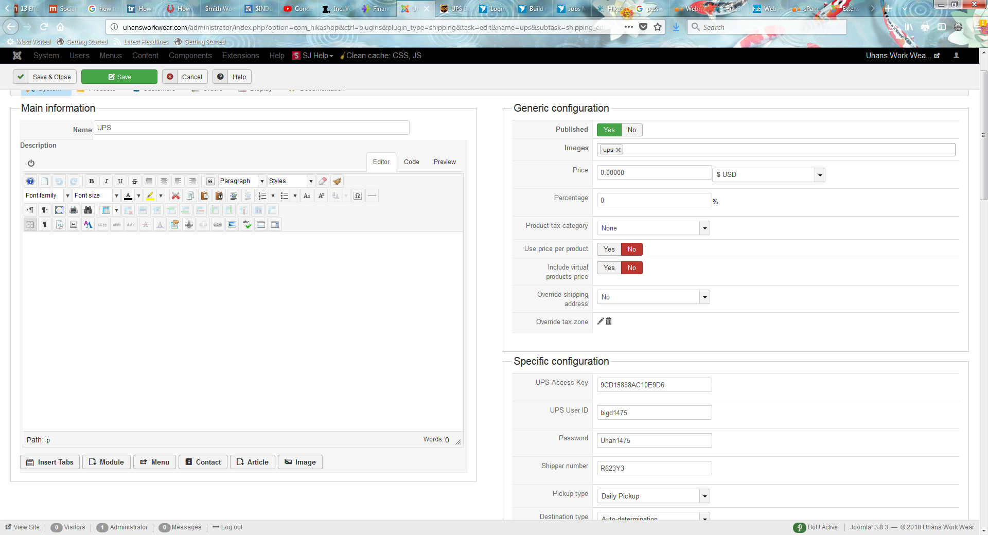

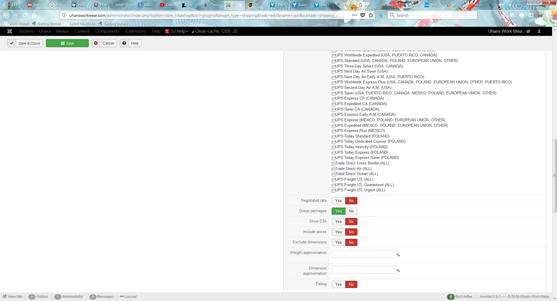

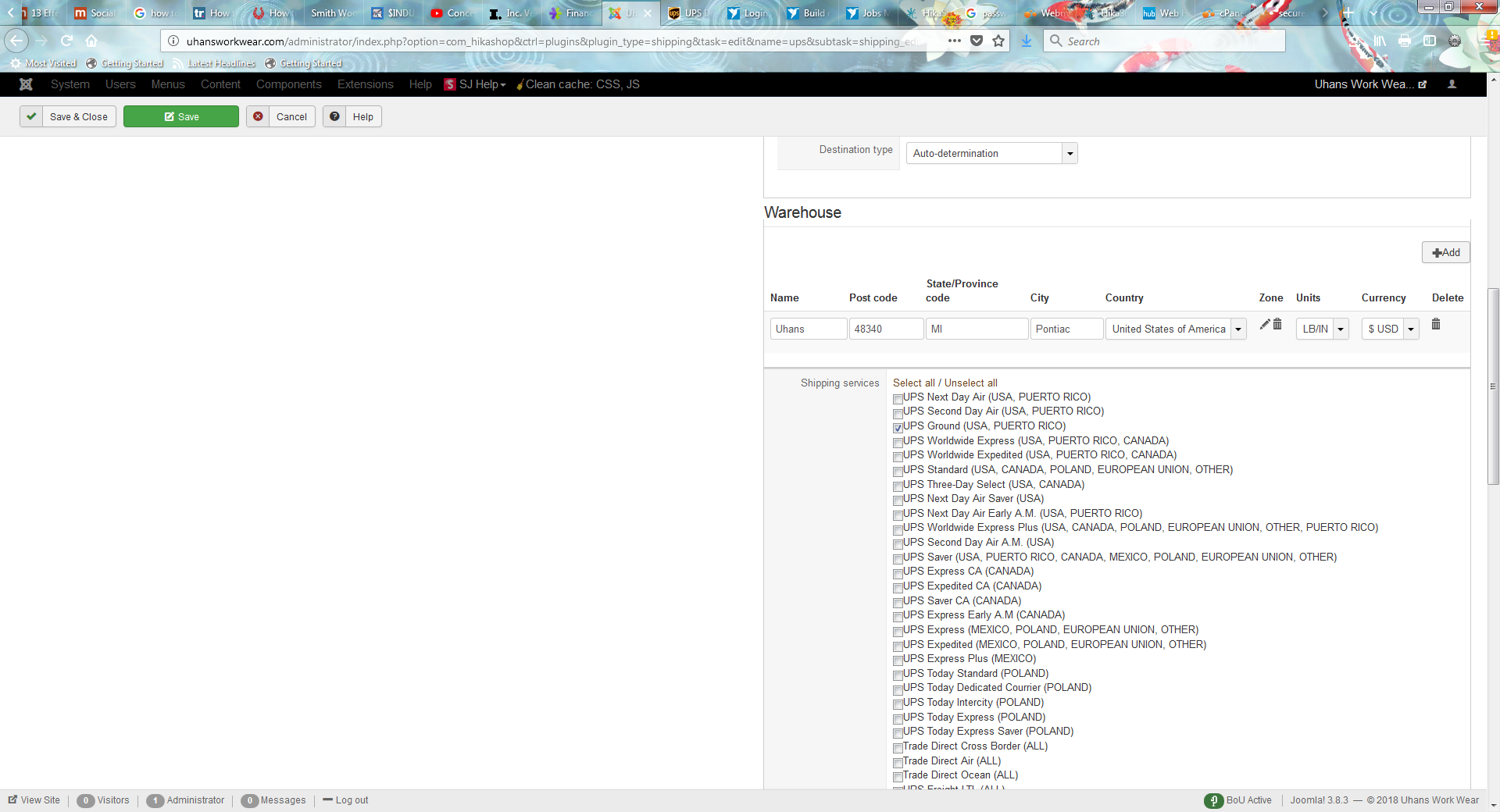

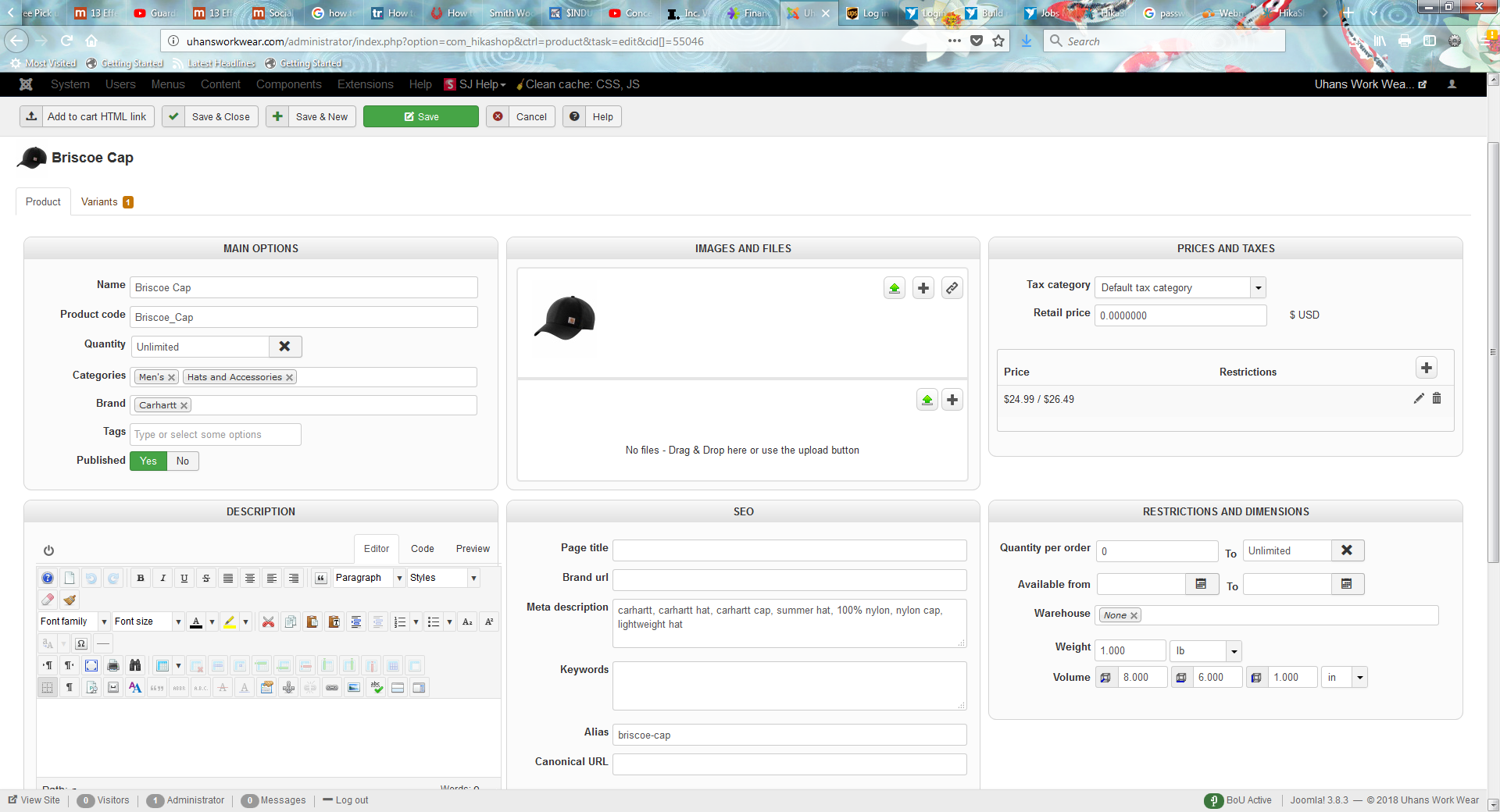

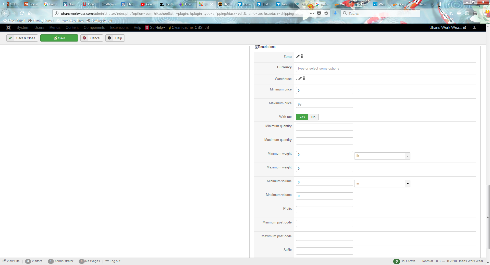

Can you send us screenshots in which we can correctly check :
- Your shipping method configuration page
- How you configured your product used when testing your shipping plugin
- The shipping address used during your test.
So that we can reproduce and test it on our end ?
Thank you.
  • Posts: 74
  • Hikashop Essential
8 years 8 months ago #286034
Okay. Here's the screenshots you requested.
Test address: 4270 Laura Ln, White Lake, MI 48383
Last edit: 8 years 8 months ago by jdean. Reason: Didn't want to show info in an open forum

8 years 7 months ago #286382
The following error message was actually coming from the manual shipping method named "Free Shipping" with a "Minimum Price" set to $99.01 :
The total of your order is too low for all the possible shipping methods
Also, your issue seems to be coming from your server, as the response from the UPS platform after sending our request is :
Access denied
You don't have permission to access "Rate" on this server.
You should probably contact your Hosting company about it.
