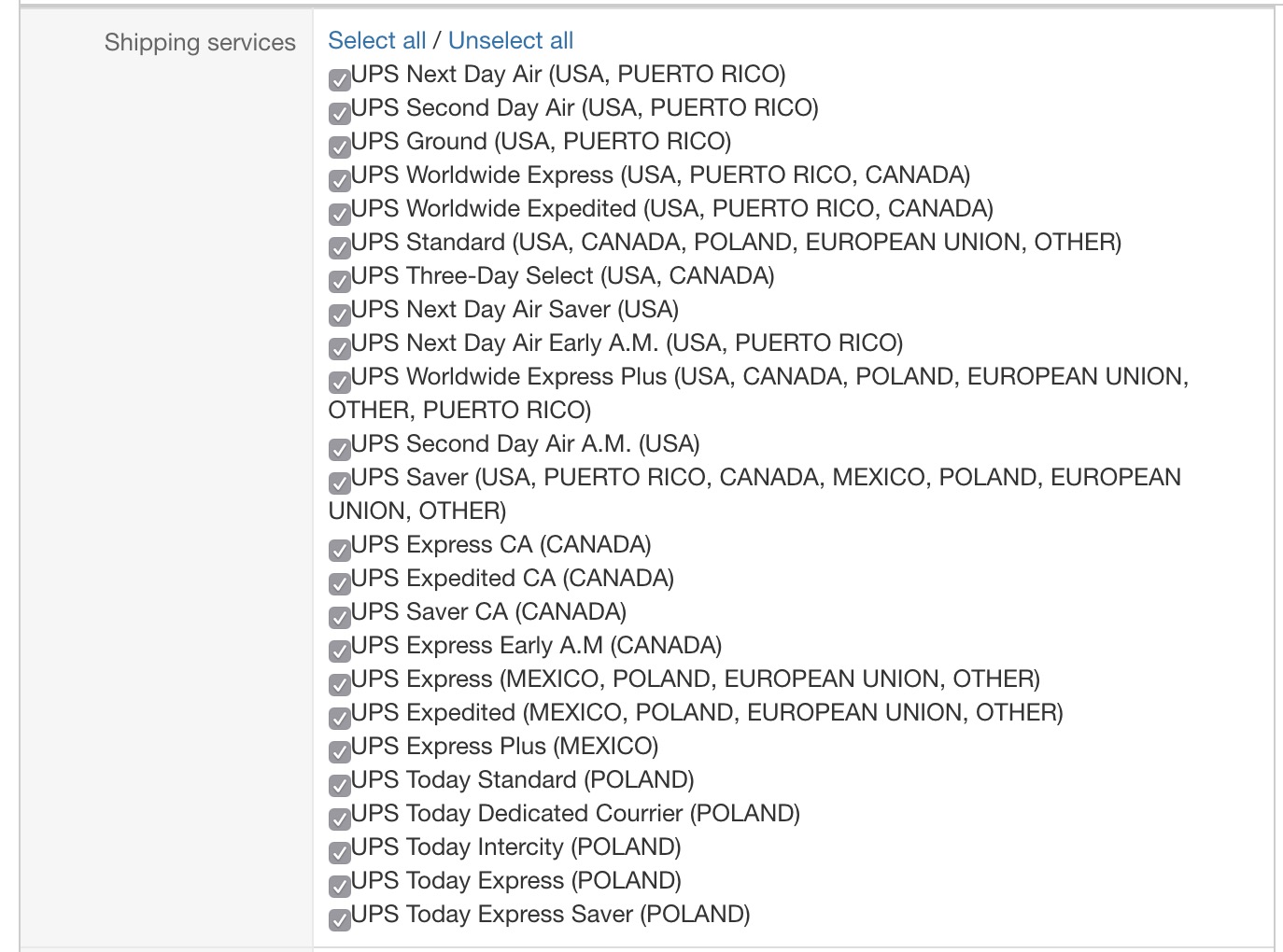

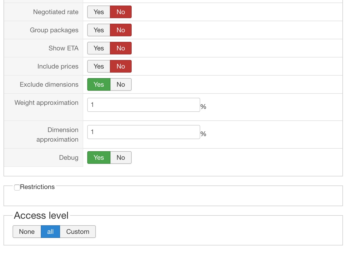

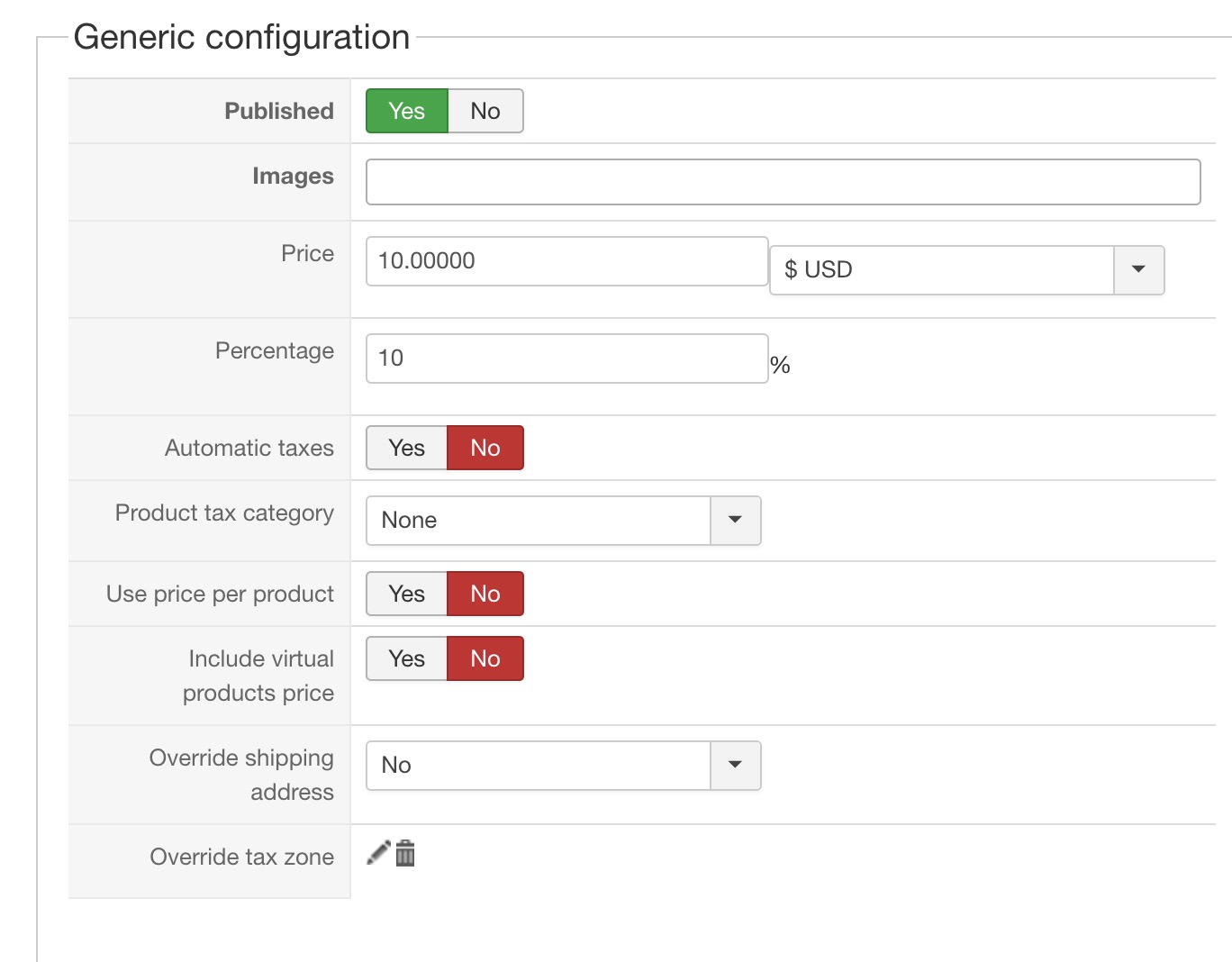

See attached screenshots on the setup.

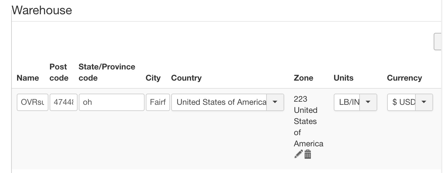

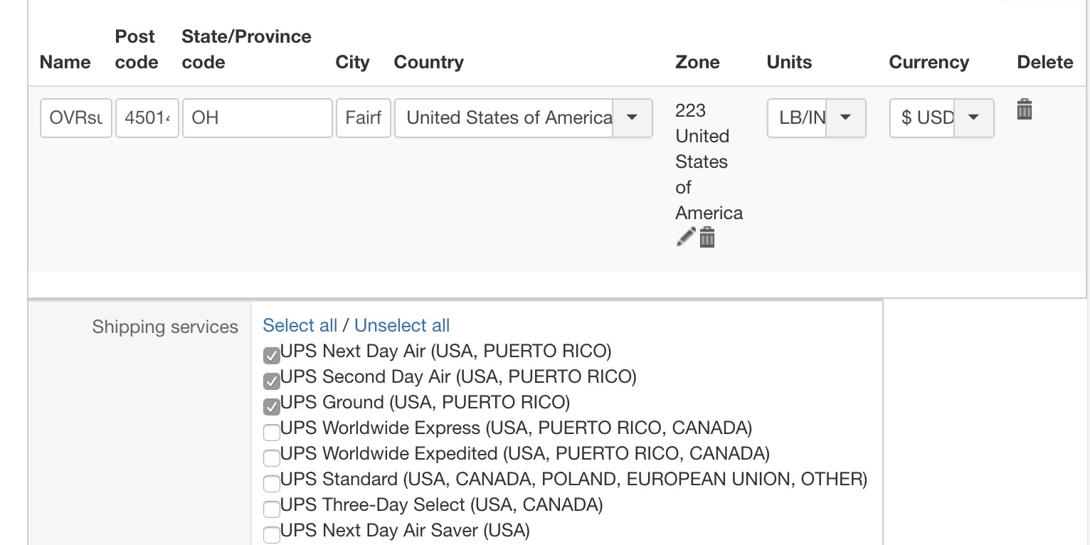

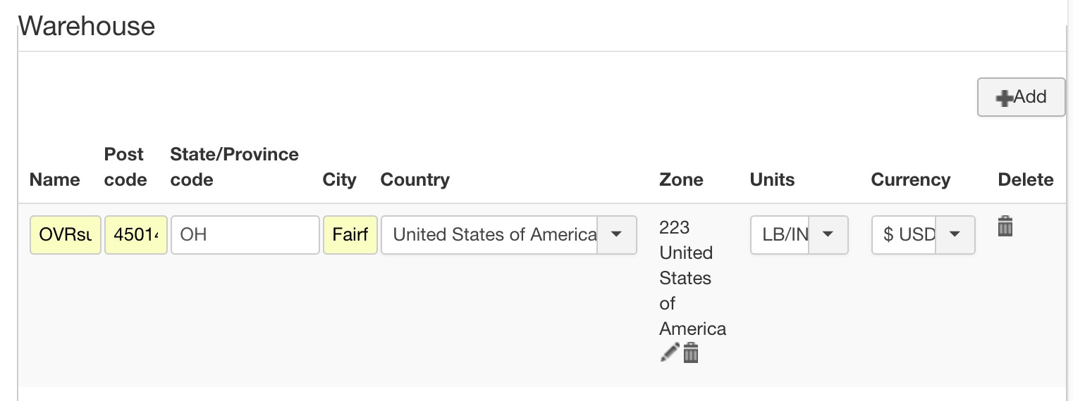

1. When I remove the UPS "warehouse" totally, I get the following error "no_warehouse_configured."
2. When I recreate the UPS "warehouse" using our warehouse address info (OVRsupply.com, 45014, OH, Fairfield, United States of America, 223), I get "No shipping method found."

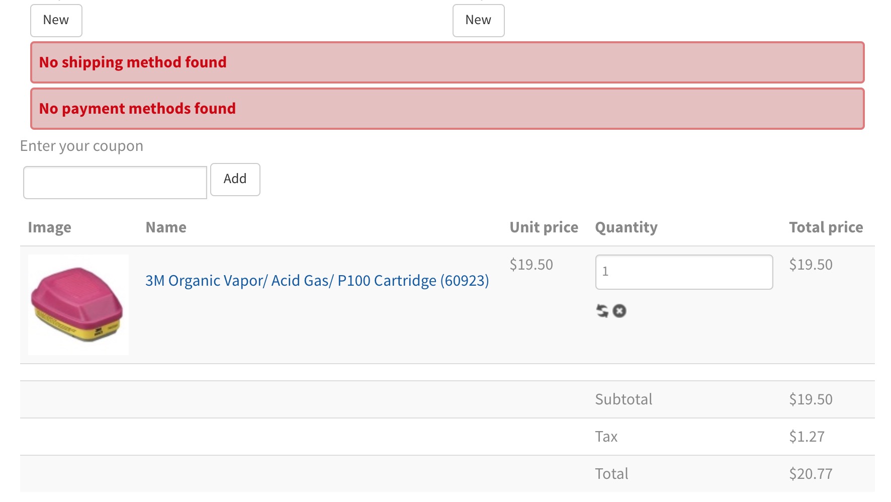

See ATTACHED.
I've spent countless hours of the last few weeks.... STILL NO FIX!!!! Please Hikashop... Help me! This should be this hard to figure out?
Last edit: 8 years 1 month ago by shockoe.

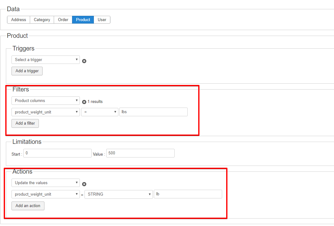

8 years 1 month ago #295823
Your issue is coming from the fact that the weight unit of your products is "lbs" instead of "lb", your products probably have that weight unit because you imported your product using a CSV file with a wrong weight unit.
If you test it with the "Nitrile Gloves- 6 Mil, Large, 100/Box" product it's working fine now.
The solution will either be to re-configure all of your products with the correct weight unit, or to directly use Mass actions to do it via "Hikashop->System->Mass actions":
www.hikashop.com/support/documentation/167-massaction-form.html
Last edit: 8 years 1 month ago by Mohamed Thelji.
