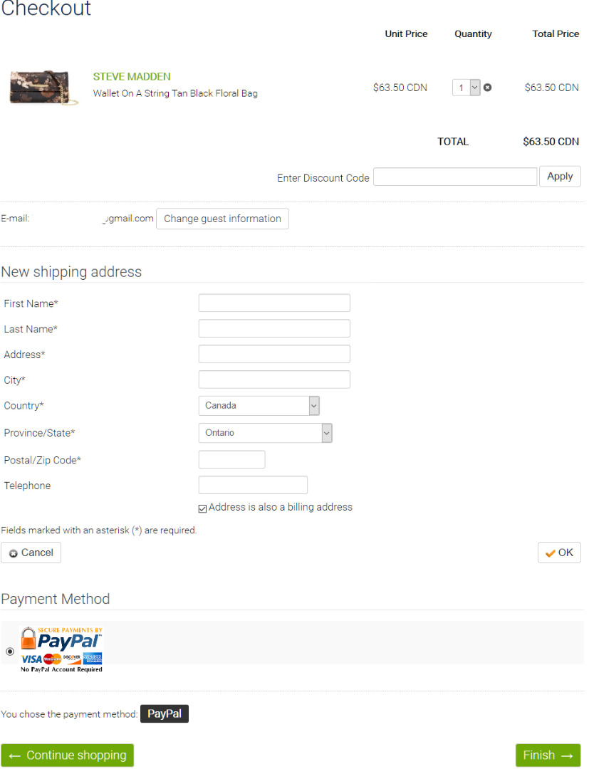

-- Joomla version -- : 3.8.10
I upgraded to the most current version of HikaShop (3.5.1), I cleared my cache and saw the shipping details. Then I cleared my cache again and entered the exact product and info and the shipping info disappeared. It is acting finicky.
So currently the shipping info. appears to sometimes show only when you login but when I try to checkout as a guest it's a total mess.
1) If I click next and DO NOT enter the captcha the page looks very bizzare.
2) The shipping cost does not show at all when I enter Guest info. Please see attached how the page looks after I enter the guest info and click on next.
Your help would be greatly appreciated.

8 years 1 month ago #295775
In regards to #1 above, the Captcha seems to be what is messing up the page. When I enter the information on the user registration page and click on register without entering the captcha the page is fine, it's only a mess on the checkout page.

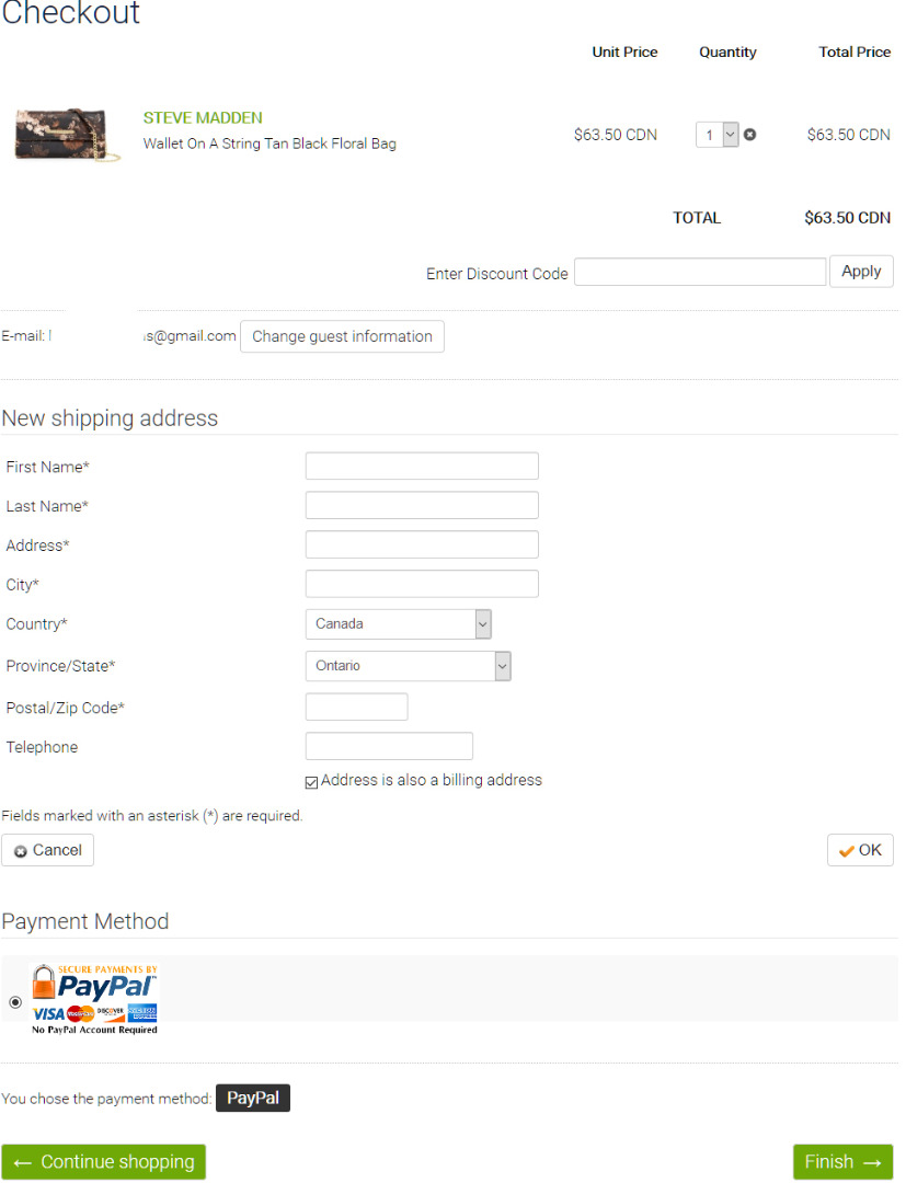

8 years 1 month ago #295819
1) I installed the captcha and when I click next and DO NOT enter the captcha the page looks fine, however, there appears to be a new issue - the Address and Shipping section is missing. Please see attached pic.

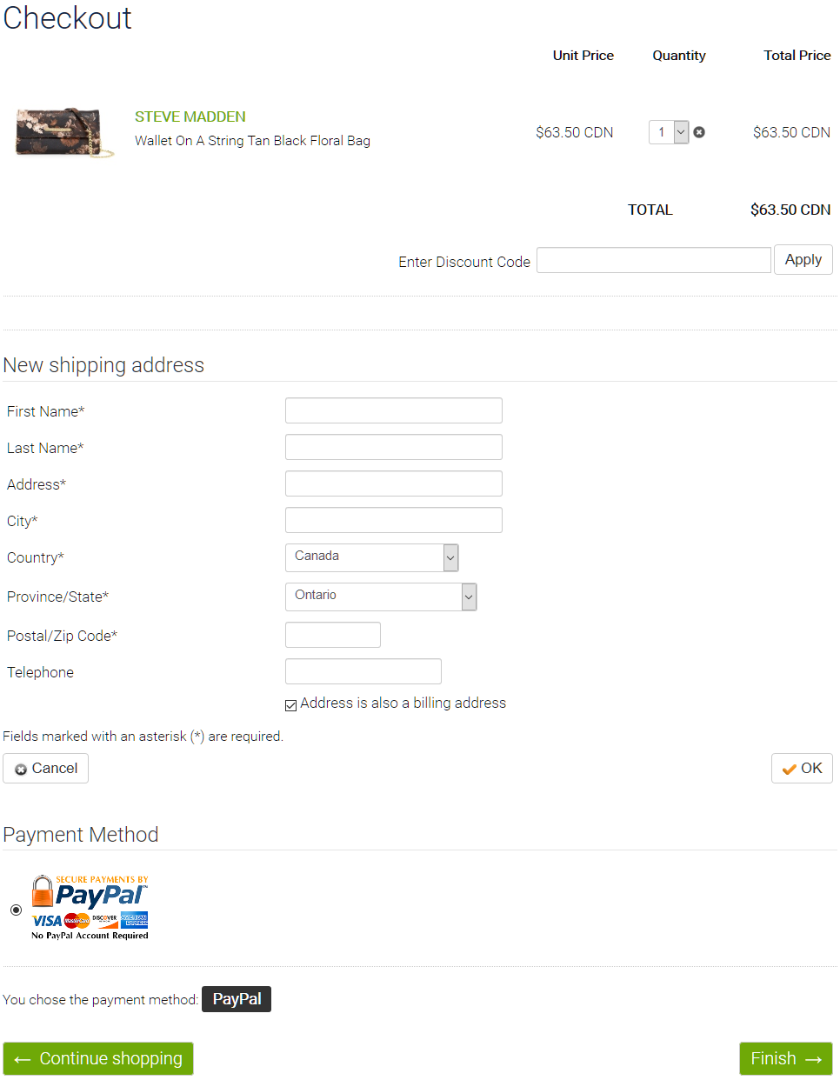

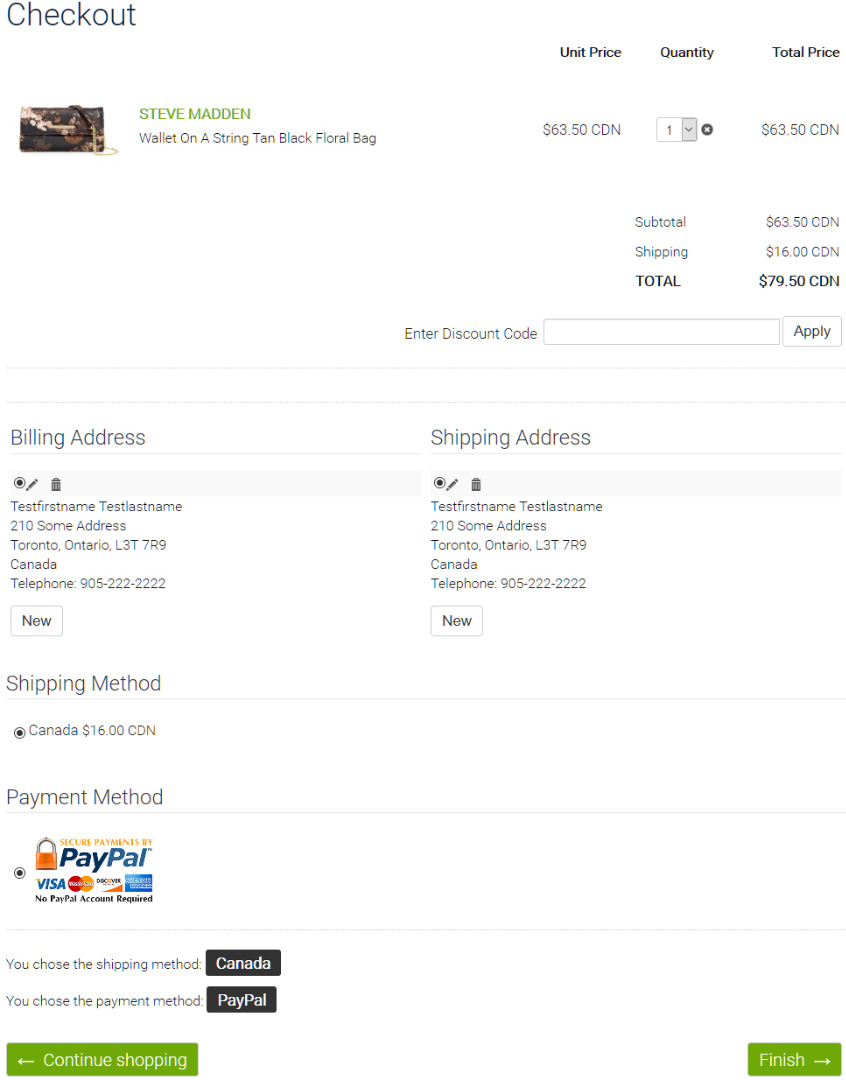

8 years 1 month ago #295840
I installed the recaptcha plugin and tested....
After I enter the GUEST address and click submit, the page looks like the attached (checkout-EXAMPLE-1.jpg). The address that I entered and the shipping amount is still not showing. It should look like (checkout-EXAMPLE-2.jpg).

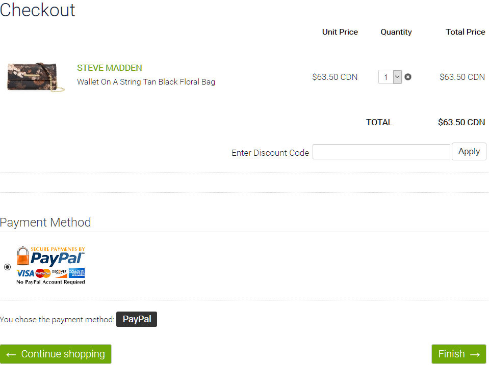

8 years 1 month ago #295841
So after some additional testing, when a NEW user signs up or if a user is trying to checkout as a GUEST the checksout page is not working correctly. I can see the registration information in the backend but the checkout page is a mess.
Please see attached.
Thanks!
