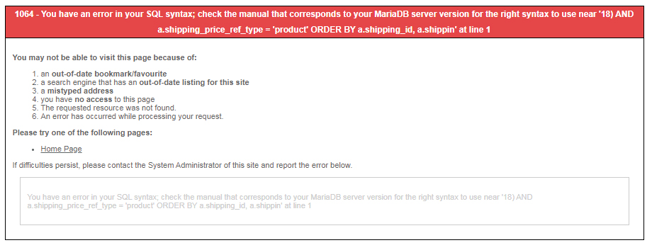

-- Joomla version -- : 3.9.18
-- PHP version -- : 7.2.31
-- Browser(s) name and version -- : All browsers
-- Error-message(debug-mod must be tuned on) -- : 1064 - You have an error in your SQL syntax; check the manual that corresponds to your MariaDB server version for the right syntax to use near '18) AND a.shipping_price_ref_type = 'product' ORDER BY a.shipping_id, a.shippin' at line 1
You may not be able to visit this page because of:
an out-of-date bookmark/favourite
a search engine that has an out-of-date listing for this site
a mistyped address
you have no access to this page
The requested resource was not found.
An error has occurred while processing your request.
Please try one of the following pages:
Home Page
If difficulties persist, please contact the System Administrator of this site and report the error below.
Developing a new site:
Everything was going fine until I changed the characteristics in a product then I got an SQL error after altering characteristics in product, error disappears with price per shipping disabled.
Have even removed all of the characteristics...
Still happening
Ian
