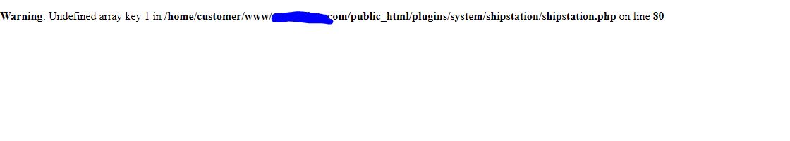

I decided to turn on error reporting and found a php error whenever i try to visit the shipstation url:
Warning: Undefined array key 1 in /home/customer/www/site.com/public_html/plugins/system/shipstation/shipstation.php on line 80
I am running PHP 8.1.22. If I try to upgrade to 8.3.0 it gives me a ton of php errors. Is there a new version of the plugin I'm missing or is there a specific PHP version needed for this to run properly now?

3 years 1 month ago #354169
I'm taking over Philippe here. He is away, on holidays for a while.
The plugin will work fine on PHP 8.1. No need to upgrade or downgrade your PHP.
That error is with the code:
preg_match('#SS-UserName=([^&]+)#i', $path, $matches);
$shipUser = $matches[1];
in the ShipStation plugin. This code retrieves the username from the URL when ShipStation contacts the website to retrieve the orders data.
The fact that you get that warning message indicates that the code cannot find the SS-UserName parameter in the URL used by ShipStation to contact the plugin. So it points at potentially a missconfiguration of the Marketplace Connection in your ShipStation account.
