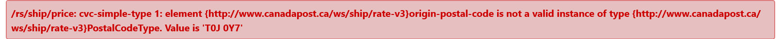

I changed that and tested again. Got this. Seems like the space is a problem?
  • Posts: 26386
  • Thank you received: 4078
2 years 4 months ago #360697
The plugin had some code to handle customer post-codes with spaces ; after a new check, the postcode from your configuration is sent directly to the API which does not accept spaces (it's not our fault, it's from Canada Post itself).
Thus, I added a new patch in order to remove spaces from the postcode configuration when sending it to the Canada Post API.
Your can re-download the plugin to get the fix.
