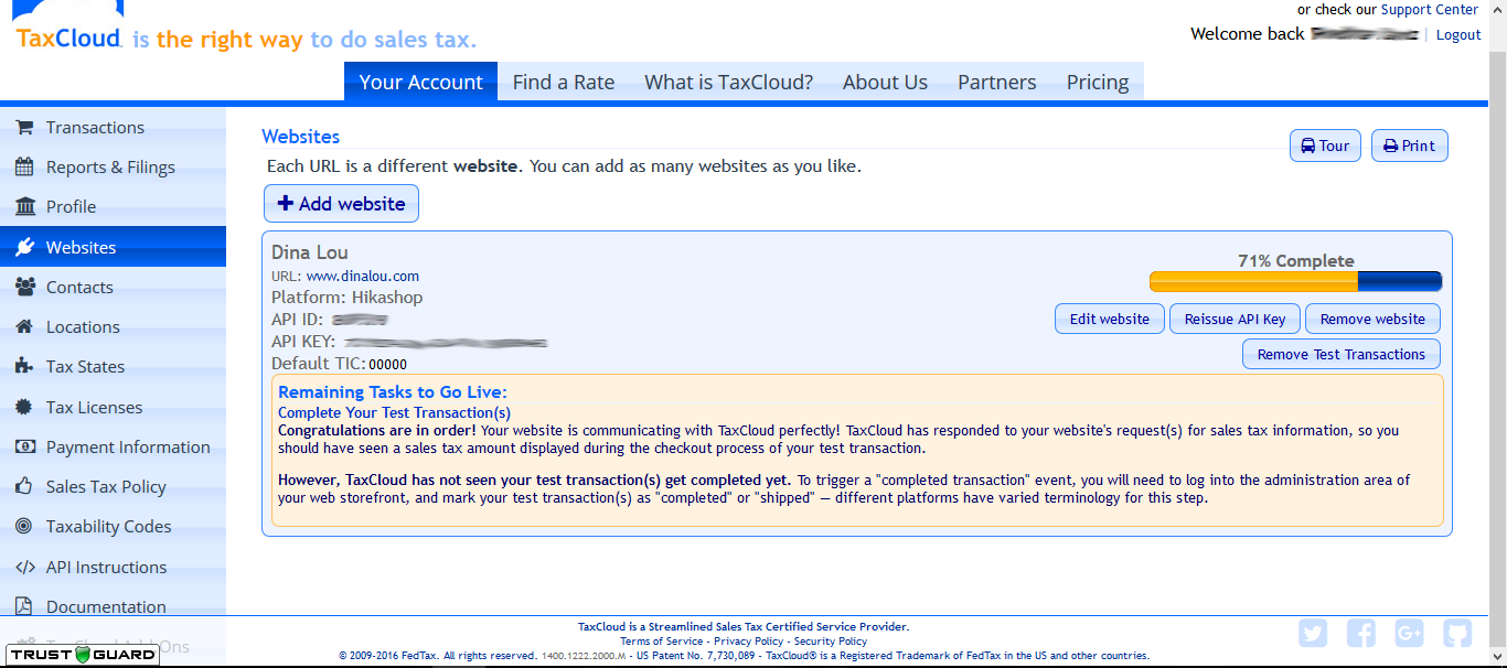

-- url of the page with the problem -- : www.dinalou.com
-- Joomla version -- : 3.5.1

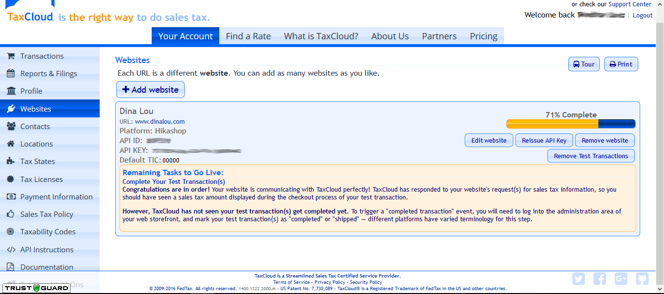

I'm having issues setting up TaxCloud on my website. It keeps telling me that I haven't completed the test transaction even then though I've changed the order status to 'confirmed' and 'shipped' like a million times.
Here is the configuration I have on my site.
If anybody can help me with this that would be wonderful.
Thank you

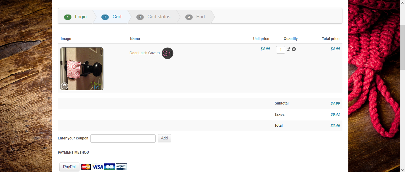

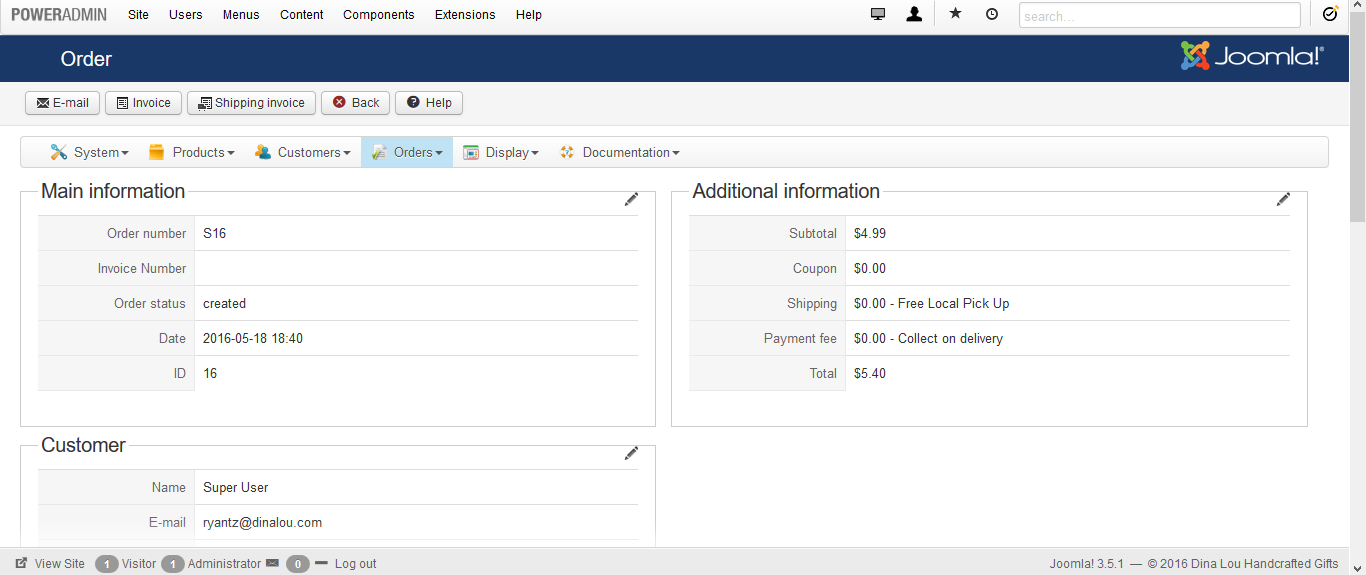

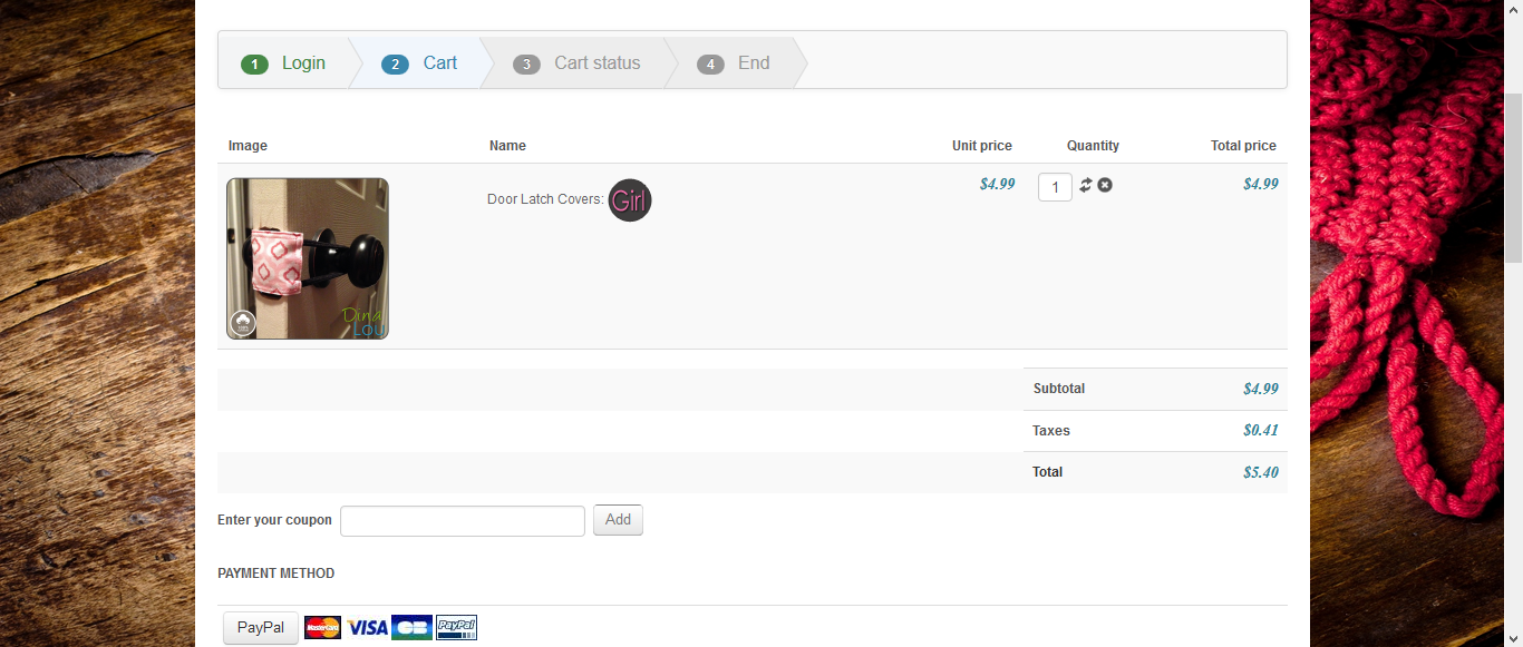

I wanted to do a test on your website, but I didn't see taxes on your website's checkout. Maybe the address I used was not taxable for your shop ?

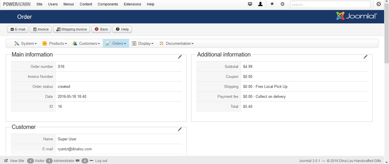

So did you get the taxes during the checkout ? Do you see the taxes in your order details when you edit it in the backend ?

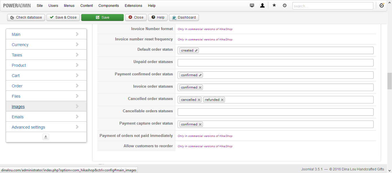

Are you changing the status of the order from "created" to "confirmed" (only that case will work).

I fixed the taxes on TaxCloud to include all states. So you should be able to see taxes when you do a test.
I get the tax amount during my checkout because my state was already set up in TaxCloud.
I'm not seeing the taxes in the order details on the backend. Should they be there?
I've changed the status of the order from "created" to "confirmed" to "shipped" and still nothing. I've done it several times and it's still not working.

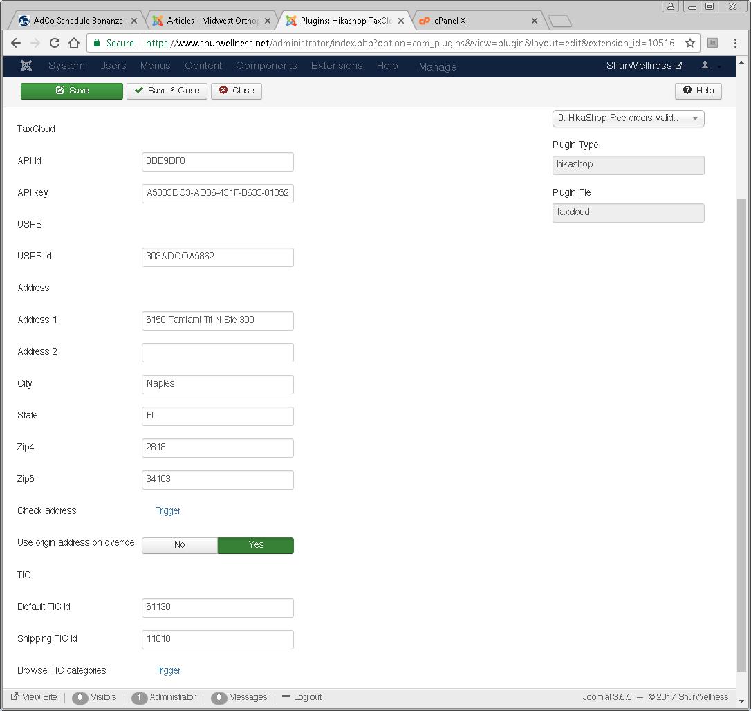

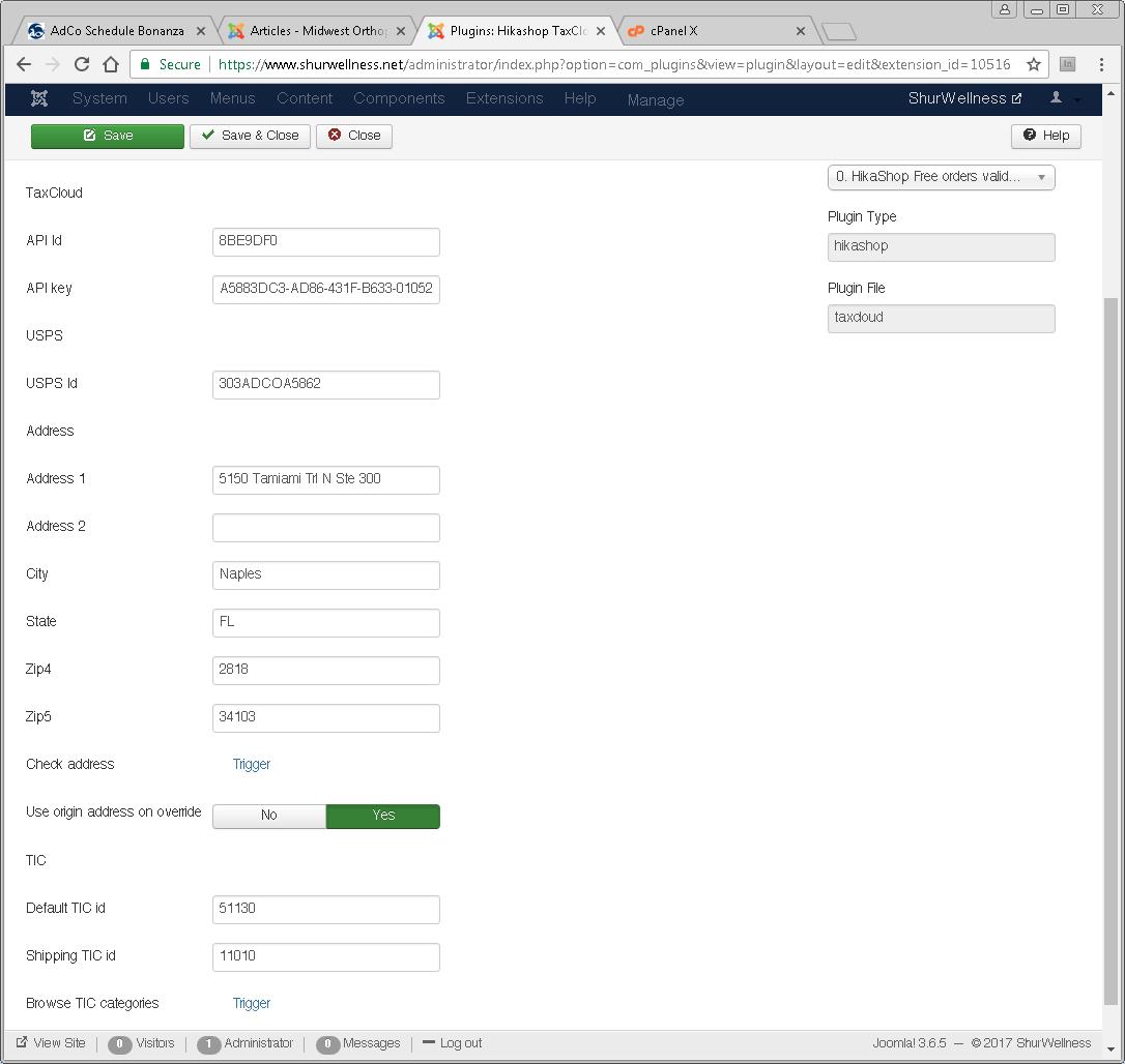

Could you provide a screenshot of the TaxCloud plugin settings ?
One of your order statuses settings ?
  • Posts: 11
9 years 6 months ago #260485
The same problem the original poster had: It keeps telling me that I haven't completed the test transaction even then though I've changed the order status to 'confirmed' and 'shipped' like a million times.
I'm using 3.0.0 and yes I used the setup documentation. Here is a screenshot of the TaxCloud plugin. Which order settings do you need?

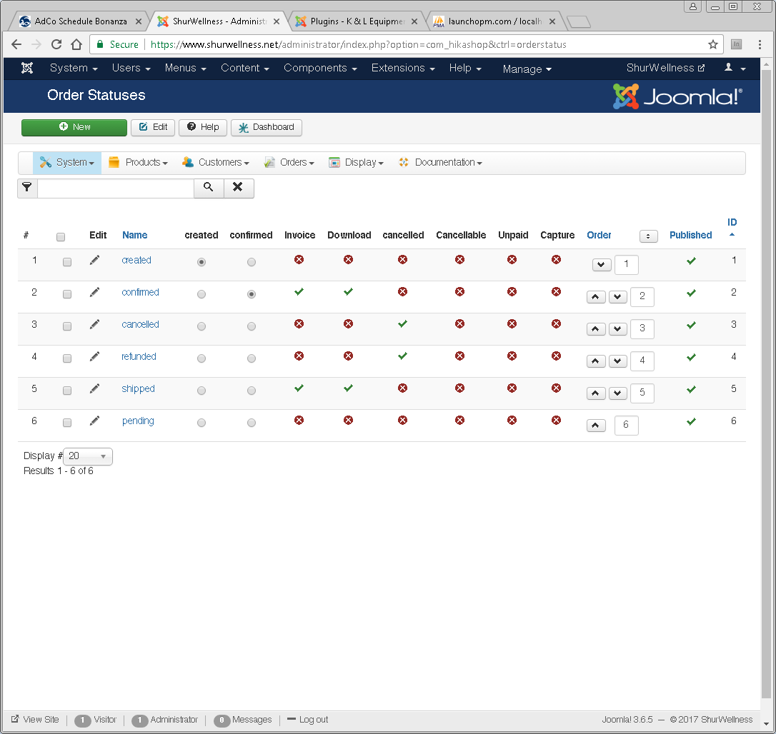

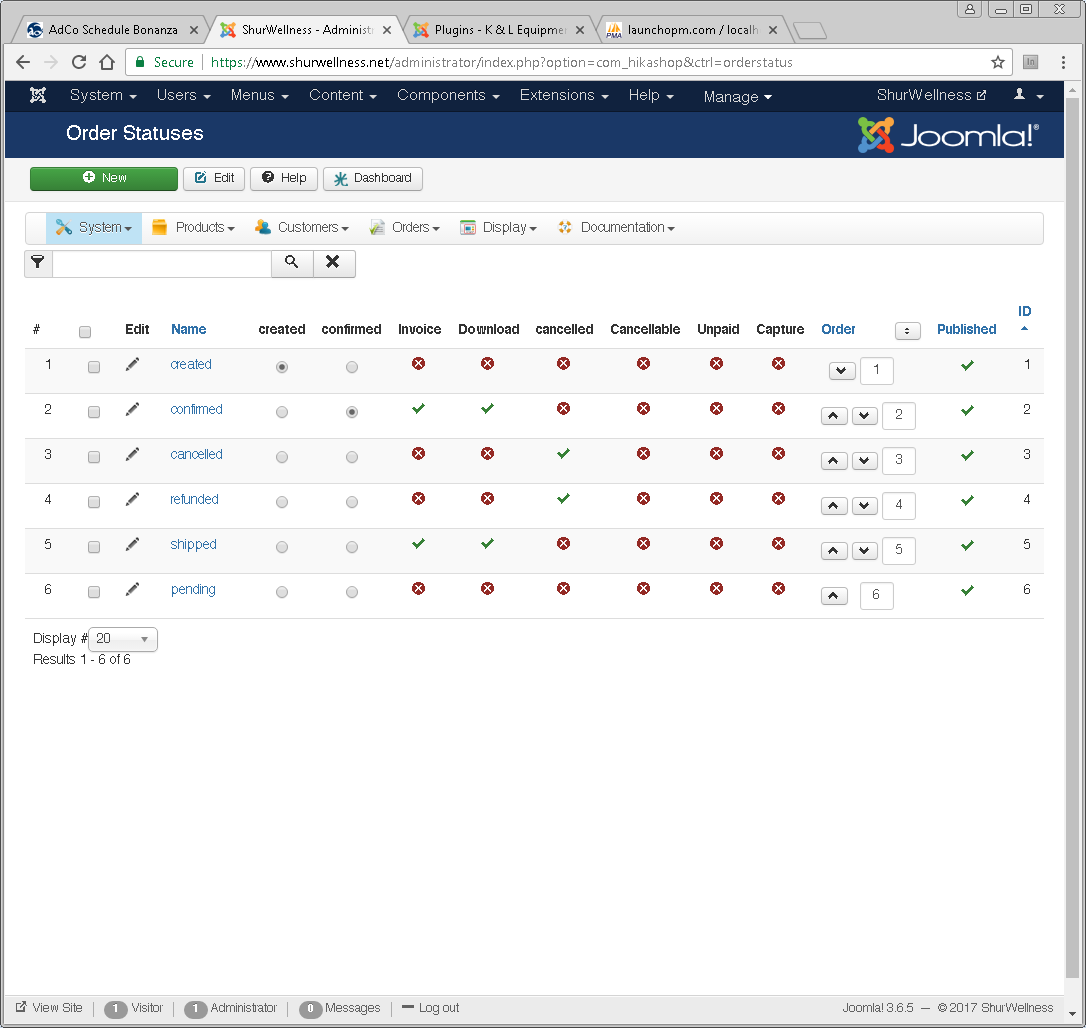

Could you also provide a screenshot of your order statuses in the menu System>Order statuses ?
  • Posts: 11
9 years 6 months ago #260597
Ok here it is:
  • Posts: 86042
  • Thank you received: 14174
9 years 6 months ago #260599
It seems alright.
