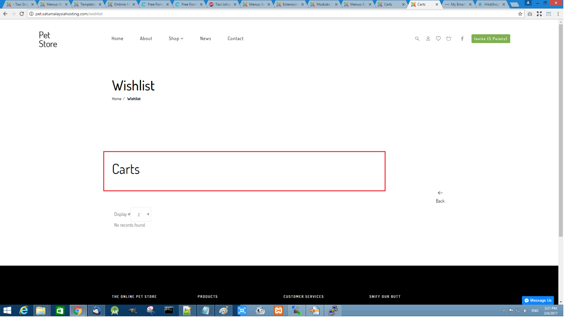

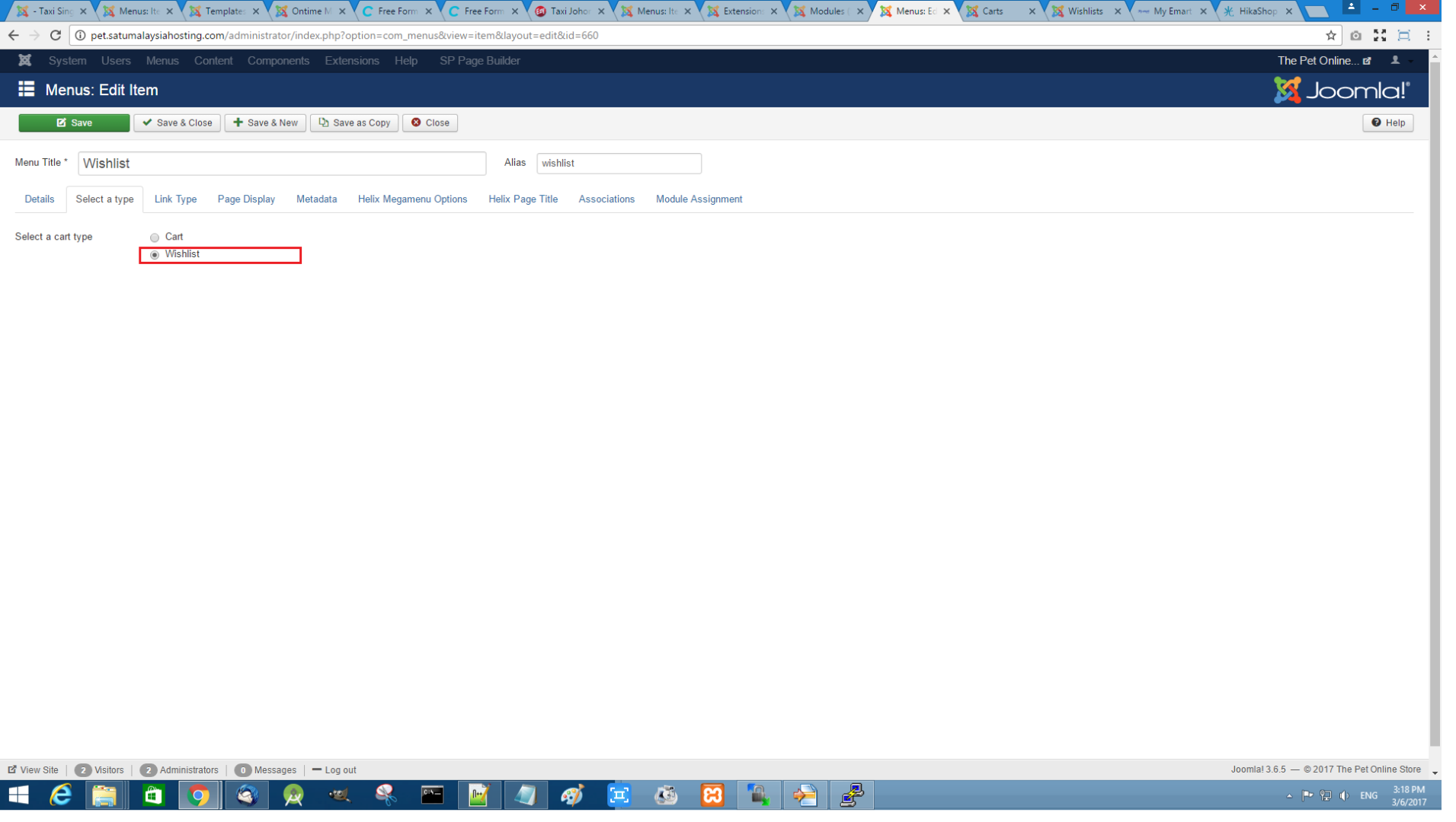

Dear Support

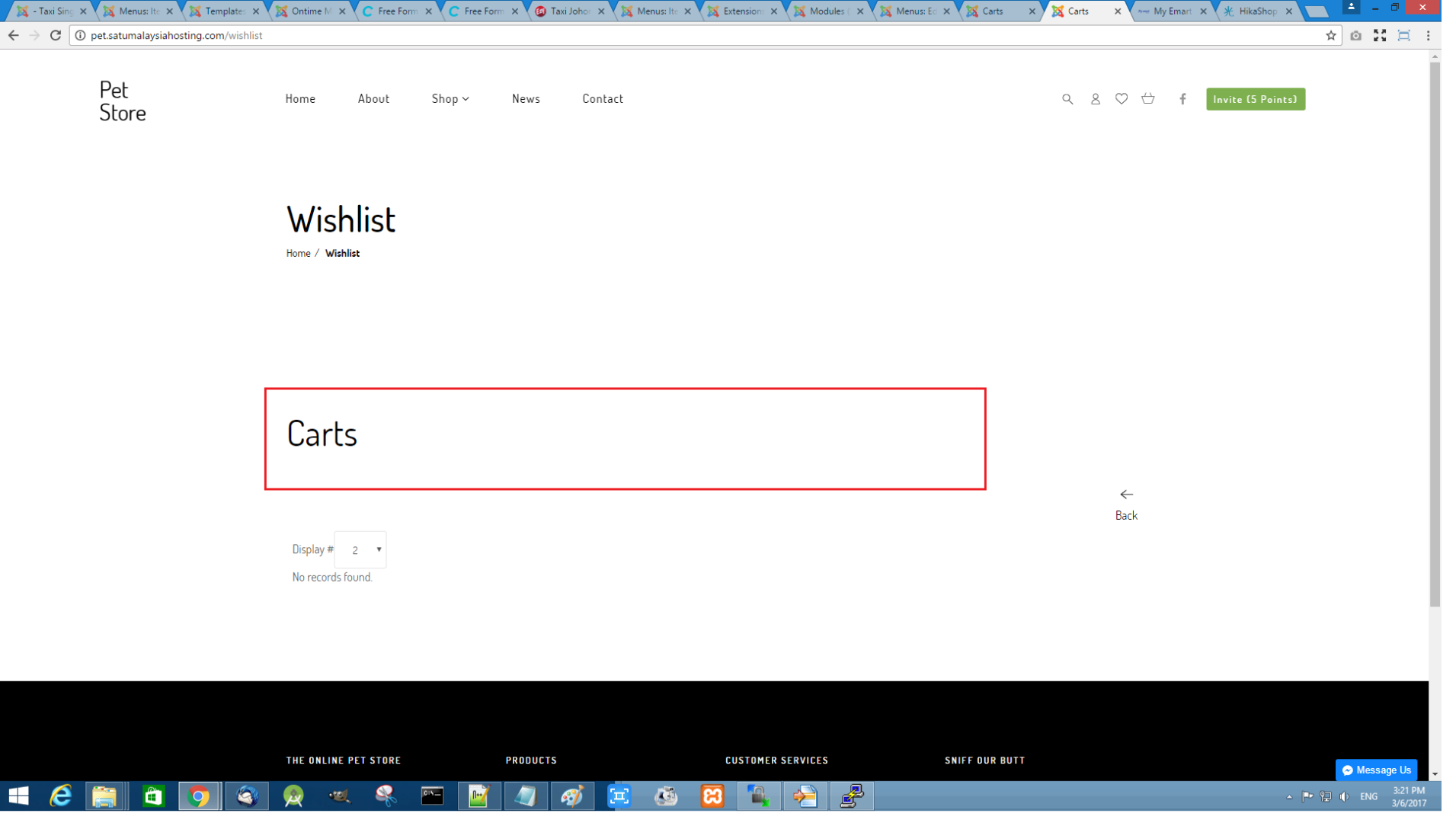

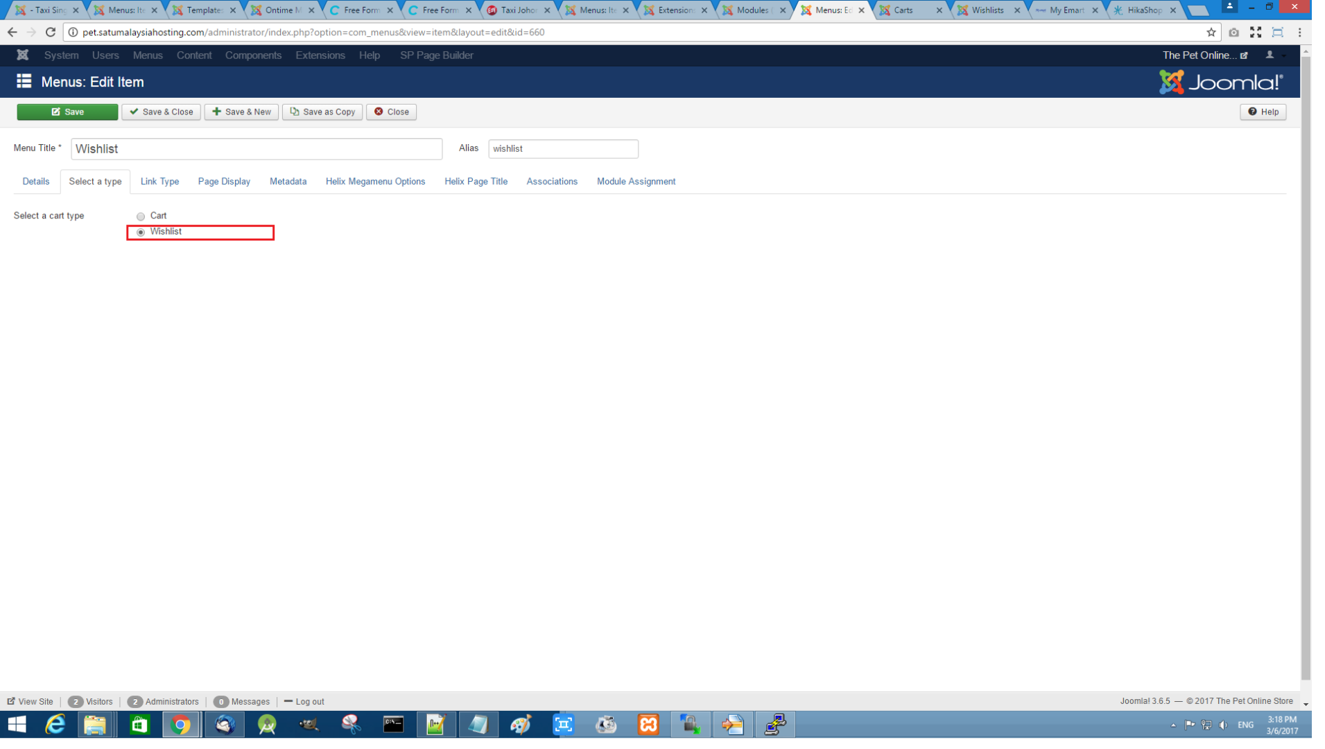

In cart listing menu, I select the type is wishlist, but in front end show is cart not a wishlist

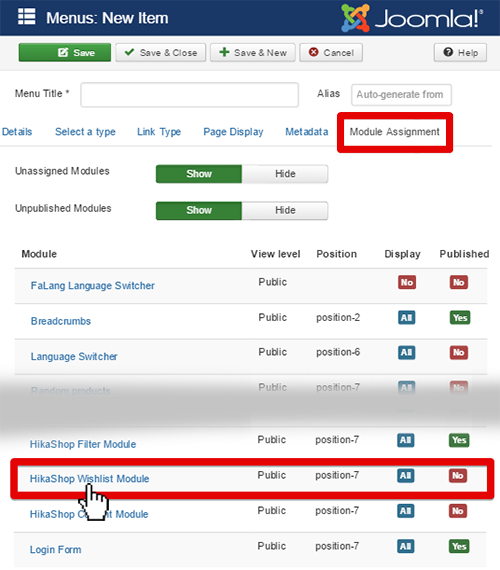

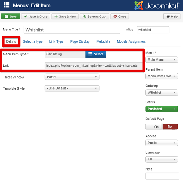

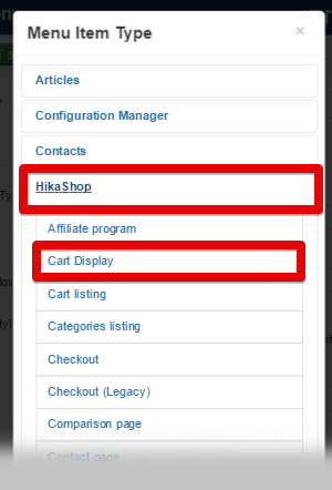

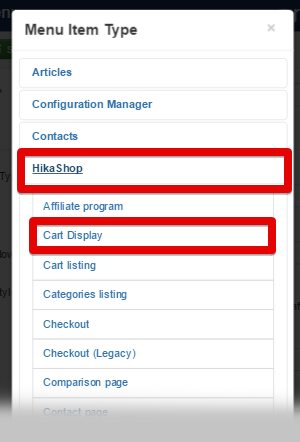

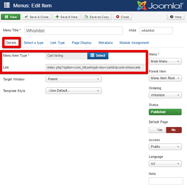

There is something missing I guess, let's check together step by step :
- Details tab page :
Select in Menu Item Type in HikaShop.

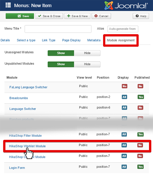

Then check the Module Assignment tab, select your HikaShop Whishlist Module
Hope this will help you to progress.

ok, working fine...thank you very much
