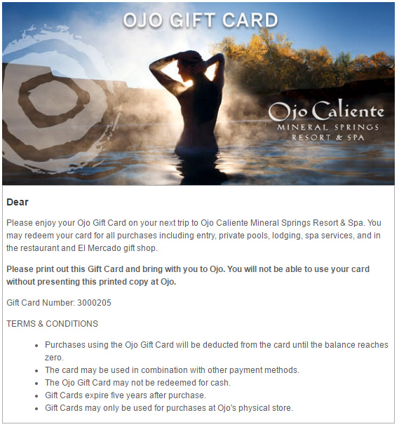

Is it possible to format the e-mail that the gift card recipient gets like this:
www.dropbox.com/s/cmmt54123unl2mt/giftcard1.pdf?dl=0
Basically the email has a header image (with no gift card data embedded in the image) and BELOW the image is text containing the gift card serial number, value, gift message, etc... as well as instructions on how to redeem it.
Is this possible and if so, how?

  • Posts: 52
10 years 7 months ago #226185
No, the store does not sell only gift cards. It sells mostly physical goods (clothing, artwork, etc...).
If you look at the PDF I linked to, you will see that I don't want to send a typical gift card image. All I
want to do is be able to customize the email that the recipient receives so that instead of having an
image where the gift card amount, name, etc... is actually ON the image, it is displayed BELOW the
image along with information on how to redeem the card, etc...

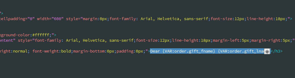

Can you please explain to me how I would go about including the following custom field name values in the PRELOAD as well as the HTML email for gift card recipients:
gift_fname
gift_lname
gift_email
gift_message
Also, how would I include the gift card amount?
In your previous replies you have instructed me to add it in PRELOAD and call it in the email itself, but I don't understand the code needed to do either. Can you please provide examples using the above mentioned custom fields?
Thanks!

  • Posts: 52
10 years 2 months ago #242576
Jerome,
I tried what you suggested and it did not work. Please see the attached screenshots.
Screenshot 1: the HTML code for the email incorporating the VAR code you recommended
Screenshot 2: the actual email where you can see that it did not work
As to how the gift certificate was set up, I followed the HikaSerial instructions for setting up a gift certificate and included price variants. Given that info, how do include the gift card amount in the recipient's email?
Many thanks!
  • Posts: 26381
10 years 2 months ago #242579
Please provide concrete details about your custom fields and the rest of your configuration.
Unfortunately, the information you gave do not provide any additional element to understand what you have done exactly ; it does not answer to the question I asked.
Also, like I wrote in my previous message
{VAR:order.gift_fname}
will display the raw content of the order custom field "gift_fname".
It means that the code is working if your custom field is right an order custom field.

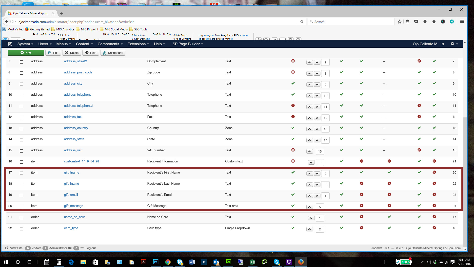

  • Posts: 52
10 years 2 months ago #242702
Jerome,
I am not sure what information you specifically need. As far as setting up the gift certificate w/ HikaSerial, I followed the instructions provided in documentation.
The custom fields I am trying to add are order fields. I have attached a screenshot of the custom fields list so you can see exactly how we have them set up.
Many thanks!
  • Posts: 26381
10 years 2 months ago #242704
The plugin "mail to custom field" can work with "order" custom field and "item" custom field.
Like I wrote several time in my previous messages ; the content I gave you where related to order custom field.
And as you can see in your screenshot, you have item custom field.
It means that the context is entirely different and if you do not provide specific and details information we won't be able to deduce them (because once again, the plugin can work with both).
I hope that I am clear enough on that part.
