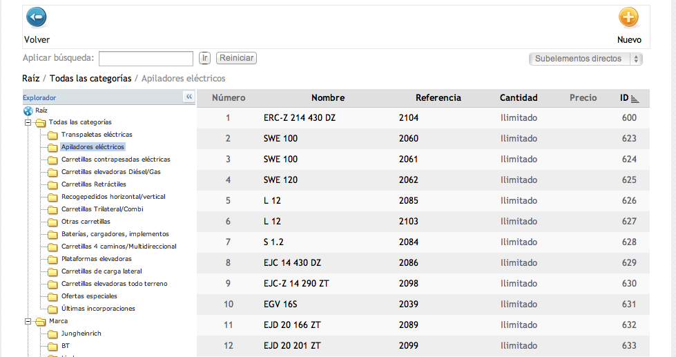

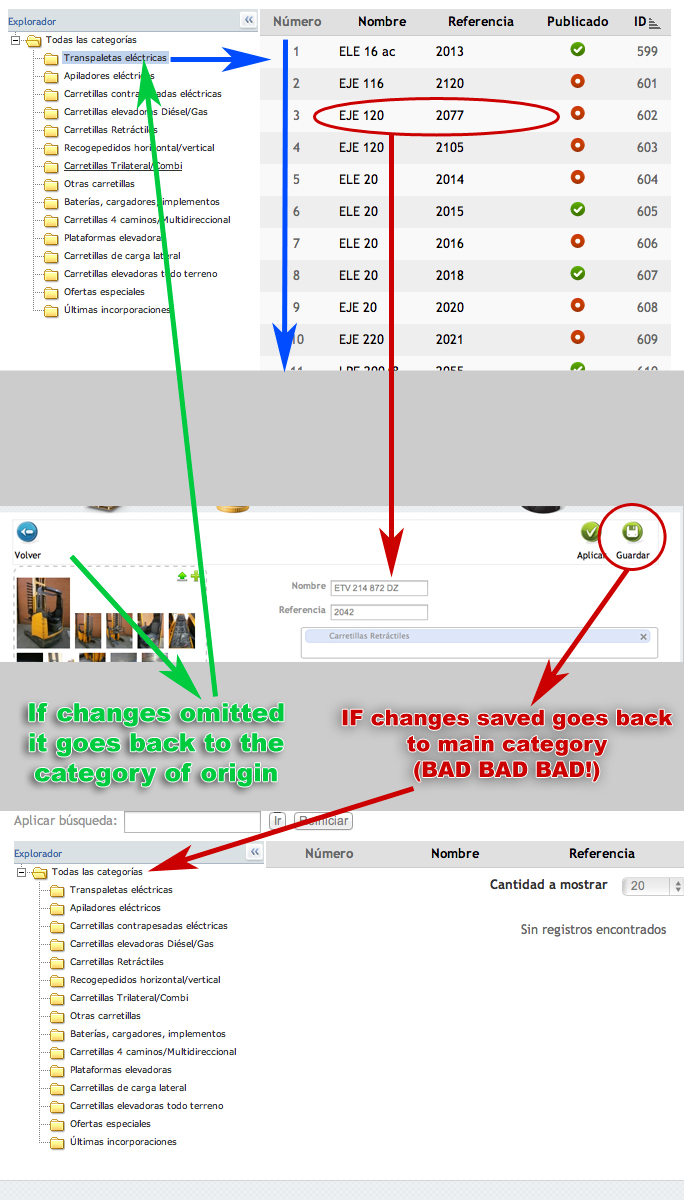

I need to fix an annoying behaviour of HikaMarket Product listing screen.
If I click a product of a subcategory for edit I get two different behaviours:
1. If I don't save contents and click the back button the listing stays in the subcategory I got on screen. THIS IS LOGICAL AND GOOD.
2. If I save changes the listing screen goes back to the main category which is WRONG WRONG WRONG because it prevent me to manage products on an organized manner.

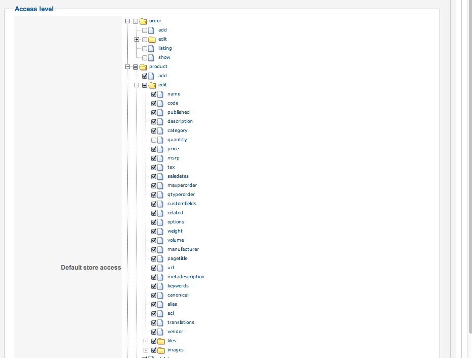

It is not about template overrides or nothing suggested in this thread. I THINK THIS CAN BE NAMED A BUG, and I hope so because I have spent almost 10 hours trying to fix it and find my mistake.
The column actions gets rendered only when all fields en HikaMarket->Main->Access Level -> Product -> Edit ARE ENABLEd.
If I disable a single field I loose the actions column!
This took me several reinstalls and experiments to figure it out as it has (as far as I know) any logical connection.
Please I NEED A fix as soon as possible for this.
UPDATE: Doesn't matter what field I uncheck, all of them remove the Actions Columns in the listing view.

13 years 2 months ago #108634
After updating HikaMarket and HikaShop to their latest stable versions the problem persists.
If I save a product in HikaMarket the listing page comes back to the Main Category and doesn't stay in the last selected category, let's say, where my product was coming from.
This is inconvenient and unrealistic for the daily work as it doesn't allow to make serial review of you catalog.
Please try to fix it!
Thank you.
13 years 2 months ago #108671
I can't reproduce your problem in my local website and I don't know why.
But I finally reproduced it in the demo website. So I found a patch for it.
Replace in the file "components/com_hikamarket/controllers/product.php":
                        if(!empty($cancel_action) && !empty($product_id)) {
                                switch($cancel_action) {
                                        case 'product':
                                                $app->redirect( hikamarket::completeLink('shop.product&task=show&cid='.$product_id, false, true) );
                                                break;
                        return $this->listing();
By:
                                        case 'product':
                                                break;
                        JRequest::setVar('cid', null);
Now I know what is the real problem, I will see to make a nicer patch for the next package.
But with this, it will work.
