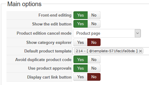

I have 'Use Product Approvals' set to Yes:
regards

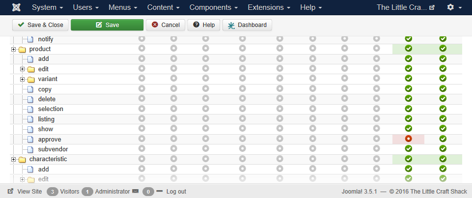

Please check the ACL of your vendor ; the setting "use product approvals" is one part of the system.
Because if a vendor have the right "product/approve" ; his products will be directly approved.
(and for users of the main vendor ; it also allow them to approve products of other vendors).
Here code from the HikaMarket product class :
	if($config->get('product_approval', 0) && !hikamarket::acl('product/approve'))
		$product->product_type = 'waiting_approval';

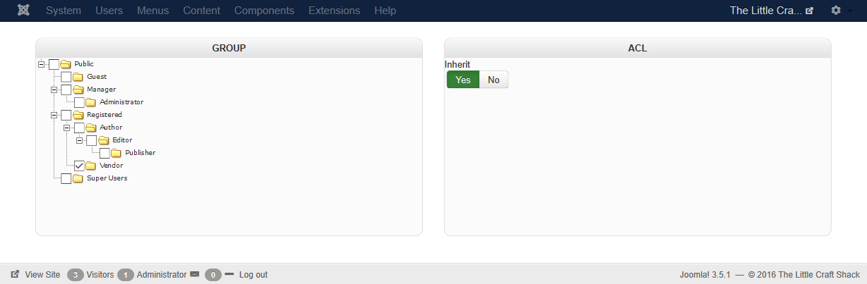

The vendor has global ACL set:
and in the global ACL, Product Approve is disabled:
I also tried setting the non-global vendor acl settings with the same results.

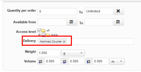

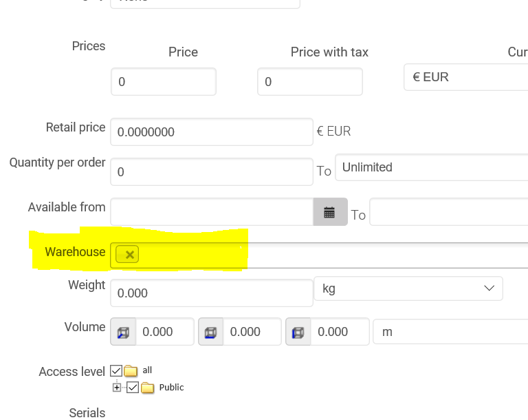

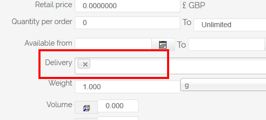

Another issue that I have just noticed is that the Warehouse setting for the product is not displaying correctly if viewed from the vendor control panel. (I have renamed 'Warehouse' to 'Despatch'):
Back end product edit:
Vendor admin view of the product:

Thanks for the screenshots ; I'll try to reproduce your issue in my local website using the same configuration.
I fixed the warehouse namebox with the same fixe which has been added into HikaShop.
That patch will be include in the next release (and I'll update the demo website during the afternoon with the latest dev package).

10 years 2 months ago #238511

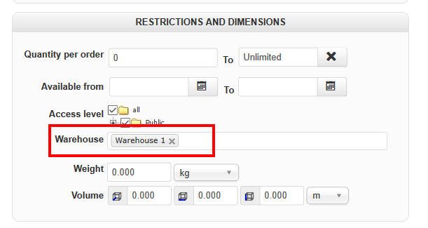

I have tested the problem with the warehouse not being displayed on the vendor's view of the product and can reproduce it on the demo site:
I created a product from the vendor control panel called 'Another product approval test' with a warehouse called 'Warehouse 1'
Product viewed from the back-end admin:
The warehouse is not displayed when the product is viewed from the vendor's control panel:

The part of the warehouse namebox is closed. I told you that the patch was made and it has been propagated in the demo website this afternoon (like I wrote yesterday night).
  • Posts: 306
  • Thank you received: 42
  • Hikamarket Multivendor Hikaserial Standard Hikashop Business
10 years 2 months ago #238600
I have just tested the warehouse problem on the demo site and it appears to be working OK now. Has this fix been applied to the download package?
